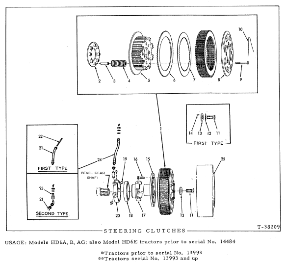

Anyone experience replacing the grease line that runs from the throwout bearing to the steering clutch housing cover on an HD6?
If you did, how did you do it? I've visited three places in the largest town within an hour of me and they all three did the hmm/giggle/chuckle for a few minutes before telling me they can't help. Both my lines are completely rotten, both ends either broken off or hanging by a sliver of metal.
Parts information below:

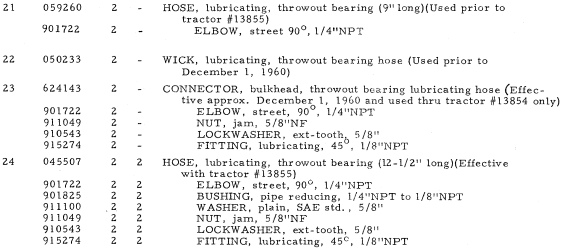

045507 Hose, lubricating, throwout bearing

The first type was a line  with a wick  and recieved the oil from bevel gear case and the second type is a  greace gun line instaled on the bigger inspection stering cluch cover

A grease gun hose works as the threads are the same size or can be fit with a reducing fitting , 1/8 pipe thread , drilling a hole in cover of housing to bring hose or fitting to access point .

Grease gun hose works , if you have the felt wick to ring gear case be sure to put plug in that hole . otherwise you will have oil in clutch housing if left open
