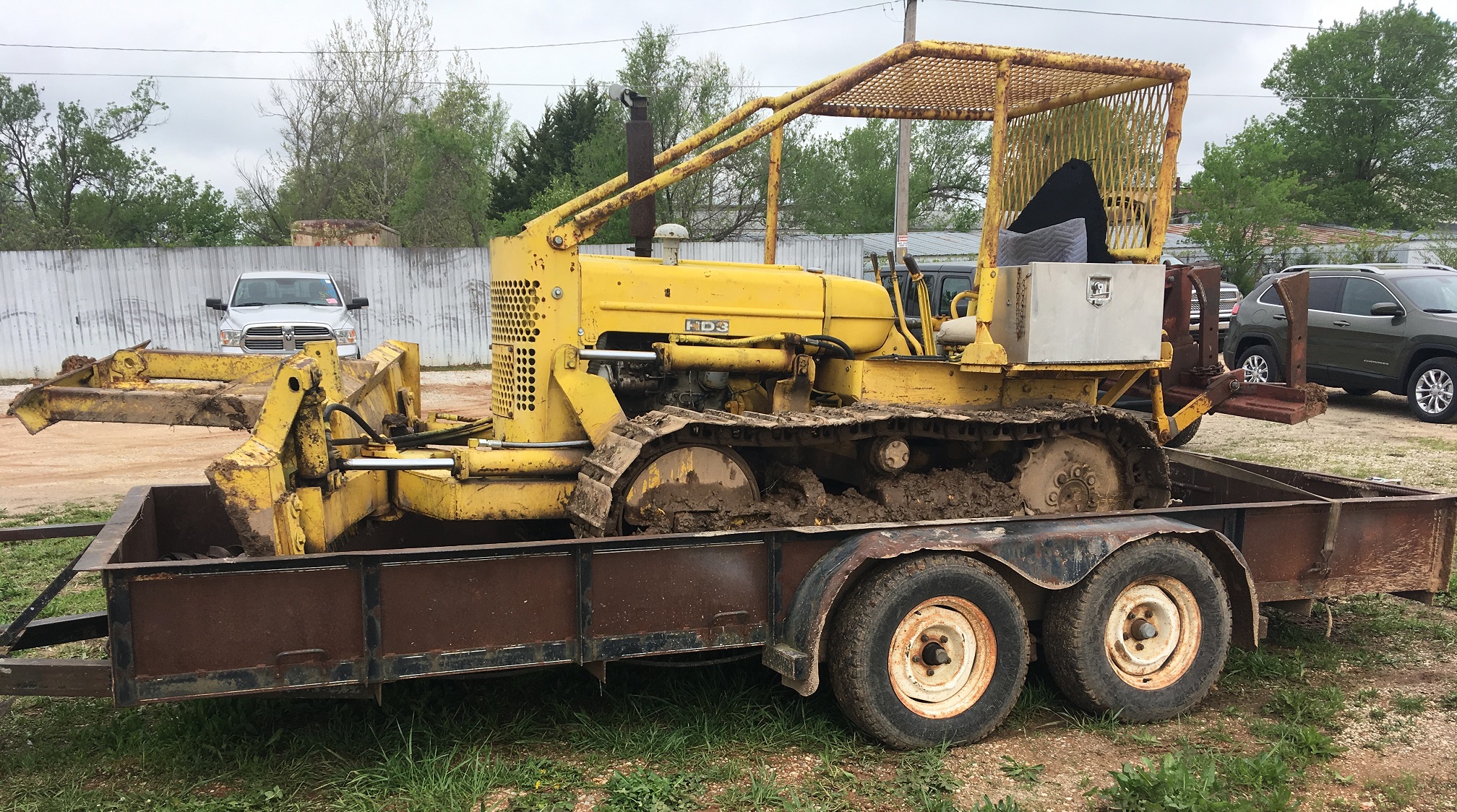

Amazing that that trailer can hold that much weight!Wink
looks like a 2 stroke GM, nice find, and welcome to the site...

Should be a D-175 diesel with shuttle clutch. Ours is D9771-1968.
Curt Anderson
HD3, HD5B, HD6AG,HD6B dozer, I-400,615, 616,620,720,ACP25 lift truck, 1956 D Grader, AC 540 loader, AC #84 plow, Simplicity tractors, Agco MT225, Agco 2025,
Jim.ME View Drop Down
Joined: 19 Nov 2016
Location: Maine
Points: 1012
Post Options Post Options   Thanks (0) Thanks(0)   Quote Jim.ME Quote  Post ReplyReply Direct Link To This Post Posted: 25 Jun 2018 at 4:53am
2nd on the D-175, from the injection pump and filter visible in the first photo, doesn't look like a GM/Detroit 2 stroke.

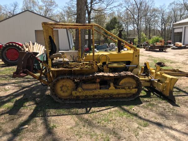

Is that a 3 point hitch on the back of the first picture?
Post Options Post Options   Thanks (1) Thanks(1)   Quote shameless dude Quote  Post ReplyReply Direct Link To This Post Posted: 03 Dec 2018 at 12:16am
i'm think'in….you are gonna have some fun! that's a good looker!
Yes it is
check out the video a couple posts up

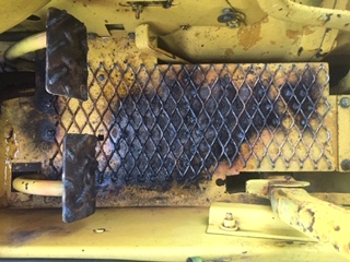

Caught on FIRE!!!!
Yep, doing some welding.  I placed some expanded metal on the floor boards and ran a bead on the pedal surfaces for traction as the sheet metal was too slick when wet.
I scrumpled tin foil in all the cracks leading down to the belly pan as I have spilled a couple gallons of diesel down there when doing my tank electrolysis and filter replacement so I was a bit on edge about it.  I got too close to a hydraulic line it flamed up.
I was 8 feet from a water hose and had it hooked up in a few seconds and I know not to use water on a greasy fire but what else I got so splash and out it went.  My heart was pounding and I cussed myself good.  I'll hold off on the other floor board until I get a fire extinguisher.
