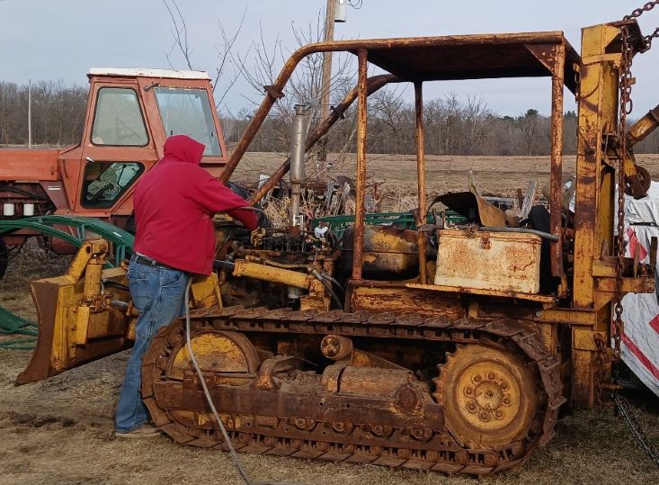

Got a salvage yard crawler with a bad engine. No injection system now and engine turns stiff. Anyone tried to put another engine into a HD3?
What would be a good transplant engine to set in it if able to do so?
 Or does someone have an old Allis-Chalmers diesel 175 cube engine laying around that was taken out of HD3/ D15D that would be usable for donor parts?
 Here is a pic of crawler, blowing critter nests out of valve train area cuzz valve cover was sitting on the two studs.
 On market place, seen a Simpson SJ436E engine says 46 kw, and a Perkins 404...Also a 4 cylinder Mercedes OM616 2.4L Would that make the crawler run like a Cadillac?
  I might have to go hunt down a D15 160 cube engine and put in, probably be the easiest avenue to go.
   Sure would like to keep it diesel.
        Thanks, JC

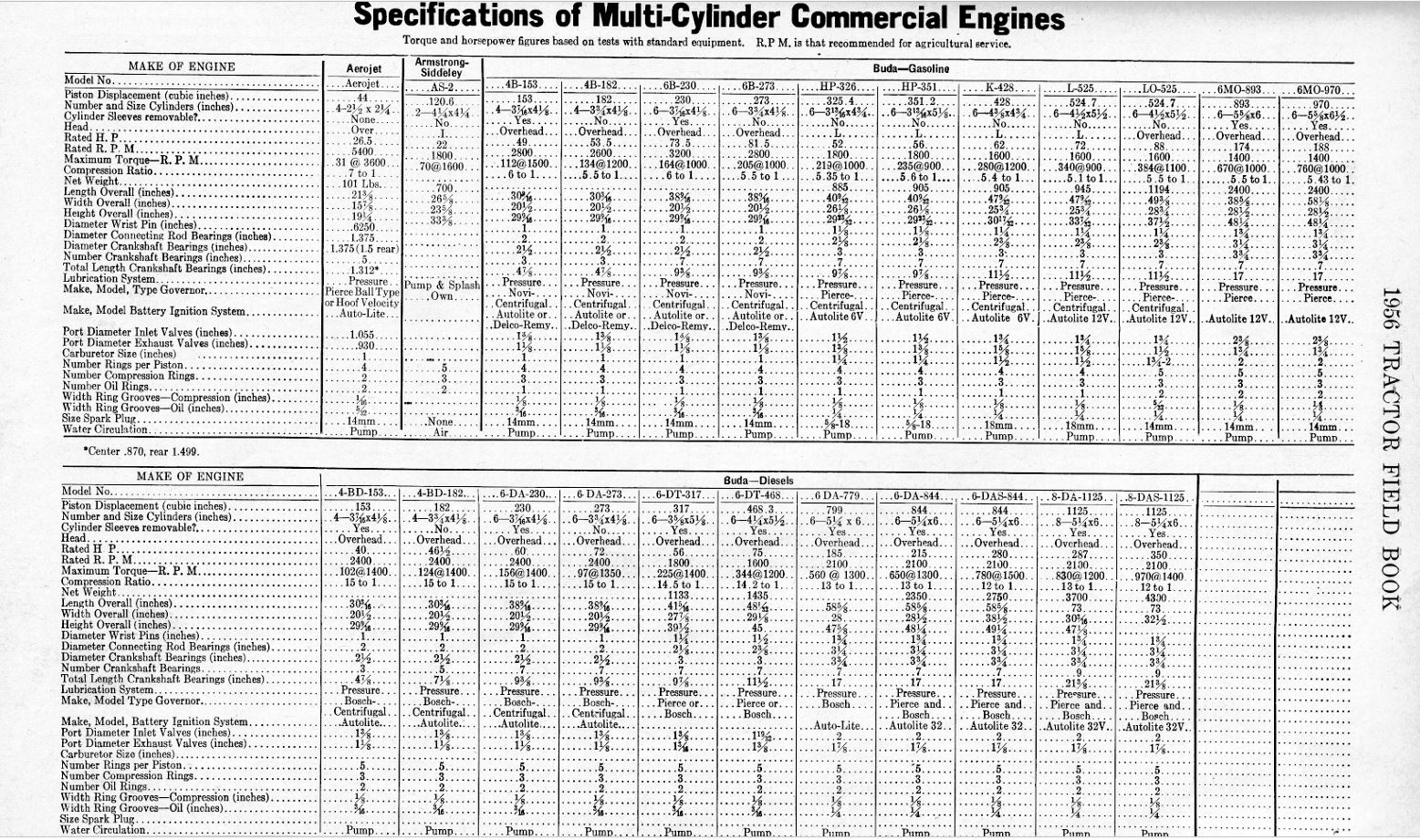

Post Options Post Options   Thanks (0) Thanks(0)   Quote JC-WI Quote  Post ReplyReply Direct Link To This Post Posted: 03 Apr 2026 at 12:00pm
How much HP can a little HD3 handle?
 The Buda D175 was  32 pto HP.  Couldn't seem to find BHP on it
I sure wouldn't want to go beyond that D2200's range 50- hp
Looking in a 1956  'The Tractor Field Book',  under multi cylinder commercial engines section, They listed Buda having 11 different gasoline power units and same number of diesel units  from the 4B-153 gas / 4-BD-153 diesel to the 6MO-970 gas / 8-DAS-1125 diesel.
 Nothing for Allis there, but Allis-Chalmers  were listed under Tractor Engine Power Units specifications and only gas models.  They were powering their construction equipment with Detroit Diesels prior acquisition of Buda.
Here's a scanned image of the Buda specs from 1956.
