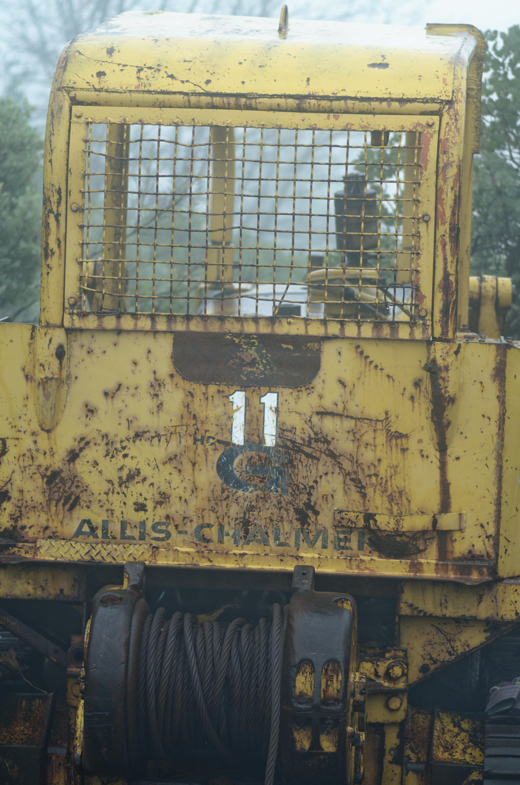

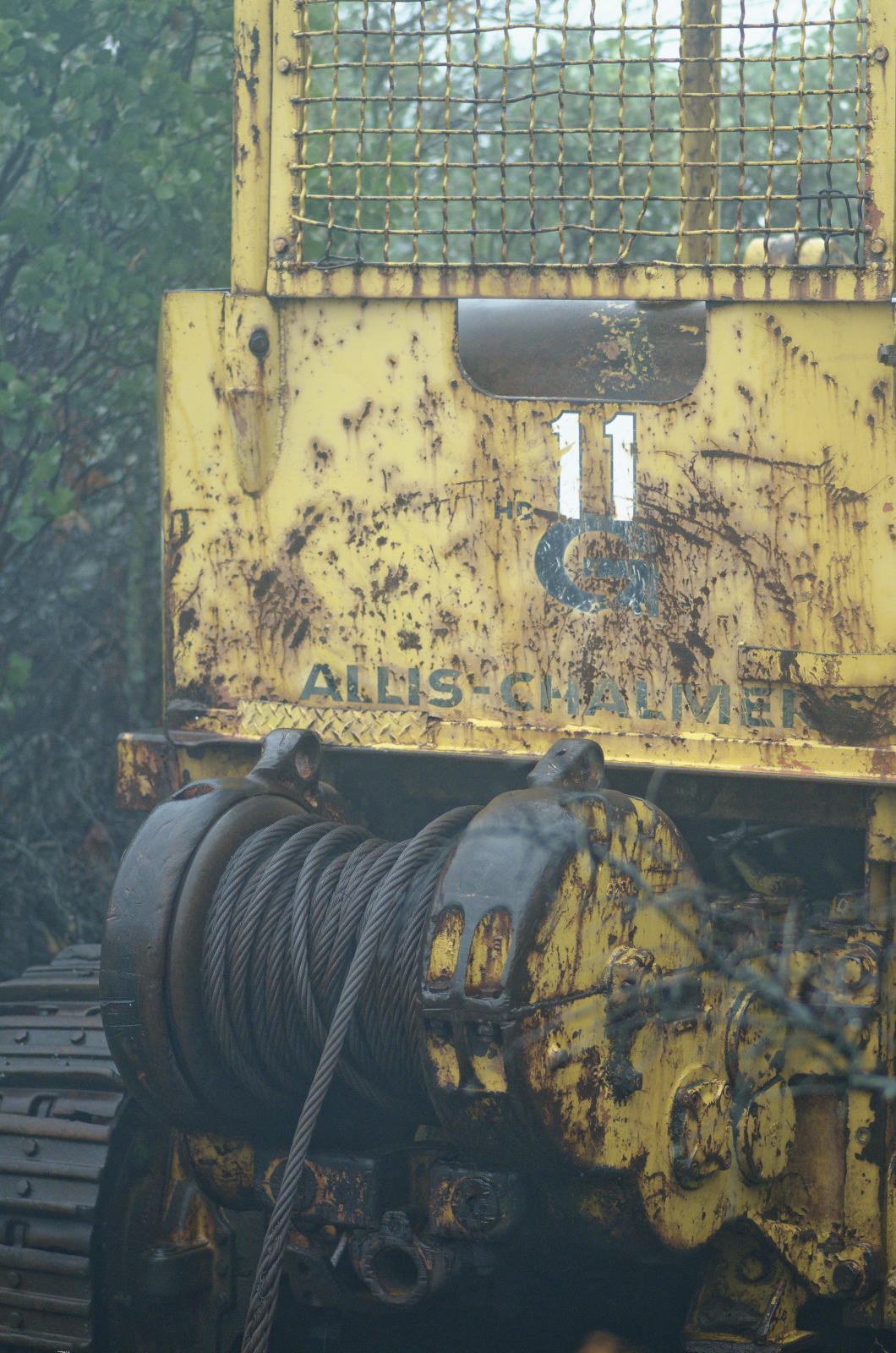

I am wondering if you guys could help me out with this HD11G / 1502? So far this is the only numbers I can find on a plate that's riveted to the gauge panel on the left side.
This is what I know about it. In 92 it went through a really big fire and has been sitting ever since. From what I can tell the plastic covers on the gauge face seem to be melted but ALL of the rubber lines/belts are in tact. So I don't think any of it was fire damaged expect the gauge faces and the name plates are a bit melted. It does have log forks and a Carco winch attached. There is a bucket nearby which I was told was for the crawler.
This crawler came with the property we bought 2 years ago. I have been working a trail since we have been here to re-access the back of the property with a vehicle. So I am hoping this spring I can start working on this and see if it still runs.

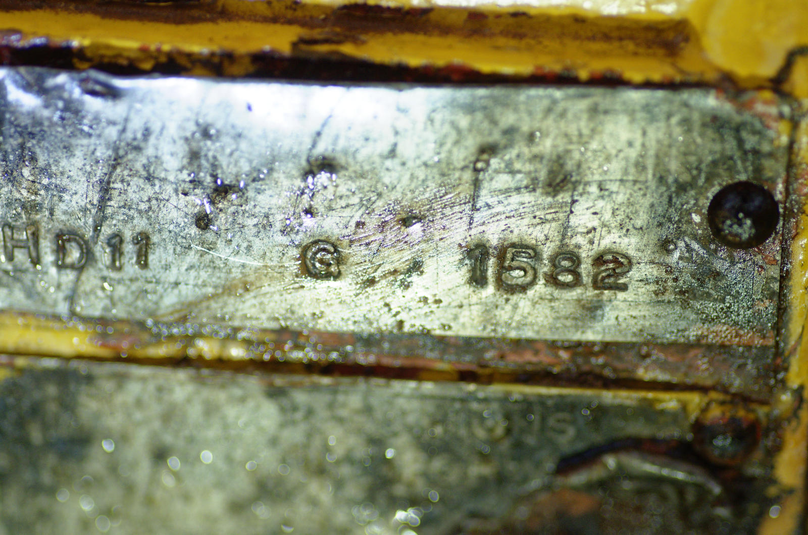

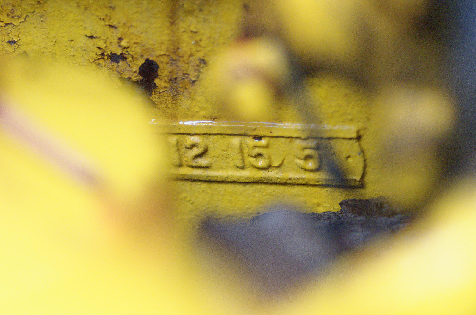

On the right rear final drive housing below the fuel tank will be the stamped s/n. Will start off HD 11-.

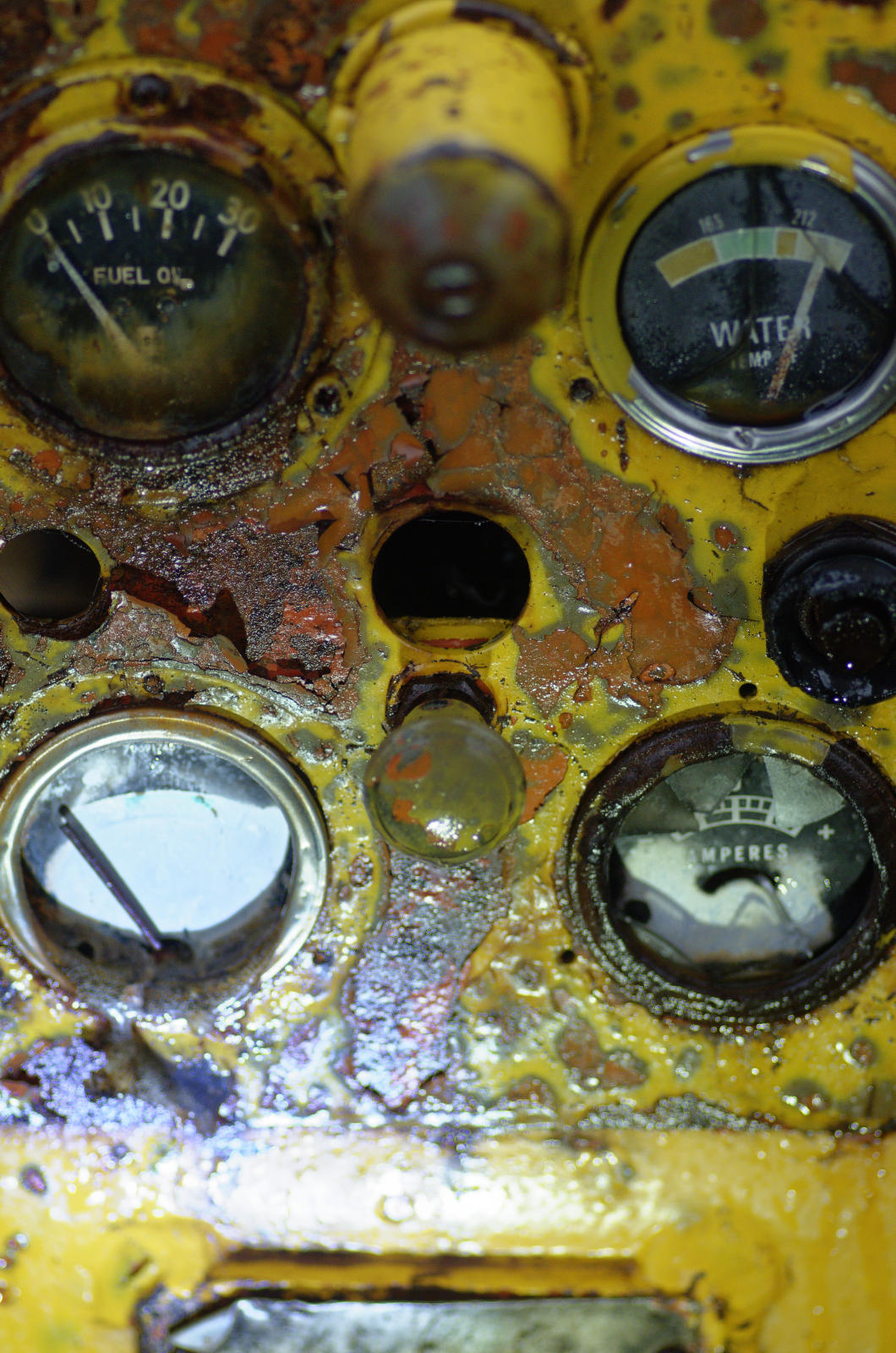

The fire appears to me to have only damaged the electrical, seat, batteries are gone/missing, some paint torched off in the cab and the knobs for the levers.Best I can tell right now are all the hydraulics, radiator hoses, fuel lines and belts are not even melted. The cables for the winch look intact. There is also still fuel in the tank.

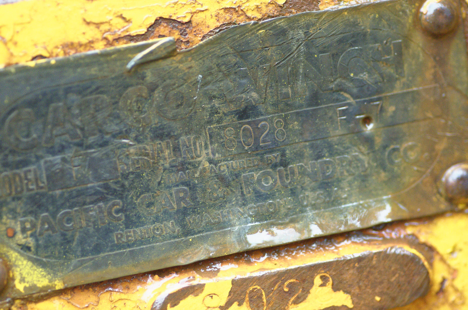

Also I went out during a break in rain. I don't see any numbers at the moment back there. But I did take some photo's. My camera lens is a bit to long but hopefully it will shed some light on what I have. I'll post them in a bit.

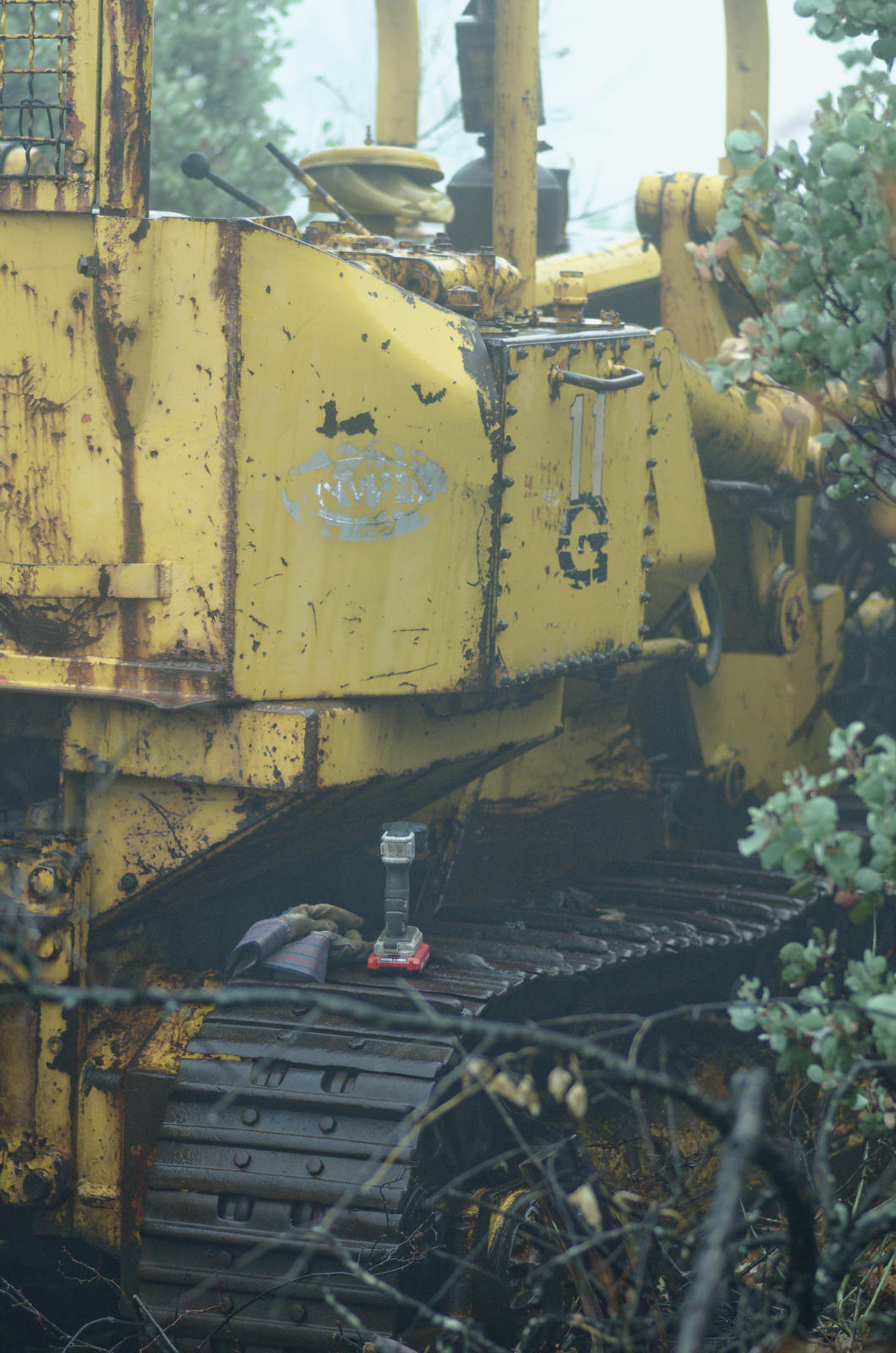

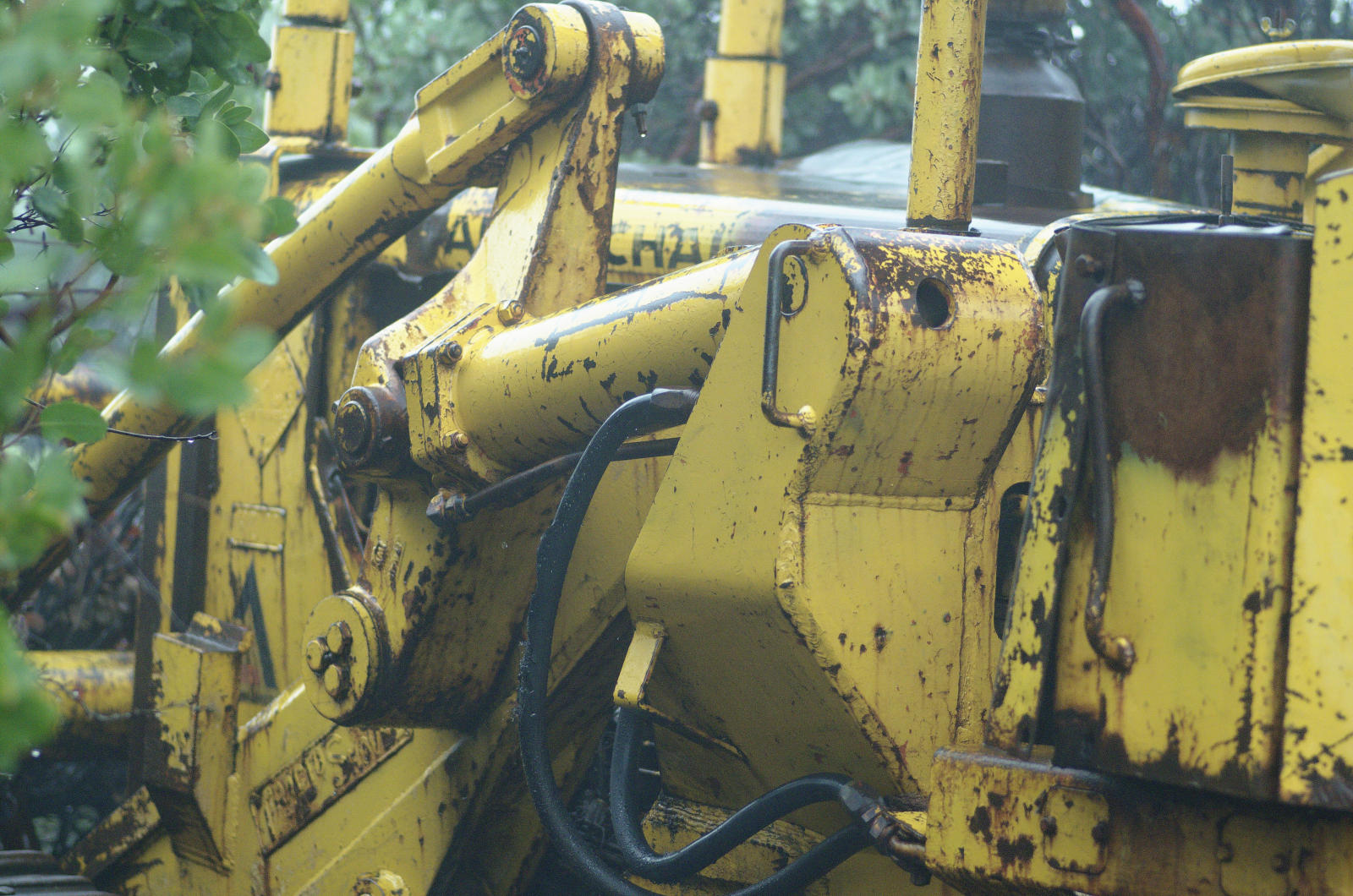

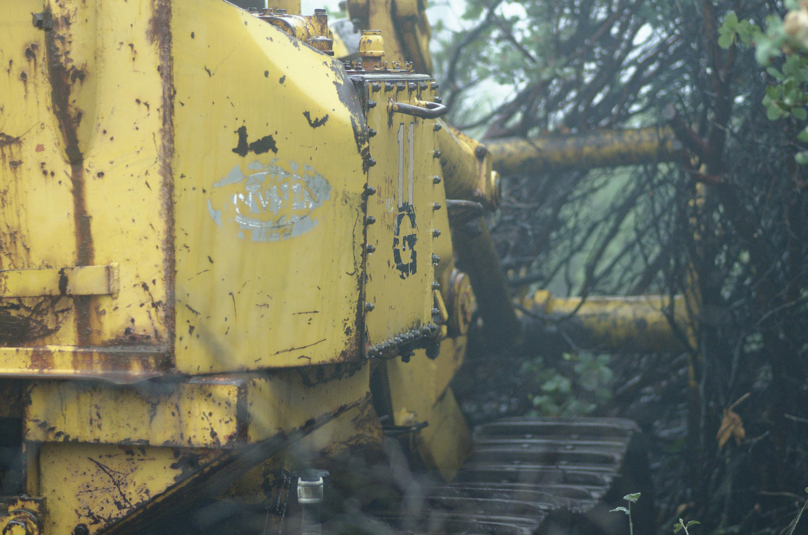

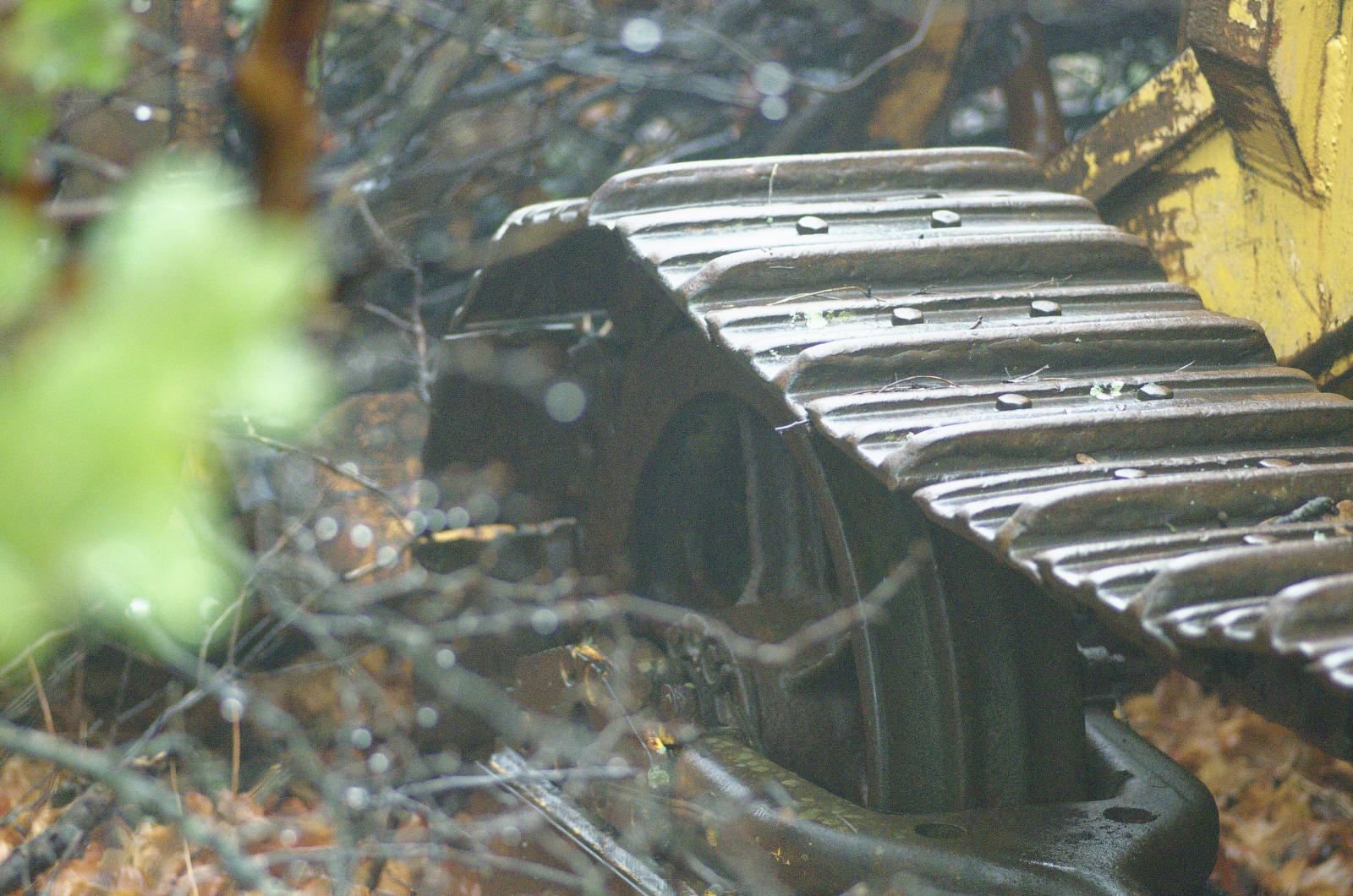

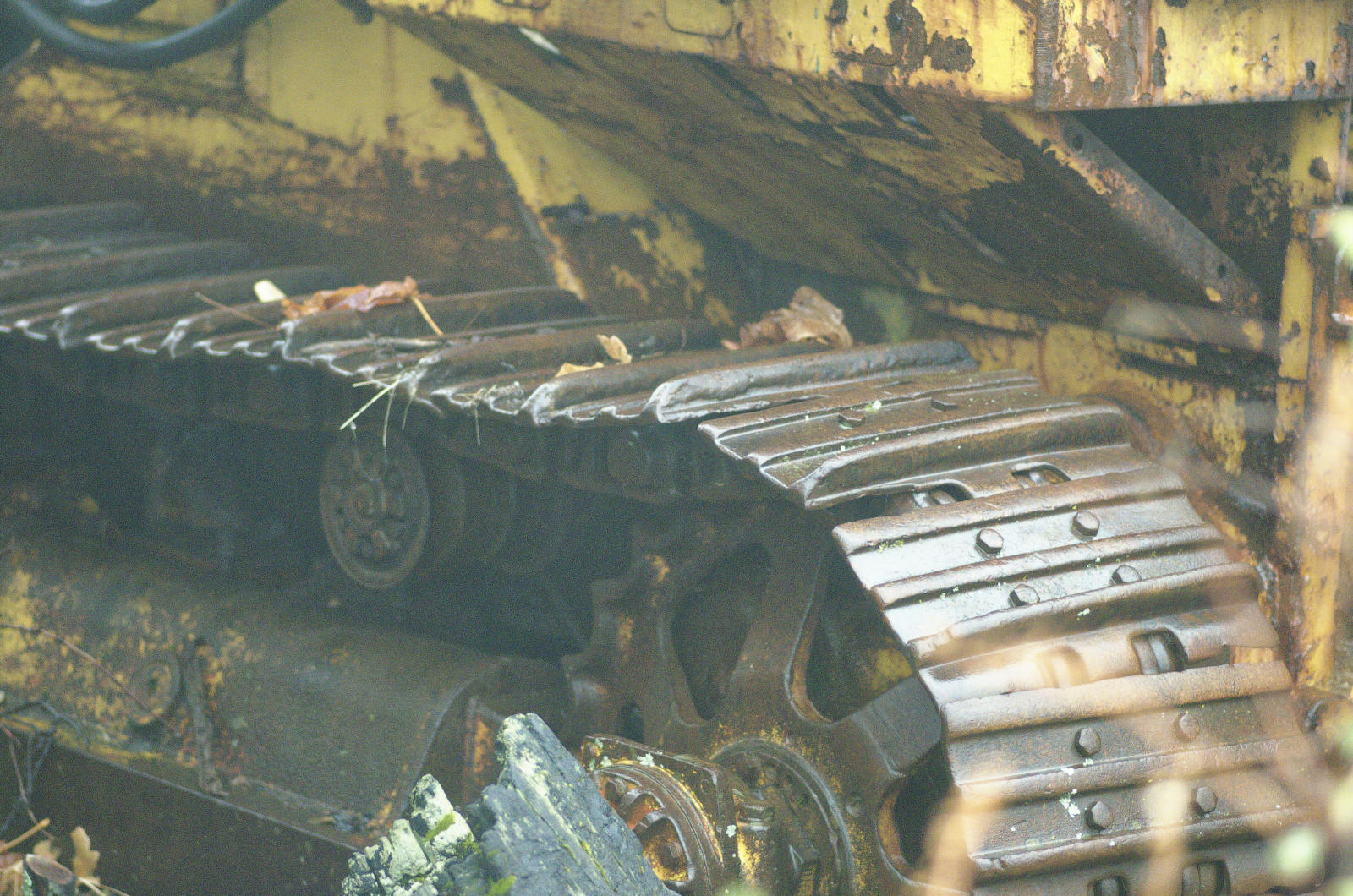

Get some better pictures of the undercarriage, like the individual links, in the track chain, and the individual teeth on the rear sprockets.  UC is the most expensive component, in a crawler, and often the limiting factor.  With better pictures, those here can tell you what the wear there looks like. Before spending a nickel, on anything, I would also check to see that there's not a cracked block, and check all fluids.  If something is empty, look around even more for the cause...Wink

Cool find!  LH track is on backwards... surprising how many crawlers have the tracks on backwards if you look!
Depending on what the rain is doing tomorrow I'll try and get some close pics of the tracks. At least the parts I can see, if not it won't be until friday. The right rear sprocket has been welded on all the spokes. I am sure many things will need to be replaced.
Every thing I have found on this property has been well used and needs some tlc. Mostly if it runs and can move on it's own I would be super happy.
If I can find out what year it is would be a huge help for me to start sourcing parts for worst case scenario
I would have never noticed lol doesn't surprise me at all though. The original owners seem to have done alot of odd ball things. Had great ideas but mostly just poorly executed.

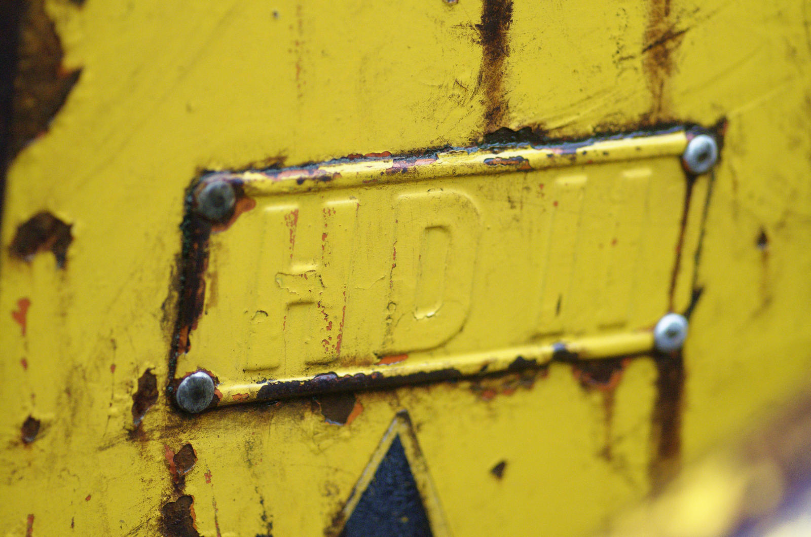

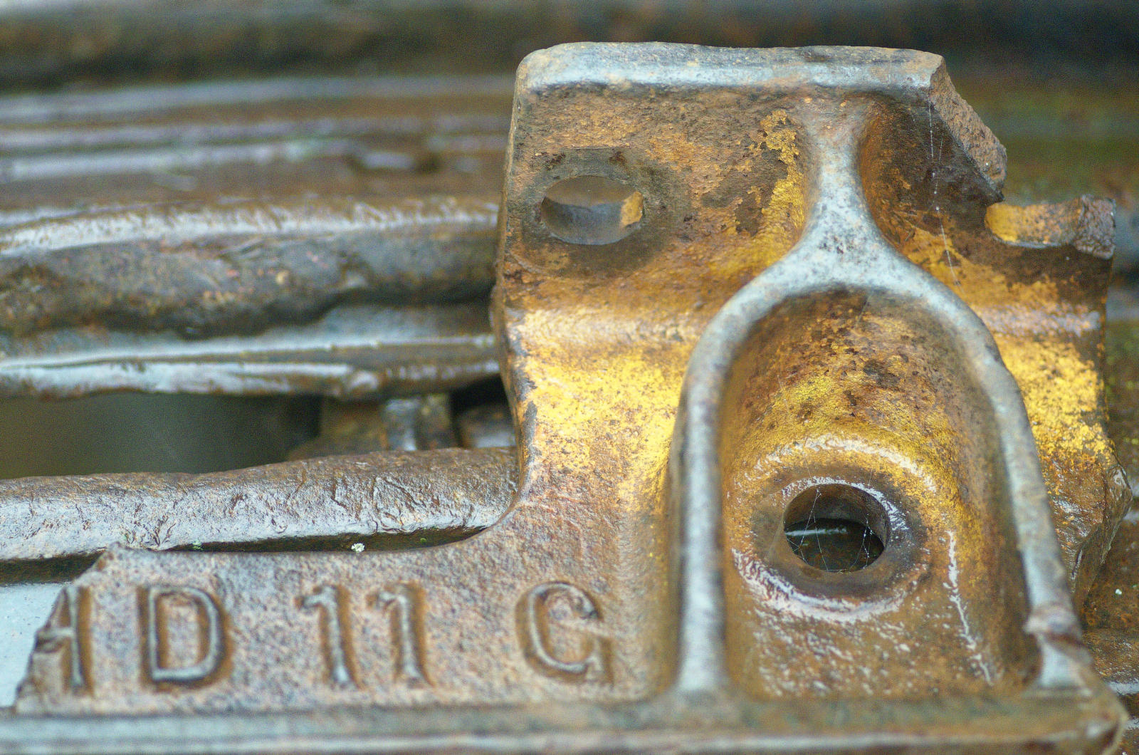

Ronnie, Looks like a good project...serial number indicates a 1957 year model. Every one that has chimed in so far has good advice. One thing we would want to caution you about...when you get closer..is being careful when you try to turn it over. Can't tell by the pictures..but I'm sure it would still have the original style Lanova engine. The fuel pump could seize up just like an engine...and of course by forcing the engine to turn over..not knowing if the fuel pump is stuck or not..you can do enough damage to the fuel pump to render the whole project almost useless. You're not there yet..we'll walk you through it.

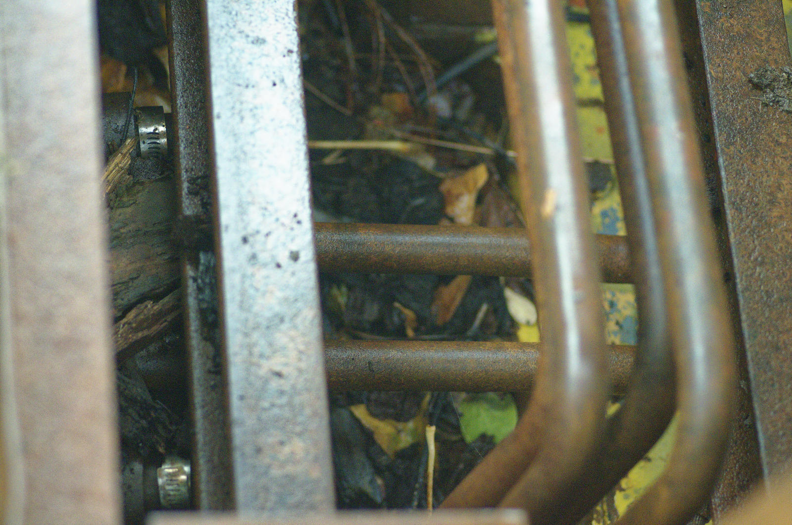

I don't remember seeing anything up front except the grill and radiator stuff, so when you mention hydraulics up front are you talking about the arms and cylinders for the bucket or is there more to it that I can't see yet?
