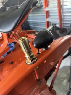

Finally installed the original tail light. I looks awesome and works well with the push pull light switch that we put together last summer.

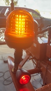

I have wanted to install an Emergency rotating strobe light for road travel. There was already an extra hole in the fender, in front of original tail light. Thus, I drilled that out and put on the bracket for a rotating strobe light.. Can simply slip the light on or off the bracket as needed.
My goal is to make sure I am noticeable, when on the road, to iPhone distracted drivers!!!

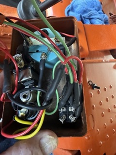

Finally, opened up the “key and switch box” and moved the "Magneto ground wire" to the 12V toggle contact to supply power to the distributor that Steve at B&B sent.
Now when the key switch is on and the toggle is switched on, the distributor coil will be powered.

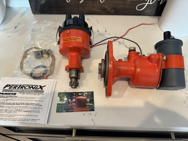

Drive unit and distributor arrived last evening. Looks spectacular and excited to install this weekend. Thanks Steve!
I marked the exact spot the rotor was pointing before taking off the Magneto. With firing order of 1,2,4,3, the magneto rotor was pointing directly to the cylinder # 3 cap terminal. Hope it is an easy install without needing to find #1 TDC.

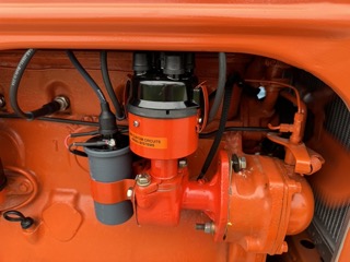

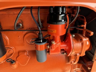

Installed the new distributor and drive today. Was super easy and had no problems.

After adjusting the timing she ran better than ever. Excited to she what happens when we put little orange to work tomorrow.
This is the best the engine has ran and without hesitancy as I stepped up the RPM and then back down.

Glad I have a 6 terminal ON-ON toggle switch!!!

I did rewire the toggle switch such that the power to the coil can be killed. Worked well. I also lifted out the distributor and set the rotor back by two gear teeth, just to have the distributor cap line up a bit better and not tug on the spark plug wires.
Added wire protector and "shrink wrap" to the terminal ends.
