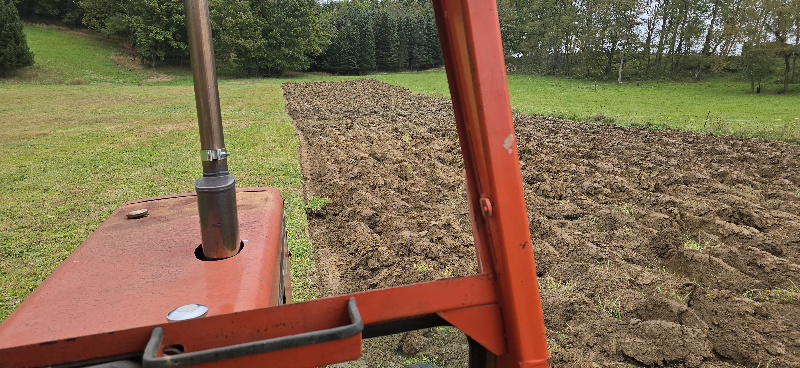

I just finished plowing a few acres with a 185 and JD 4 bottom semi mount plows. The plows could use some new shears but they operate as they are.
My complaint is the plows, plow shallow on a crest and deep in a dip....
They get the job done just not consistent depth...
Traction boost is operational....
Depth control is all the wsy down.
It functions that way on two different 185 tractors.
Headed back towards drag plows.
We do have hilly ground.

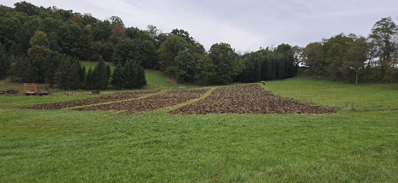

The ground is steeper than it looks.
We only plow up hill. Dead head on the way back.leave a dead space every so often to prevent erosion...
Even tried a 2 bottom flip plow on a D17.
Still leaning on going back to drag plow. And weighting the tractor so draft control isn't nessasry...
