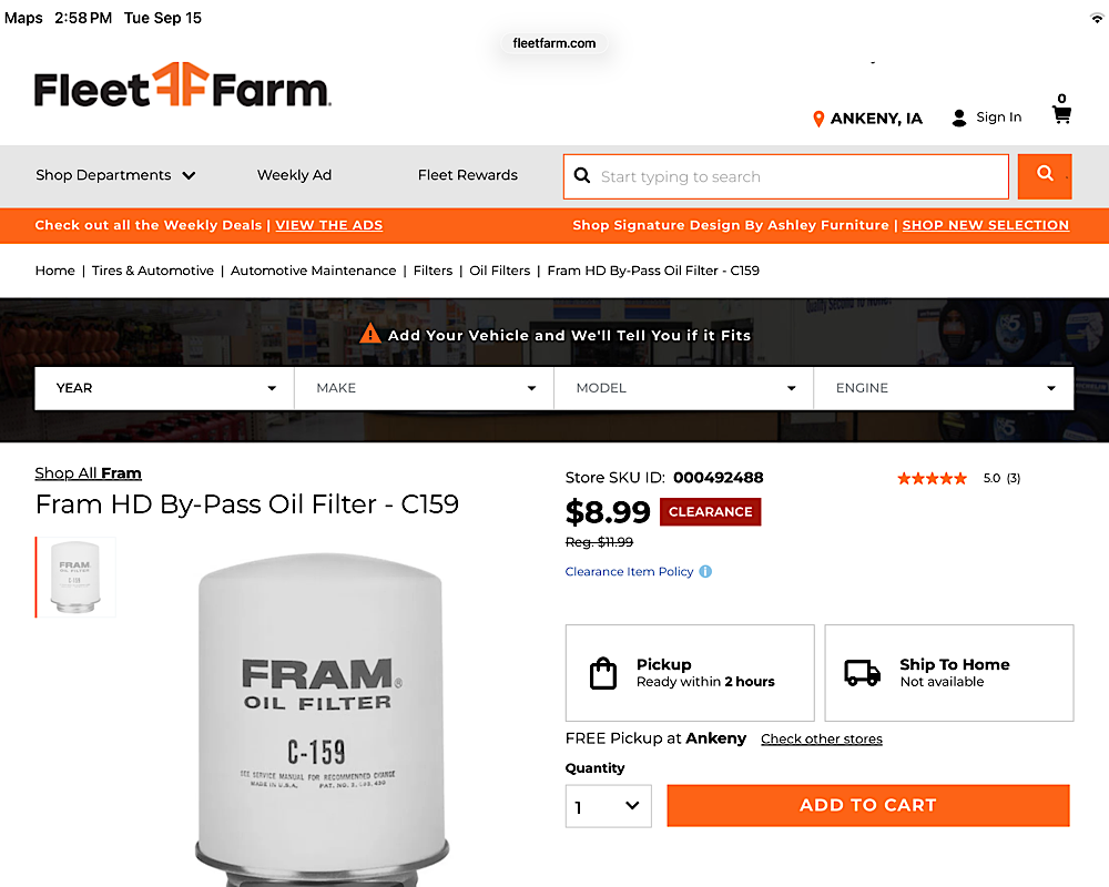

Mill’s Fleet Farm has the Fram C0-159’s for around 12 bucks. Check their on-line store.

boy, if you are lucky enough to have a Fleet Farm close that has stock, this is a buy of a lifetime, pickup only, no shipping

I loaded up on them at a Fleet Farm in the Twin Cities area when I went up to Hutch this year. Fram's parent company is in bad shape. I am not sure how much longer the C159 will be available. It is almost like they have quit manufacturing them. Lots of places have Fram stuff on clearance to get it moved out.
