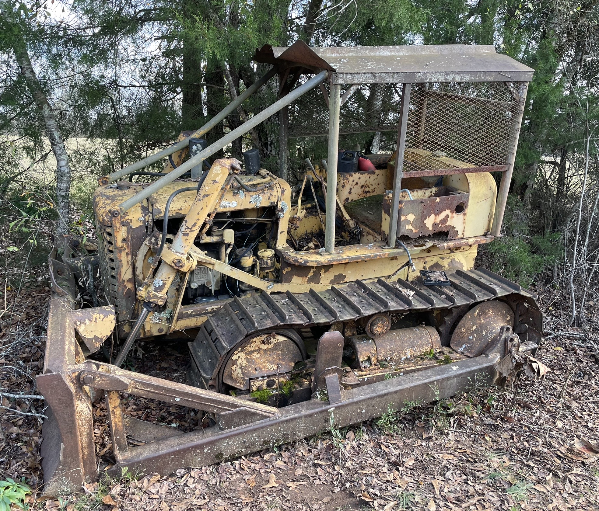

I bought this thing on a whim. It has sat for about 20 years. The tracks, rollers, sprockets, and rails all look to be in good shape. No one has tried to crank it. Before I do I wanted to get it brought home and look it over good and change fluids if deemed worthy. They said it ran and worked well when parked by an old man who passed away. I gave $850 for it. The hydraulic tank looked to be full of sludge so I was looking into possibly replacing the pump if need be. I figure it’s worth that in scrap if it doesn’t work out.
Points: 93484
Post Options Post Options   Thanks (0) Thanks(0)   Quote steve(ill) Quote  Post ReplyReply Direct Link To This Post Posted: 04 Jan 2022 at 4:26pm
if the pins and bushings look OK.... you got  2-3 times that much value just in the undercarriage..

Looks like a brand new spocket on this side. Even if you part it out, you did good.

I think you done good!  Looks like a bit of TLC and you will have a fun toy to play with.

If the tracks are good , you got your money back , rest if parted are a bonus .
The 2-71 is a easy engine to work on if needed . Hydraulic pump is problem if bad as hard to find any replacement easily but would not rule out it's OK .
 33 link track on the 5B dozers ,
Put some effort into it as it may be slow but can still be a working machine
