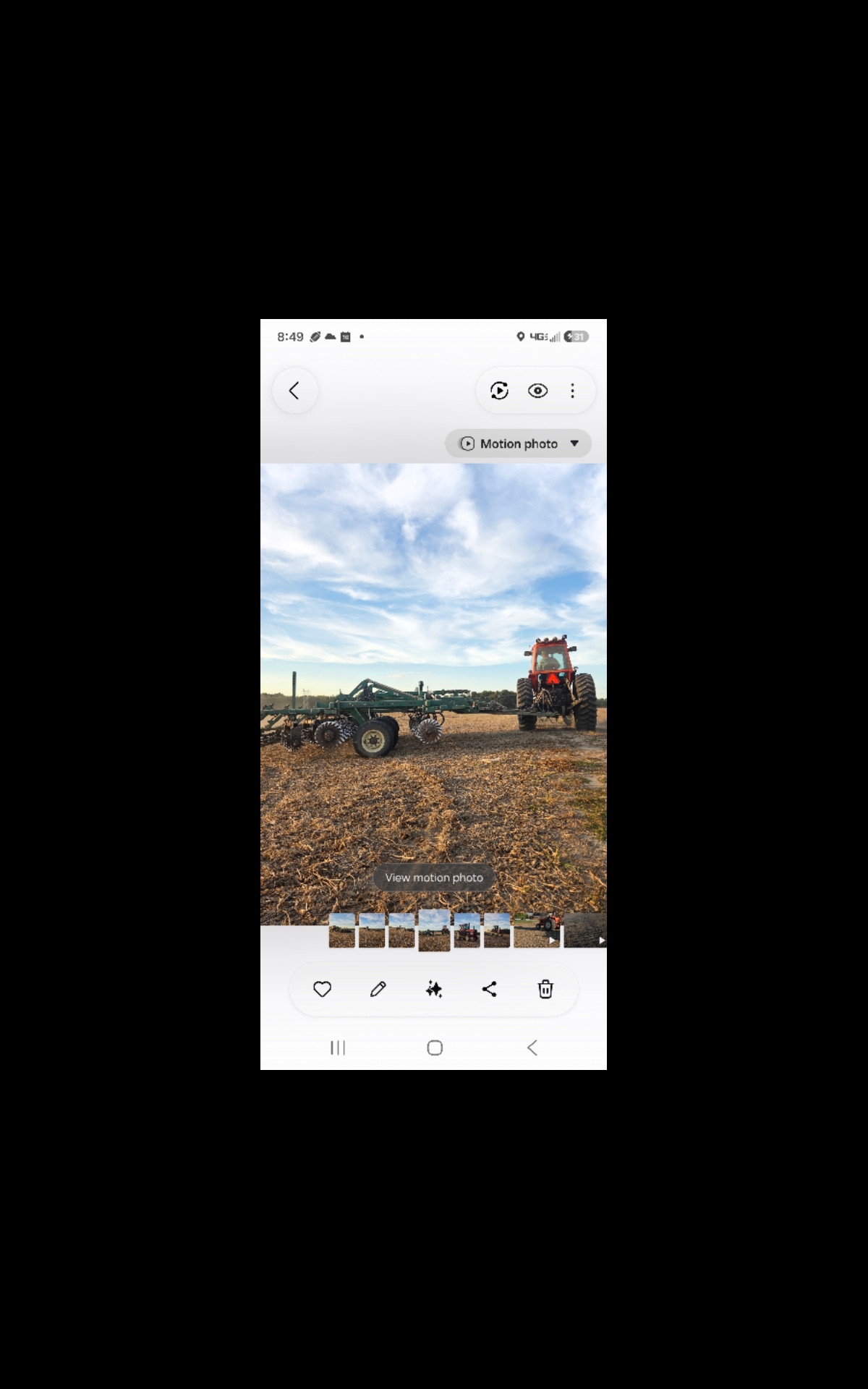

What pressure should be at the hookups? Will a D21 struggle to raise modern heavy duty equipment? Spent the day yesterday hooked up to a 18 ft, I dont know what it is really called, renovator, straight disc blades then another row of disc then two rows of spinning leveling drums. At first thought the clutch was slipping thankfully I was spinning out. I ran her for all it could pull for six hours. Had to stop to replace a O ring below the hydraulic pump. But even when I first hooked up, relevilty cool, it fought raising this thing up or folding the wings.

7060 didnt like lifting it either. Tell me more about mis matched coupler?
I wanted to take advantage of this opportunity to put both the D21 and 7060 through their paces to get some more of the bugs out.
This tool i was pulling was real, Great Plains Turbo Max 1800 TM. The blades were set straight and the debth was at 3.5 max. Covering cover crop seeds on bean ground. The temp guage on the 7060 would creep up to the needle straight up and past which I was able to read with a lazer pointer, was 200 +. I unhooked and went to his shop. I did blow and wash at my house cuase I knew the PO used the tractor for bailing, thought I was good. He had a long air gun bent with rubber tip. I unscrewed the fan shroud so i could get to the 4 corners.I blew with clouds comming out and blew even more and garden hosed and blew again for more than hour. Back to the field. First mark on temp guage is for the 180• thermostats i put in and straight up is 200. It held between the two.
I found the company that makes and sells a flat blow gun, AGCO carries them. I know it needs more cleaning. You could see the gunk pushing out like a zit when I washed and blew.
Overall both tractors passed this test, with a few minor adjustments.
Edited by whatscooking - 10 Oct 2026 at 5:57am
68 D21 81 7060
Points: 23664
Post Options Post Options   Thanks (0) Thanks(0)   Quote DrAllis Quote  Post ReplyReply Direct Link To This Post Posted: 10 Oct 2026 at 6:57am
It's pretty easy too come up with the specs of this machine:   `18 feet wide.....takes minimum of 180 HP to pull.......weighs 15,200 lbs (more than a D-21 does)..... and it requires FOUR hydraulic valves......and it requires one of those valves to be turned on constantly to provide down pressure to the wings.  It doesn't tell me how many GPM's are needed but I know the D-21 has no business being hooked to it and I'm questioning if a 23 GPM main pump on a 7060 is even enough.

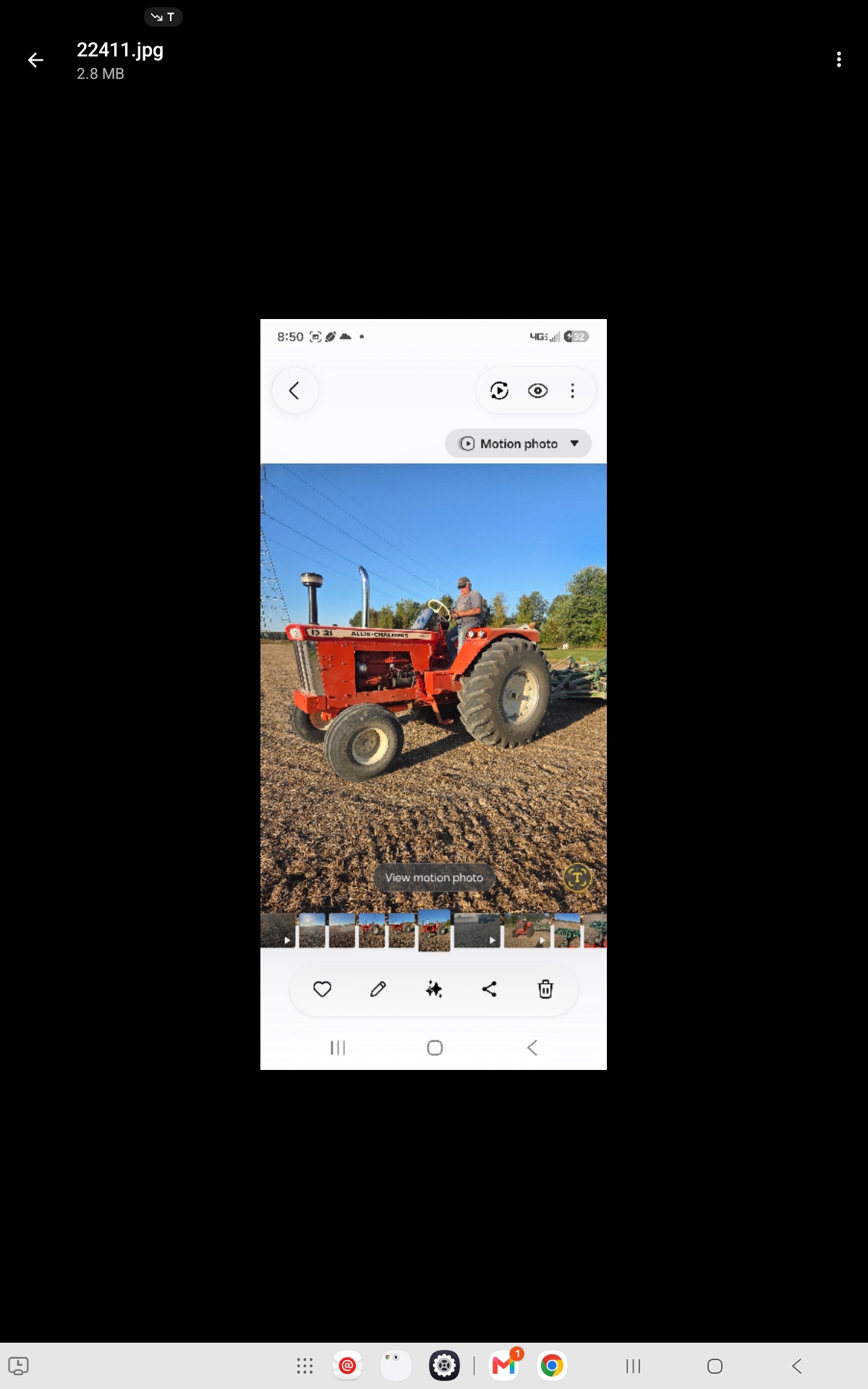

5th gear
Edited by whatscooking - 10 Oct 2026 at 8:03am
68 D21 81 7060

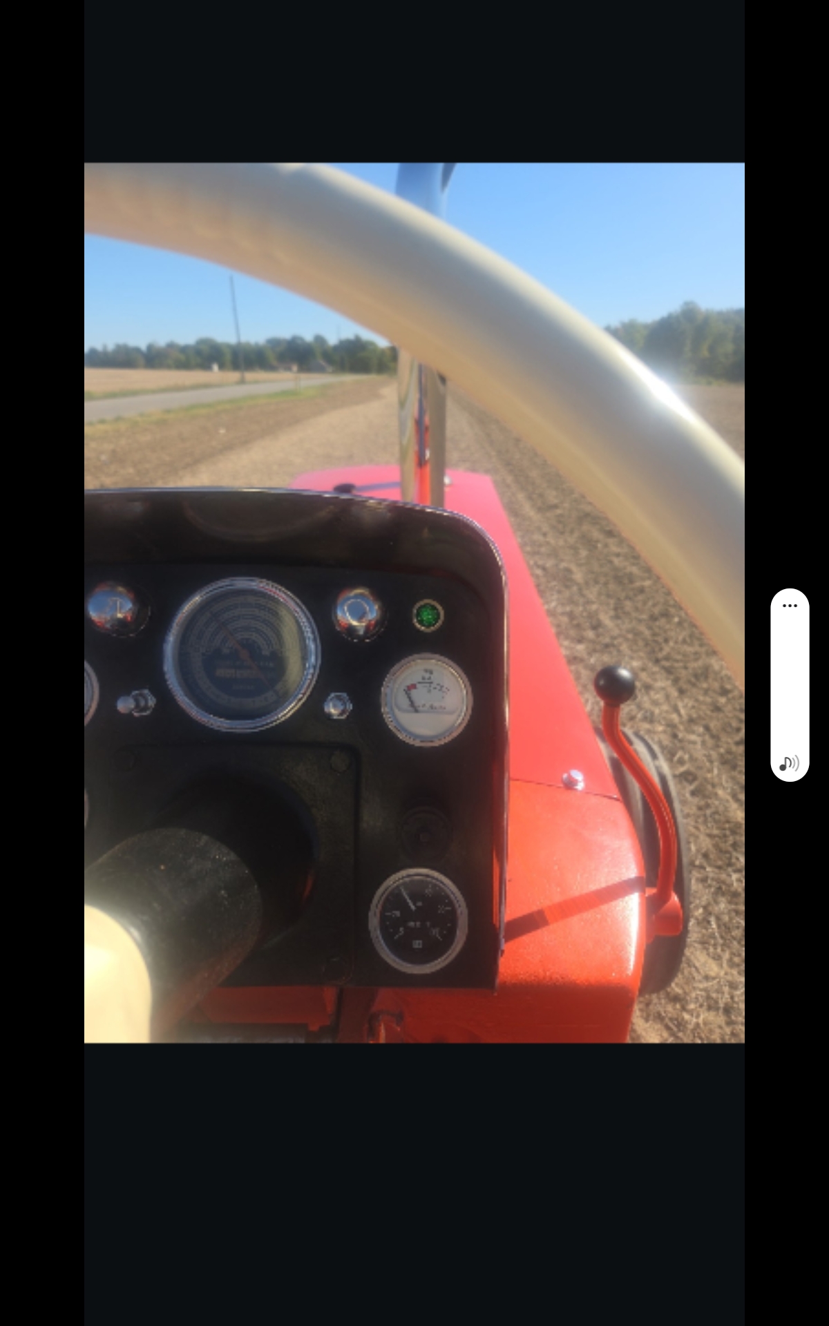

Post Options Post Options   Thanks (0) Thanks(0)   Quote whatscooking Quote  Post ReplyReply Direct Link To This Post Posted: 10 Oct 2026 at 7:58am
1st high range
Edited by whatscooking - 10 Oct 2026 at 8:04am
68 D21 81 7060
