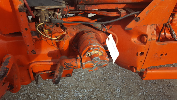

Does your pump look like this one? I spotted it on a 170 the other day. Mounted up where the belt pulley would have been. I know nothing about it. If AC equipment or other? I saw it as an interesting add on pump option. Not sure how functional it was or is, or if the same pump could be used on a lot of tractors.

Early 170s had pump on side like IV4 D17. Later pump was moved to be driven off front of crankshaft.      MACK

That is the stock pump and location for Series IV D17s and early 170 tractors.  You cannot put it on any other tractor and expect it to work though.

Those pumps were "live" and turn whenever the engine does.
There's a quill shaft that connects to the pressure plate via splines and has a right-angle (bevel) gear that engages the pump input shaft.
The largest line is the Intake from the sump.
The medium sized one is line pressure to the hydraulic valve stack.
The smallest line is to the Traction Booster valve; it is a separate stage of the pump and at higher pressure.

D-17 S4 is a dual-section pump. Main section is for the lift and the small section is for the Traction Booster system. A 170/175 have a triple pump. One for the lift, a small one for the Traction Booster and the last one for the hydrostatic power steering.

Do you know if the AC 170 pumps interchangeable with the d17 series 4?
Points: 23650
Post Options Post Options   Thanks (0) Thanks(0)   Quote DrAllis Quote  Post ReplyReply Direct Link To This Post Posted: 13 Mar 2020 at 11:34am
No.  Triple pump on 170/175 and dual pump on D17 S4. Look at the suction hose and suction tube. They are not the same pump.
