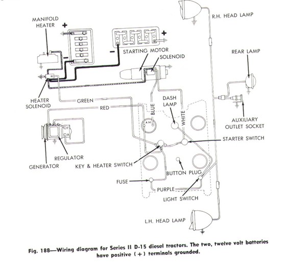

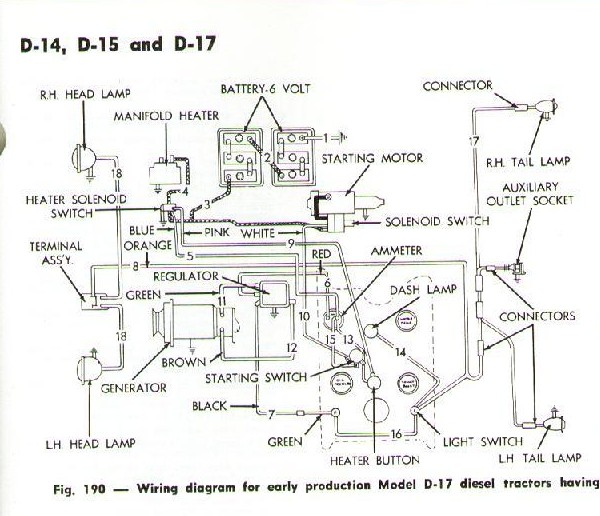

Coke, my old service manual shows the D15 Series II having the heater solenoid wire built into the key switch.... the OLDER D15- 17 wire diagram shows the switch giving power to a HEATER BUTTON , which you then have to manually PUSH to energize the heater.... so the question is, do you have a BUTTON ?? .. and is your D17 a series 1 or 2.. or possibly the series 4 had the key like the D15 Series 2 ??
Points: 93502
Post Options Post Options   Thanks (0) Thanks(0)   Quote steve(ill) Quote  Post ReplyReply Direct Link To This Post Posted: 23 Sep 2026 at 8:27am
this shows the earlier models with  the BUTTON..

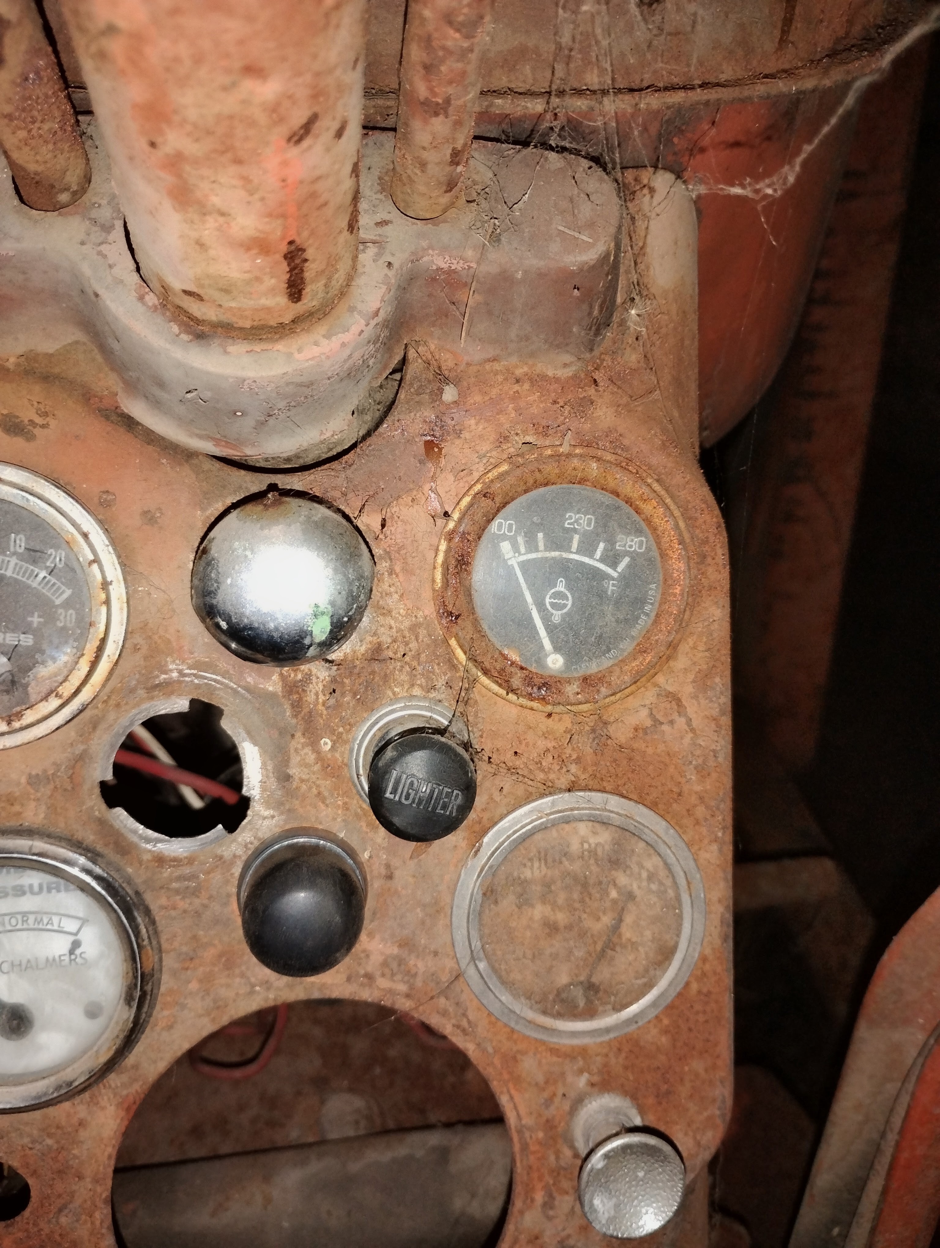

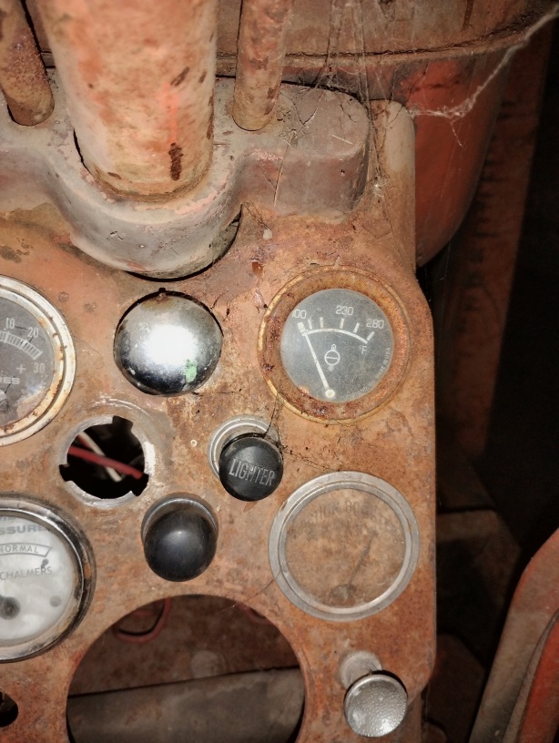

Mines from 1957, not sure what that makes it.
You can see where I removed the key switch, and the black dome is the switch I am fitting just for the starter, other than that there's just a light switch?

you got a key and a button... you can do it either way... You turn the key all the way and it either CRANKS the motor or powers the HEATER.... The BUTTON does the other job.. If your using a dip slick heater with a  120v plug in, instead of a MANIFOLD HEATER, then you dont need this

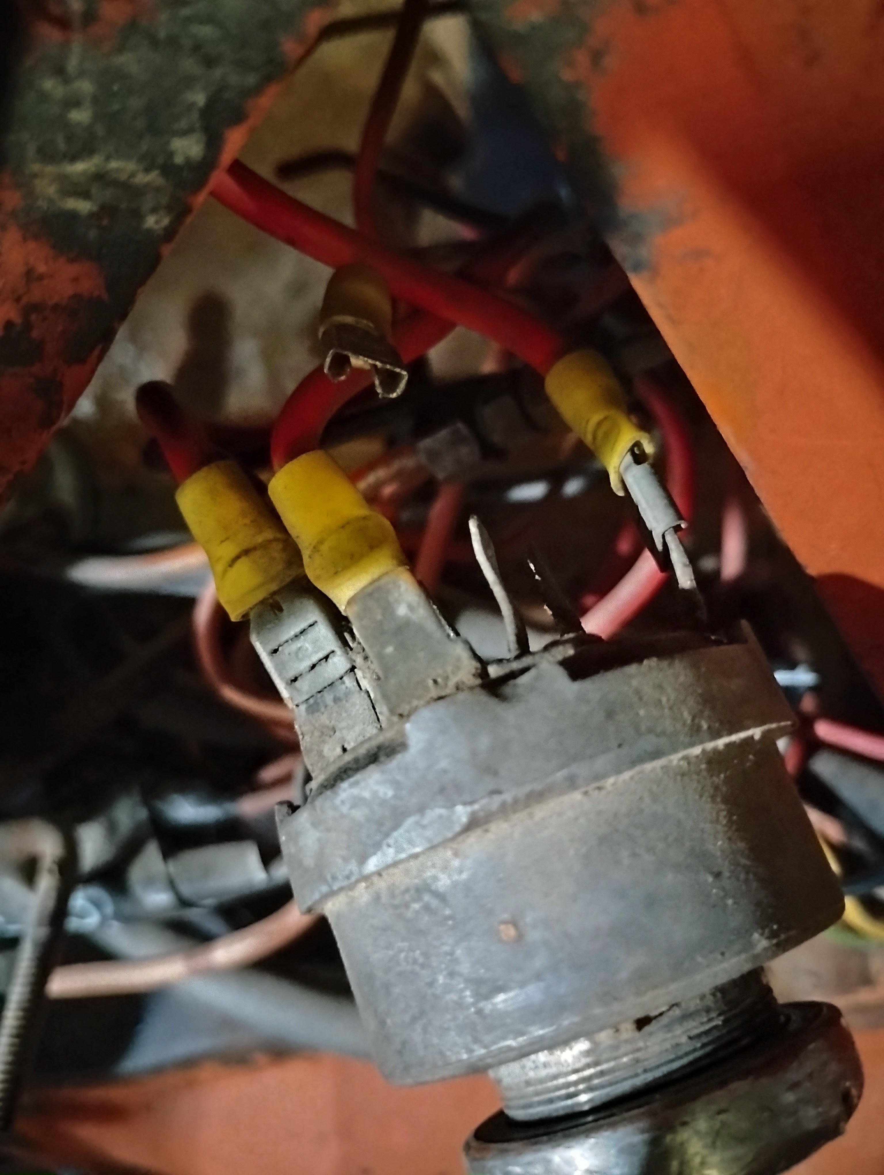

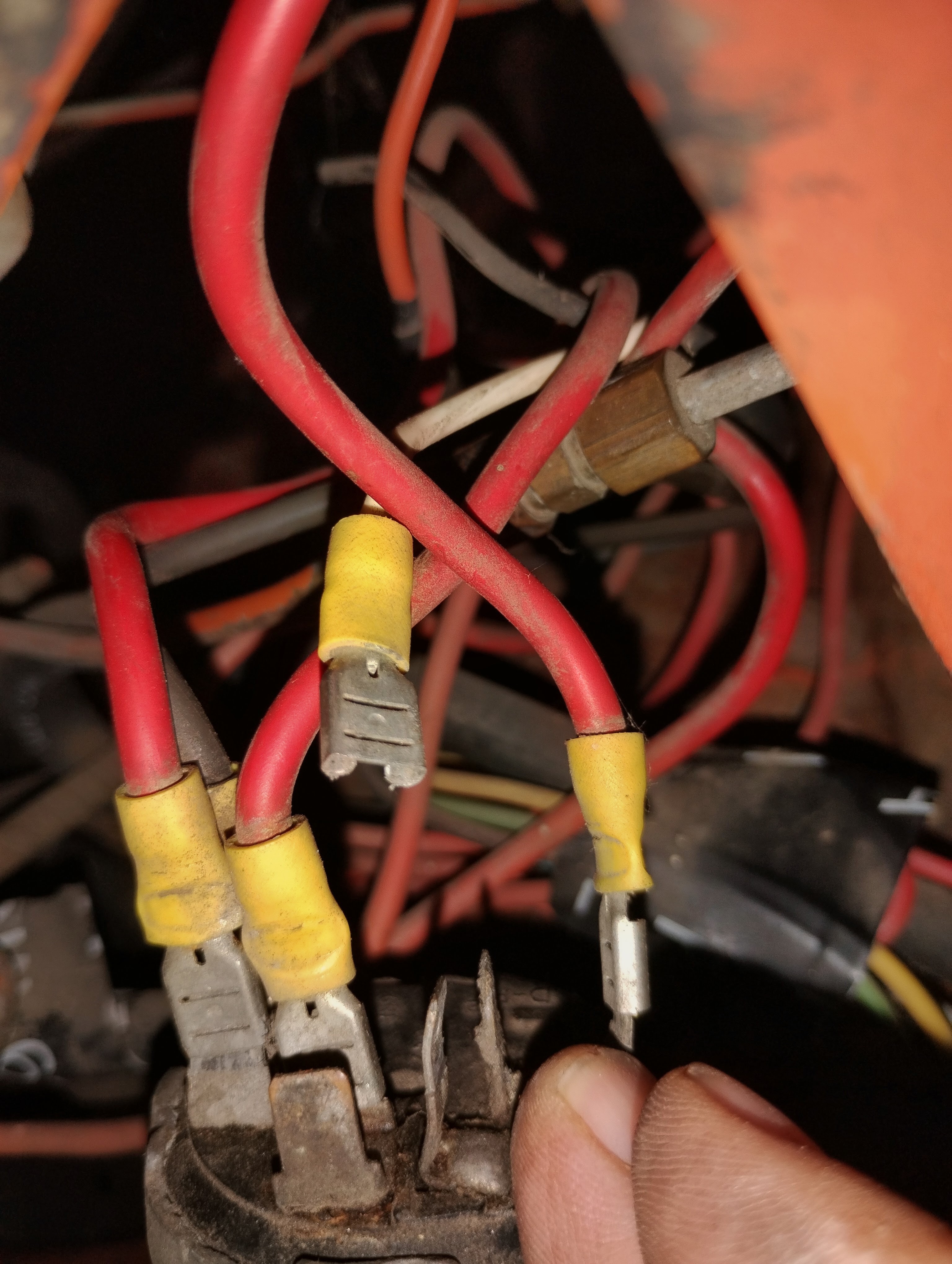

Coke
A pic of your switch front and back would be helpful
An AC switch should have the "off", "on", and momentary spring loaded turn fully clockwise position (that returns to the "on" position when released), similar to car/truck ignition switches.
You noted in your initial post that your switch had no stops or the spring return when fully clockwise.  It is important to confirm if your switch is working properly prior to proceeding with wiring options
Assuming your switch has the mechanical features described above (it turns/feels like a regular car/truck switch) you should test it for electrical functionality
Key in the "off" position, there should no conductivity from the "battery/ammeter" lug to any other lugs.  if there is ANY conductivity, your switch has an internal fault and might be the source of your parasitic load, that is killing your battery
Key turned to "on" position, there should be conductivity from the "battery/ammeter" lug on the switch to at least one lug, perhaps more.
Key turned all the way clockwise, and hold there, there should be conductivity between the "batt/ammeter" lug and one or several lugs
Keep a record of your testing for future wiring hookup
Your push button switch should be tested to ensure no conductivity between the two lugs when in the "off" (not depressed) position, and total conductivity when depressed
Next choose how you want your tractor to operate.
Both options require the momentary circuit engage / spring return action of both the push button and the spring return on the key
One other suggestion would be to remove the side panels under the fuel tank so you can see and confirm where the wires you are connecting to the switch come from/go to.  You will be connecting to the starting motor solenoid, and the air intake manifold heater solenoid power supply wires that activate the solenoids.  Also good idea to confirm other wiring in the dash panel so it is the same as the diagrams Steve(ill) sent you above

The button by the key switch and cig lighter is the one that activates the manifold heater. Just turn the key to the on position and push the button. Those new wires make me suspicious of someone doing it differently than the factory did.
