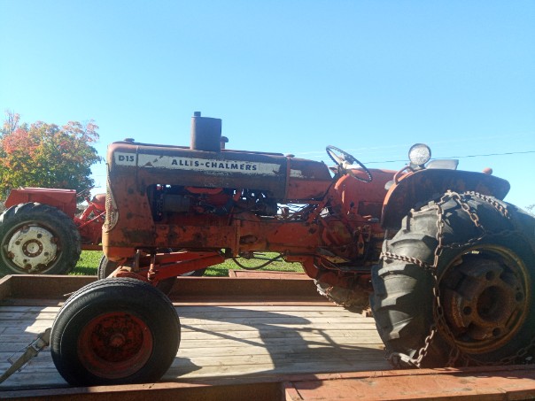

Just bought a d15 series II. Trying to figure out if the shuttle controlled by the foot pedal is original or after market. I've never seen anything like it before, but parts of it look original and it's hooked to power steering pump. Is it possible it was custom built from the factory? Would like to find info on it so I can fix/adjust it. Thank you

Looks OEM to me. Not standard equipment, but an OPTION. I have no idea how to adjust. WHY do you think it needs adjusting ??

It might be something someone took off of a construction tractor, and installed onto the ag tractor...Wink

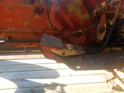

Reason I would like to know how to adjust/fix is because it seems to be too hard to operate by foot. I'm guessing that's why someone manufactured a lever to bypass. If anyone has any info on it would be appreciated.

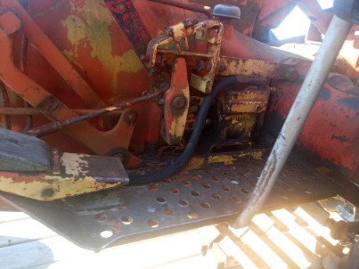

Also wondering, it has a PTO, would PTO speed be correct due to shuttle. Has internal hydrolics with snap coupler/power booster and no reverse on shifting lever so appears to be factory. Have more pictures if helpful.

When it is running, does the pedal have back pressure resistance? Or is it detents like a hydraulic valve?

PTO will be non standard 780 rpm with a shuttle. I made a rocker pedal for the shuttle on my I-60 backhoe years ago. It was very hard to snap it all the way in. My current I600 has the factory option two pedal system. push one pedal for forward and the other pedal for reverse. When I press one pedal down, the other pedal returns. Took a bit to get use to but works great.

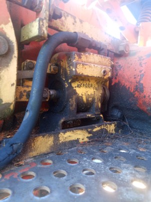

I put oil in power steering and the system started to work but the bushings are so worn/out-of-adjustment that you can hardly get it to go in reverse without using makeshift handle. Is there a way to feather it so it does not engage so quickly when using it as a loader tractor?

I have or should say had one "rocker pedal" type on an I600....
I removed it and installed an original big stick in its place.
It was near impossible to adjust the power divider as the tractor had to be running to have hydraulic pressure from Power steering unit to switch from foward to reverse.
