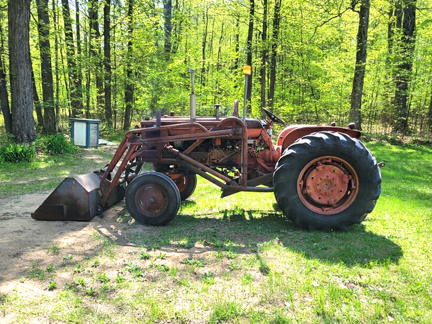

There it is!!
Points: 93534
Post Options Post Options   Thanks (1) Thanks(1)   Quote steve(ill) Quote  Post ReplyReply Direct Link To This Post Posted: 23 Nov 2022 at 9:41pm
Nice looking tractor and loader... Looks like a 3 point hitch arm sticking out in back ?  You might want to add 400 pounds of weights in the back to counter balance the loader / bucket...... A 55 gallon barrel with a cross bar thru it and several bags of concrete inside would work.... or better yet, but a BLADE for the back ! Wink

JC...the tire that spins has no fluid...I need to repair the rim so I put a temp rim on it.
I will put some weight on the back ....this tractor has a lot of bugs in it  and I hope to make it through the winter.
If I ever have it my way it will get tires that have some "good" life left in them ,a good set of lights that look old and the exhaust about a foot or so taller so I dont breath the fumes so much.   everything else should be fine.

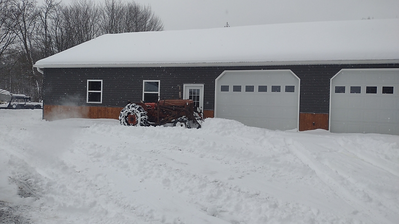

 Your D14 is a sister to mine. I plowed snow with mine for the first time this year. ( I bought it specifically for snow plowing with the front blade) You have a scoop, might be heavier?
 Anyway I have loaded rear tires with pretty good tread. And I bought A set of chains with it that I really did not look at till a couple weeks ago. I lucked out the chanis are not worn at all and are more agressive than road version. (look for the more agressive type chain) Not sure what a set of chains cost? Like everything probably a new set is not cheap.
To me it is easier to plow with the front loader than a rear blade. I am getting to old to turn around as easy. And I like the ability to push snow up and over frozen piles too.
 I think you did good on your tractor. Just needs some items to work better for the job.
