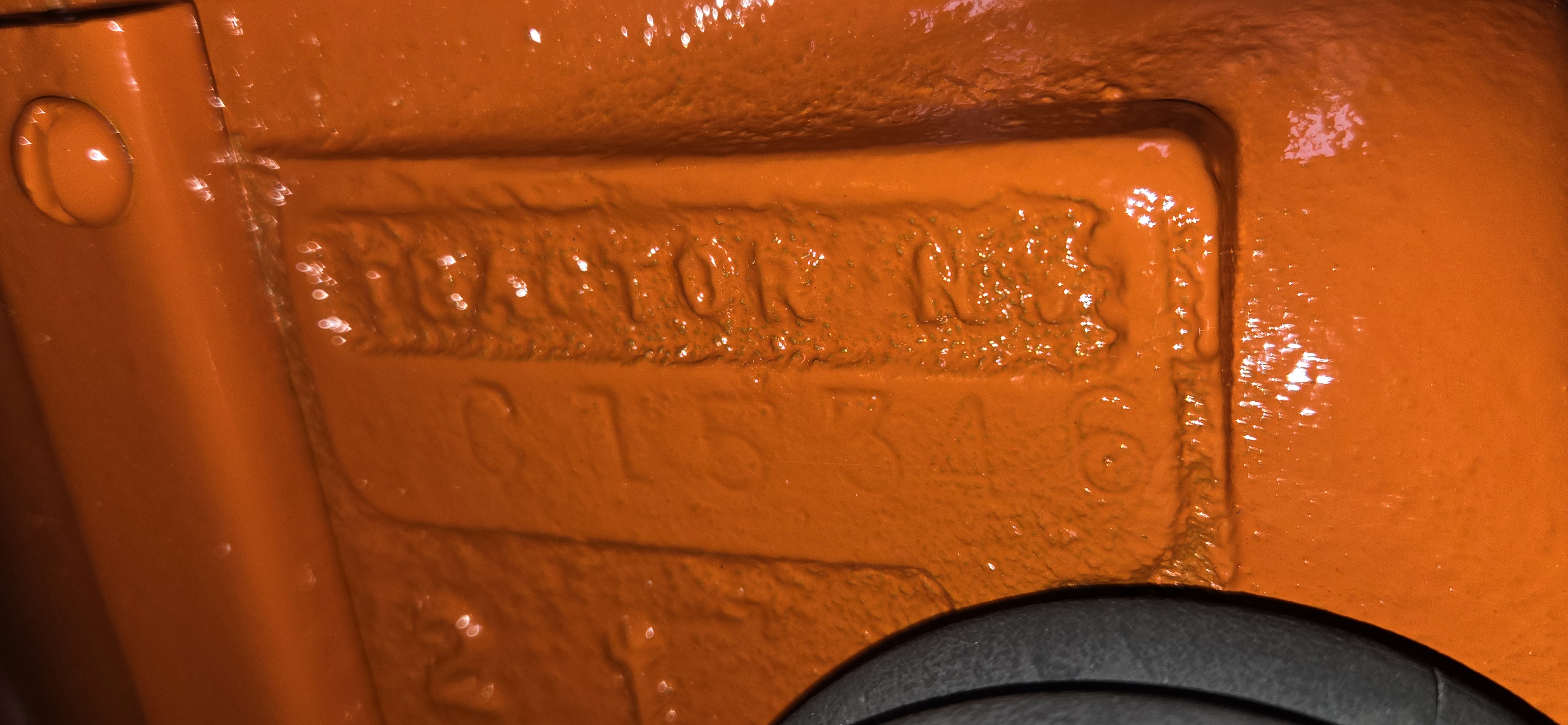

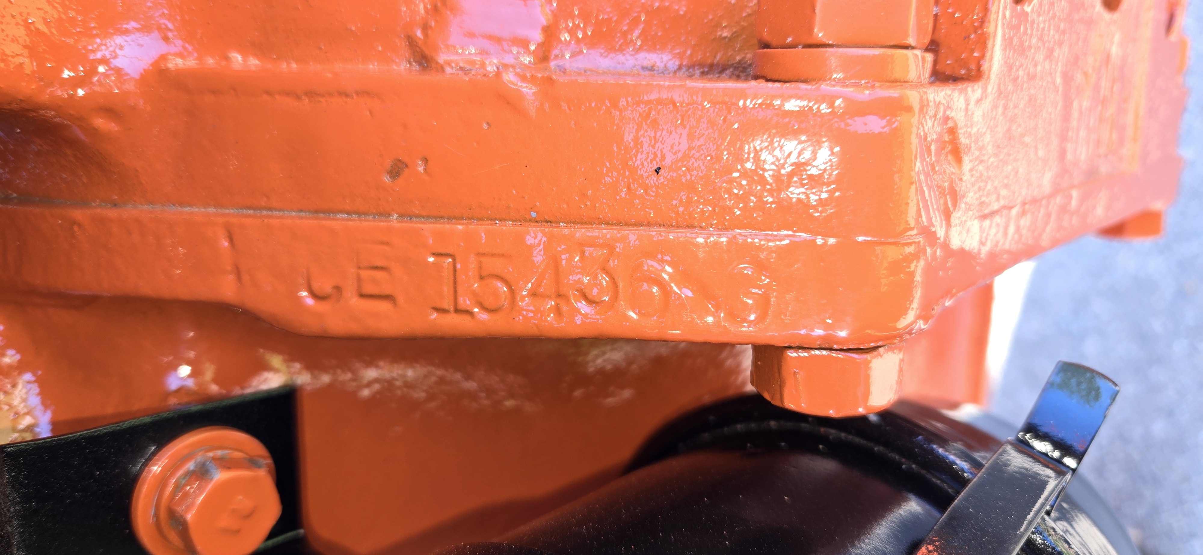

All my life (I'm 56) I was told the family tractor was a 1944/45 C. I inherited the tractor and had it restored. Now that the numbers can be clearly read, everything points to it actually being a 1942 Model C. Number by the shifter is C15346 and engine s/n is CE 15436/G.

   Yup 1942
Interesting to see that the Engine Serial Number and Tractor Serial Number both have all the same numbers, with just 2 digits in reversed position.
G

You're right that is interesting, initially I read it as both identical numbers and thought it strange since engine/tractor number don't usually line up. Even more interesting though that it's this way, what are the chances?

Thanks y'all. I had to double check the numbers too. Thought they were the same when first comparing them. Definitely a 1942.
