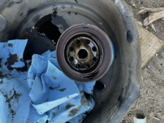

This filter has been on there for a long time and I tried taking off by hand but it’s stuck on there. I will use a band wrench and if that don’t work I will weld a nut on the top. Should a 3 3/4 band wrench work?
Dick L View Drop Down
Location: Edon Ohio
Points: 5093
Post Options Post Options   Thanks (0) Thanks(0)   Quote Dick L Quote  Post ReplyReply Direct Link To This Post Posted: 31 Aug 2022 at 11:51am
I don't have that kind of care of an old oil filter. I drive a large screwdriver thru it and break it loose.  Never thought of saving and old dirty filter. Being 84 might give me a different perspective.
If you want to check the oil flow you can crank the engine over with the filter off to see oil flow up thru the tube.  The gage could have a plug in it fro setting.

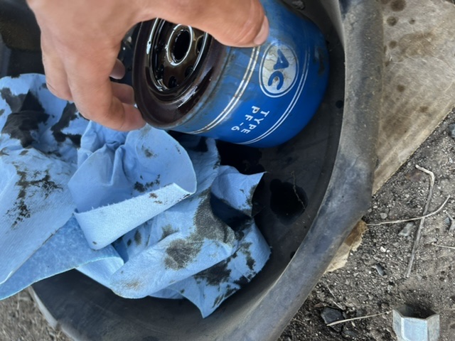

I got a bypass filter, so I went to take the old filter off and it’s a regular filter on the inside like a car. The base plate is like a car too and doesn’t have a tube it had a ac pf6 filter on it. I would put pictures of the filter and base but I don’t know how

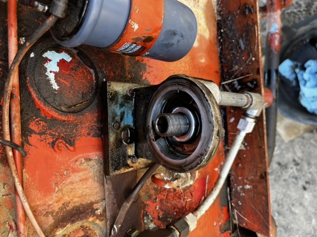

It’s like a normal filter and the threads are in the middle like a regular filter on a car or truck, and there wasn’t much oil in it when I took it off

I can’t even find one of these pf6 filters is there any cross references?

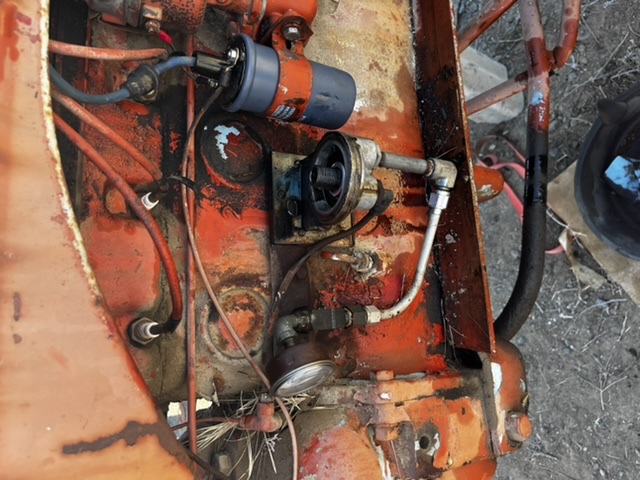

I poured oil down the center of where the filter screws on until it was full and filled the tee up and started it and it was steadily streaming oil out of the filter base and didn’t stop like it did on the tee.

Someone really cobbled that up. You need to get the correct filter housing,gasket, lines, standpipe and filter and I think then you’ll be back in business.

Is that filter system the reason it doesn’t have pressure?
sparky View Drop Down
Joined: 13 May 2011
Location: So. Indiana
Points: 1866
Post Options Post Options   Thanks (0) Thanks(0)   Quote sparky Quote  Post ReplyReply Direct Link To This Post Posted: 31 Aug 2022 at 8:46pm
Putting it back original is where I’d start to find oil pressure.

Yes, that is your problem.... The factory TEE  above the bell housing has a tube running to the filter... the OUTLET of your filter goes to the GAUGE and where else ?  I can not tell what the steel pipe / tee / gauge are all connected to.
Lets look at how the system works... The pump pushes oil down a hollow cam shaft. The Shaft has holes it it and oil is sprayed at the piston / rods / bearings for lube...... about 85% of  the oil goes down the hollow cam shaft.... About 15% of the oil comes out of the top TEE on the bell housing and goes to the filter... The original filter cleans that 15%, then DUMPS the oil back to sump thru a hole in the block ( about 1/2 inch diameter), behind the filter.....
You have an automotive filter that cleans the oil, then  "normally" sends the oil to the bearings... Where does the OUTLET of your filter go ???
Look at my photo below.. Right now, you can take the steel tube running from the TEE to the filter inlet and remove it...  Put the gauge on the end of the line so you can see the pressure INSIDE THE PUMP AND CAM SHAFT... You dont need to DUMP OIL BACK TO SUMP thru the filter...  You can run without the filter for now.
Prove the system works, then you can buy the plate that bolts to the motor that has the correct filter mount ... and a new filter... and you will be OK long term..... Just FORGET the filter for now and see what you have..
If the auto motive filter OUTLET pipe is dumping back to sump thru the block, then just remove the filter outlet steel pipe and PLUG IT and reinstall the filter.. You dont want oil going THRU that filter..
Points: 93381
Post Options Post Options   Thanks (0) Thanks(0)   Quote steve(ill) Quote  Post ReplyReply Direct Link To This Post Posted: 31 Aug 2022 at 9:00pm
again, the big question right now is where does the OIL OUT of the filter ( that 1/4 inch steel pipe) where does it go ( besides the gauge).... is it dumping back to sump thru the 1/2 inch hole in the side of the block ????   Thats where ALL of your oil is going.

So just to be clear I can’t use the filter setup that is on it? Is the system now going to be starving it of oil? I am new to this type of oil system and know nothing of it
