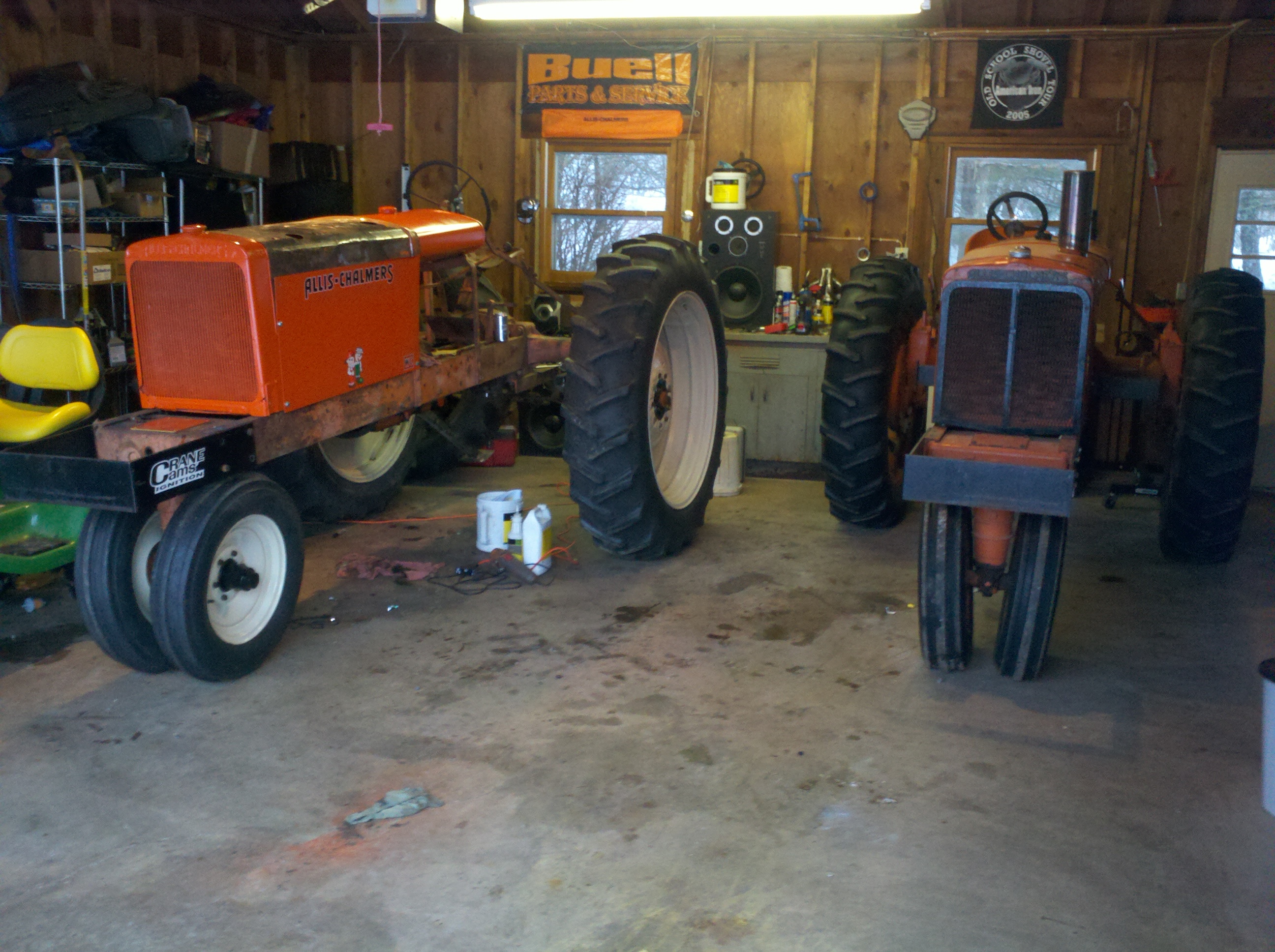

I would vote for Unstyled WC. I took both motors and built them up. Both are running 65 to 75 hp. I like the diffrent look of them. Not alot of people have them around my area. I have two. one is going on four years same motor, and the other one i am in the middle of working on the motor. Want to have one to keep playing with....and alot going to have it all painted up for this summers pulling season.......Hope things change on here soon becuase i am to the point of not asking any opinions because you dont know whats fact or BS.

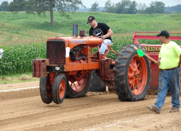

I’m not sure what exactly the off track uses you have in mind. But my nomination is also WC. You don’t have to go crazy to build a competitive one. One our most successful pulling tractors for over 20 years involves a 240 inch WD45 based engine in a styled WC with high crop gears. I’ve run out of places to put all the trophies won piloting this tractor in 3,500, 4,000, & 4,500 pound classes. A successful pulling tractor is much more than just an expensive/exotic engine build. The guy who knows how to read a track, set up his tractor, and drive his tractor will OFTEN beat the guy on his imaginary poorly running 400+ inch tractor. I’m not sure why, but I think that a WC based puller just has some inherent advantages over a WD/WD45 or D17 based tractor pulling in the same weight classes. Our tractor still makes a reliable tractor drive and parade tractor, and it could still be used for many farm tasks that don’t require a tractor with hydraulics or mounted implements. This is just my opinion, based on over 25 years of experience! Kip
