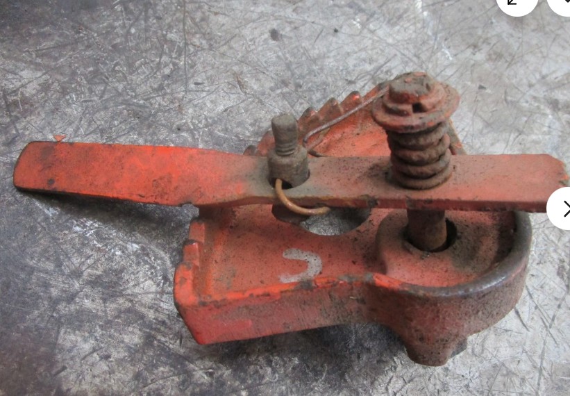

Post Options Post Options   Thanks (0) Thanks(0)   Quote steve(ill) Quote  Post ReplyReply Direct Link To This Post Posted: 13 Jul 2026 at 10:58pm
most of the factory throttle assemblies i have seen look like this... they have a piece of wire thru the hole where the ROD goes and the LENGTH is adjustable... SOMEHOW you need to shorten the rod length to the governor...... and see if that helps..

Post Options Post Options   Thanks (0) Thanks(0)   Quote john2189 Quote  Post ReplyReply Direct Link To This Post Posted: 14 Jul 2026 at 6:41am
Best picture I can get. You should be able to see what it is by enlarging it. Someone welded a rod to the original rod.
