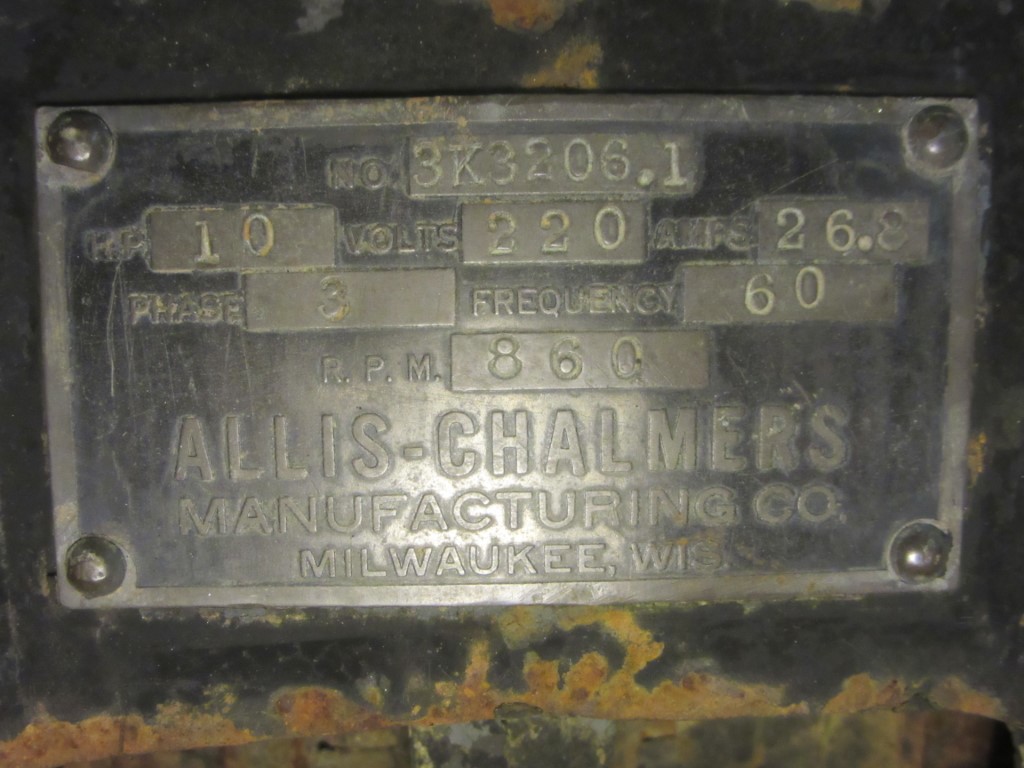

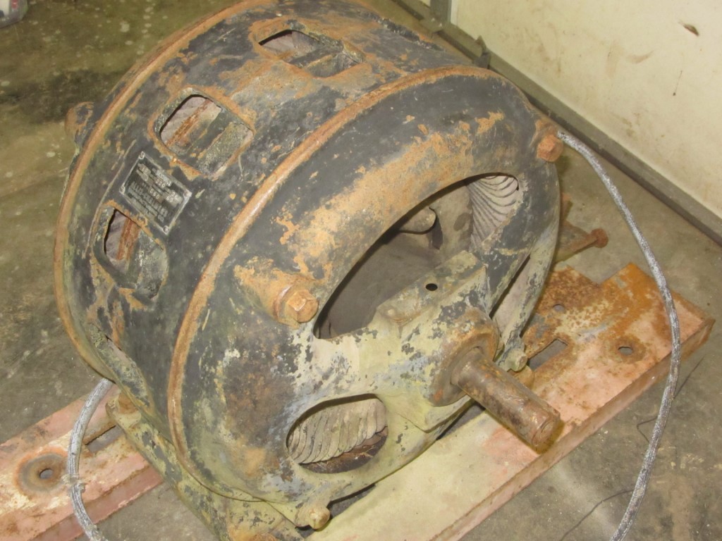

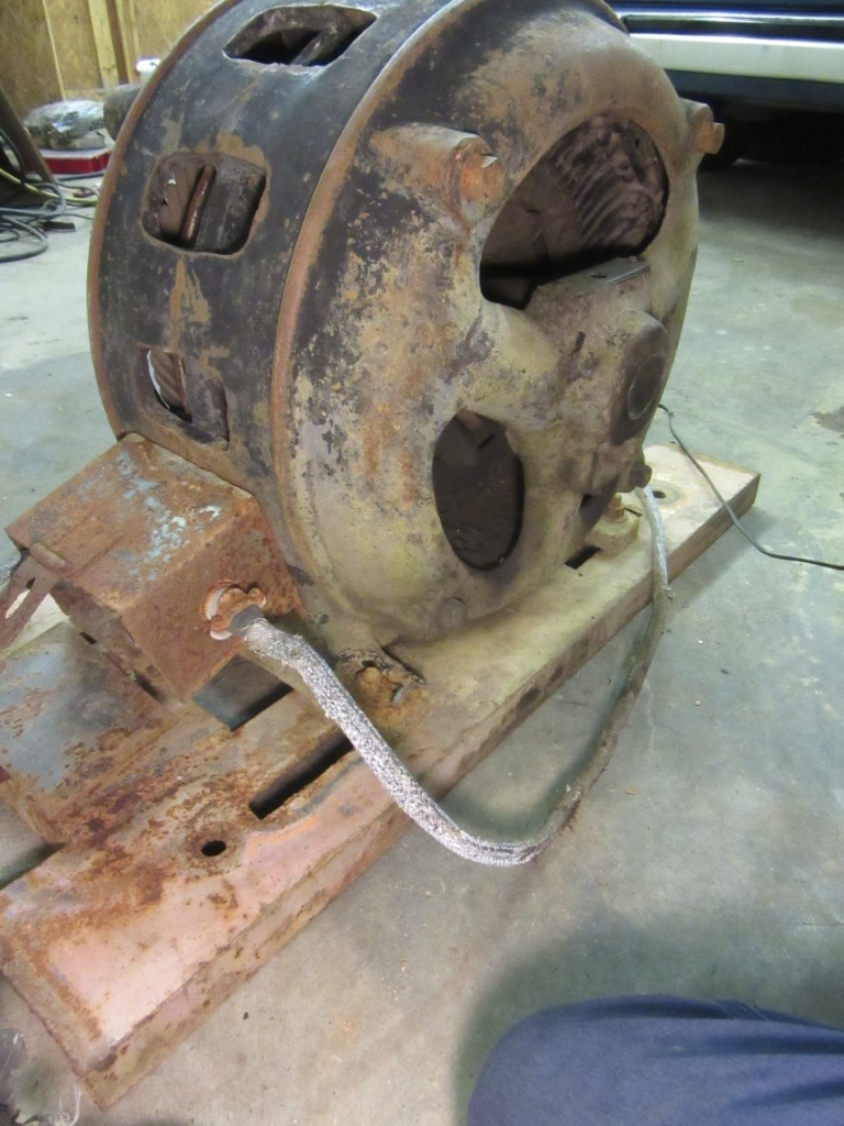

Hello folks. This is my first time posting here, and hope you find this interesting and may be able to shed some light on my antique motor.
I located this Allis-Chalmers electric motor being used an a yard decoration in central Alabama. The owner was moving and wanted to get rid of the motor. He explained that the motor had been part of his grandfather's gristmill many years back and it had not been in operation for about 30 years.
My question is, does anyone know of a way to estimate the manufacturing date of this motor? It appears to be 20's to 30's vintage, based on the styling of it, and the ring-oiled journal bearings. But I am not really an expert and would like to know if the motor's nameplate can shed some light on the manufacturing date.

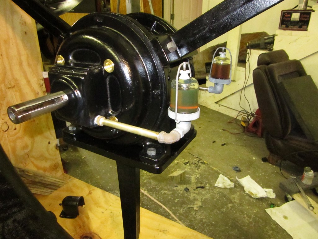

I love the glass oiler cups, as well. That design sounds like my 1925 B.F. Sturtevant 42" exhaust fan motor. It's a Western Electric with glass oiler cups.

Must turn the pipes to fill the oilers cause you would make a awful mess other wise
YEP.......... kind of looks like the gas filter on an ALLIS B ??? Thumbs Up

This would be a Proper Bubbler type oiler
https://www.tricocorp.com/product/opto-matic-oiler-glass/#

Those oilers on the antique fan motor aren't that bad, actually. The oiler assembly, with the metal base, will rotate and "cam out" of the pipe ell fitting. It works like an 1156 light bulb, where you push down and turn it to release it.  Once it's out, you can turn it upright, remove the metal cover, and refill it.

Very interesting. If I remember, the oiler on the Sturtevant motor is Trico branded as well.

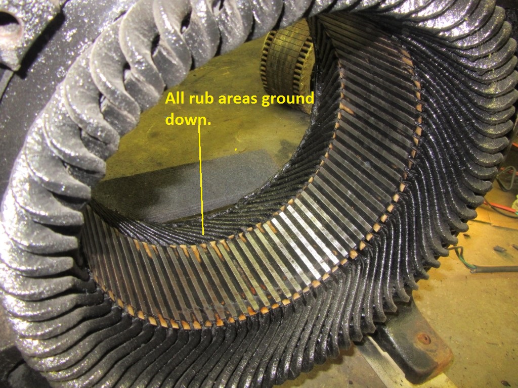

I made some more testing on the Allis-Chalmers motor today. My fear for this motor was that the winding was damaged. That could have been caused by the rotor rubbing the stator, and causing a localized hot spot. It could also have been caused by moisture and dirt in the winding.
When I got the motor, it had a very poor insulation resistance value; just several KΩ of resistance. This was because the winding was caked with dirt, grease, feed dust, moss, mold, and other debris. That was causing a resistive short to ground, which could have burned the winding out, had the motor frame been grounded when it was running.
I tried solvent to clean the winding, but it was not cutting the soil, since it was mostly non-petroleum materials. I had to resort to mild dishwashing soap, and the pressure washer. That blasted away the crud. It improved the insulation to several hundred KΩ of resistance, but that's still dangerous.
My go-to method for drying a winding is to put a lot of amps through it with a DC supply, such as  battery charger. In this case, the motor is so massive that even my biggest charger pushing 35 amps through it, only made it "warm" and not hot. It took a portable heater, a blanked over the stator, AND the charger to get it piping hot and drive the moisture off.

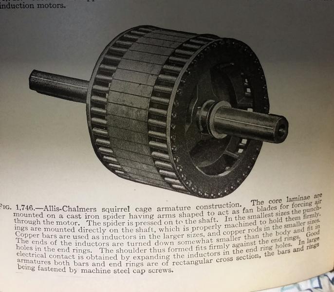

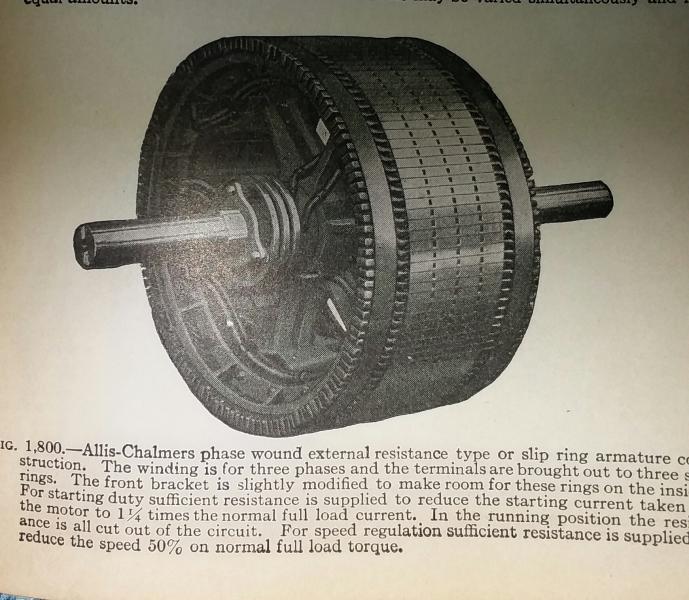

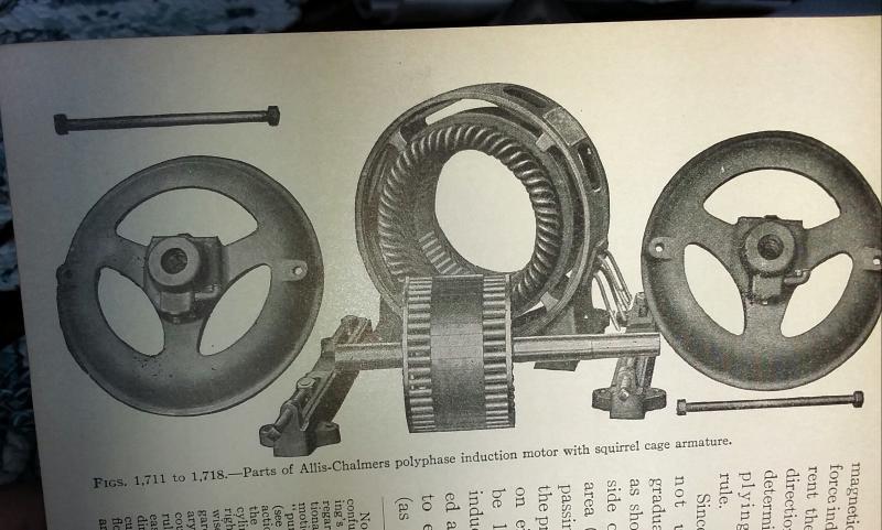

Hi Folks. A friend over on the Antique Fan Collectors' Association shared these book pages with me. This book is from 1914 so it seems this motor may be a few years older than we first assumed.

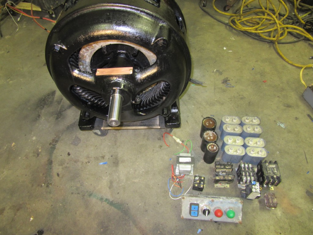

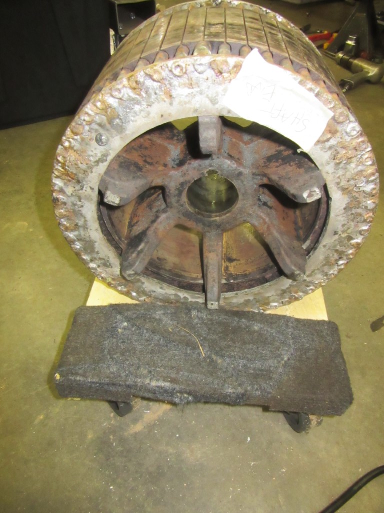

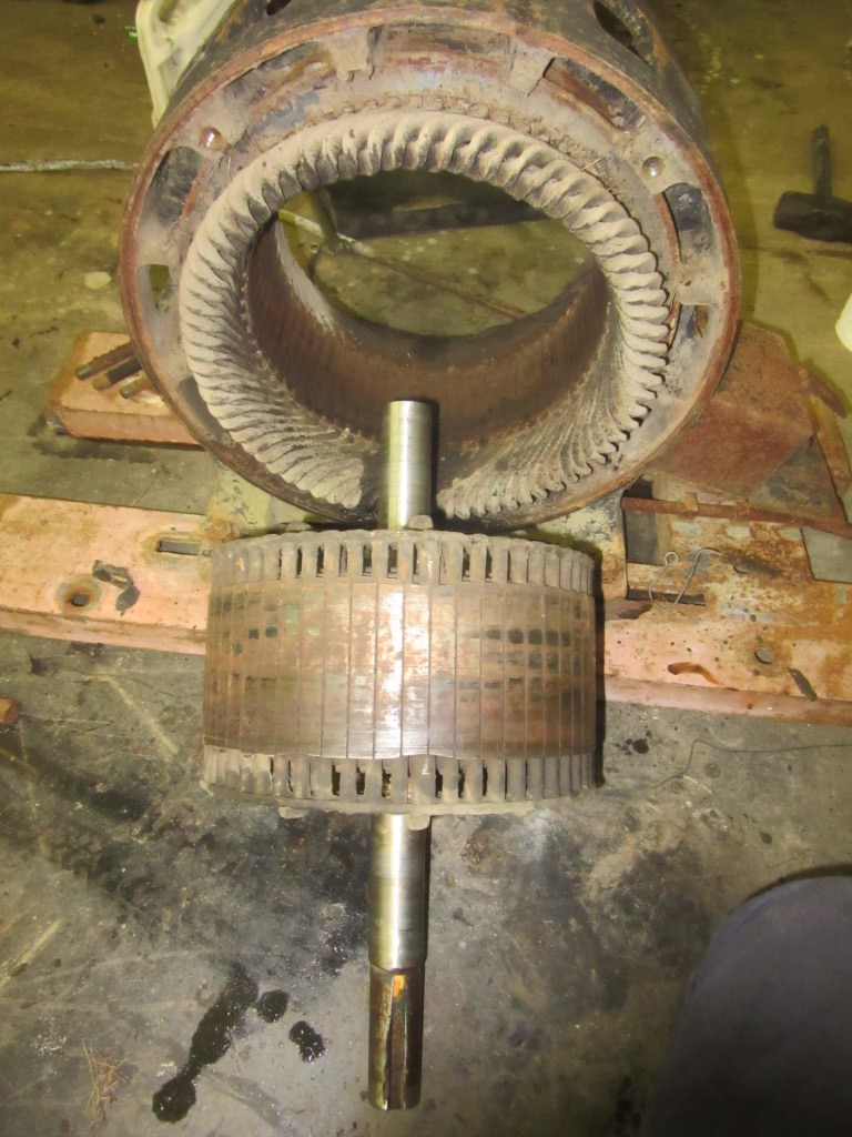

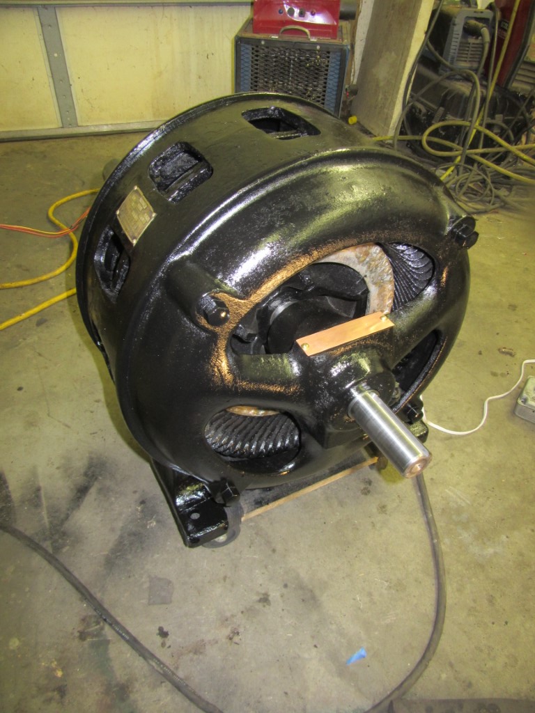

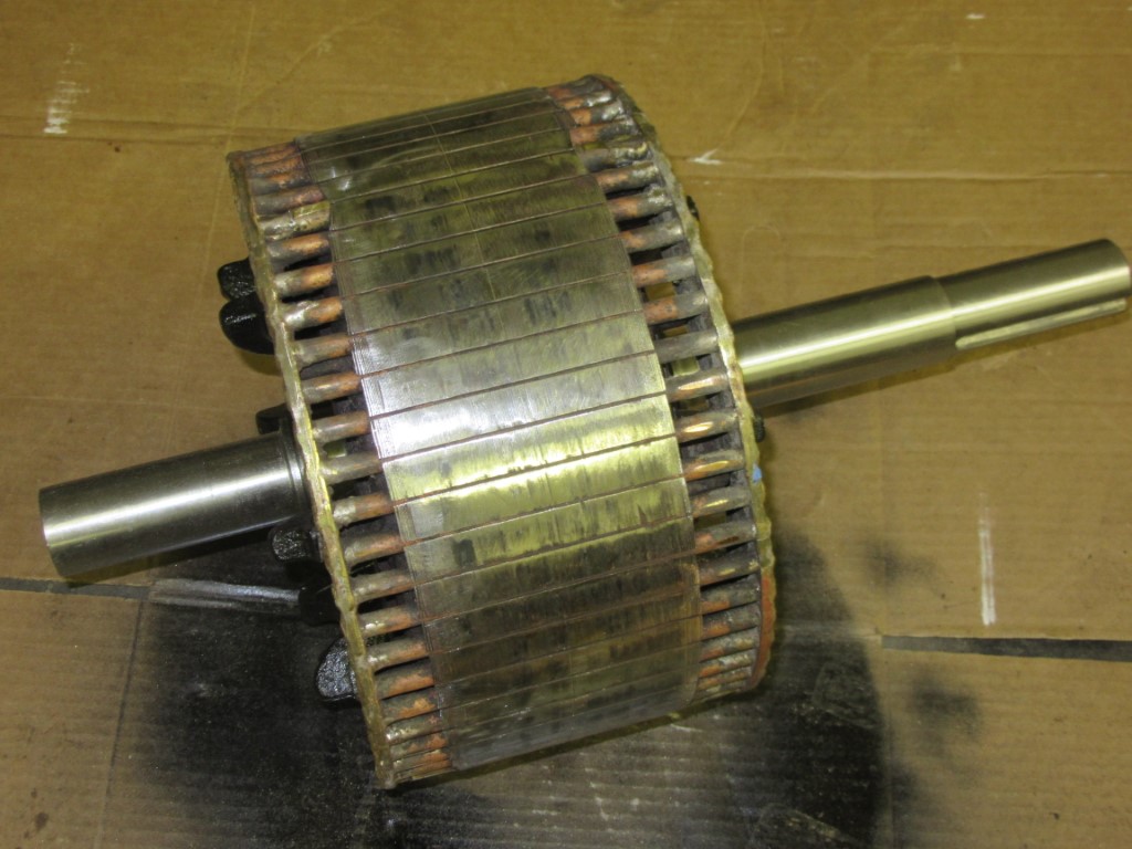

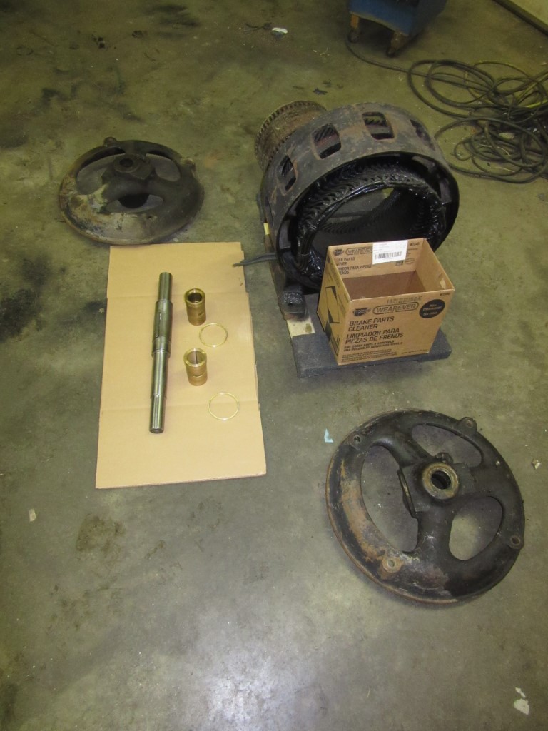

Hi, I wanted to check in again after letting this motor sit for so long. Things were very busy at the machine shop where I took the worn shaft and bearings. I also went overseas for work and was unable to follow up with them about this small job repairing the shaft.
Finally the shaft was completed!

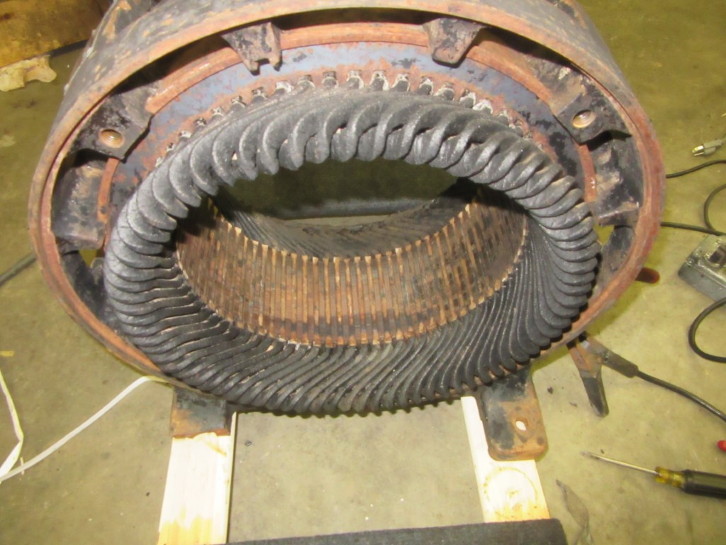

I also had cleaned and re-varnished the stator, in preparation for getting use. Some of the slot covers were pushed up and rubbing the rotor, even with the shaft repaired. I buffed them down so that nothing would rub.
The rotor also had grime and rust, so it got cleaned.
I modified the bearings slightly; by adding a copper pin. This is to prevent the oiling ring from jumping out of the bearing slot and failing to oil the shaft. I didn't take a picture but it is in the video.
With a new coat of paint, it's looking pretty neat, even if I do say so myself.

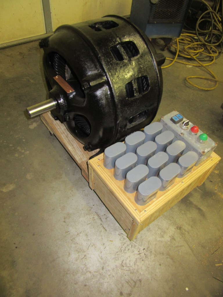

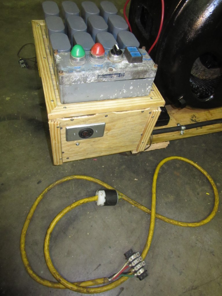

So - what to do with it?  I love antique machinery but I also like to be able to put it to use. In this case, I don't need to run any equipment with a 10 HP motor.... but I do have a three phase converter which is getting really tired. Time to build a new 3-phase converter!

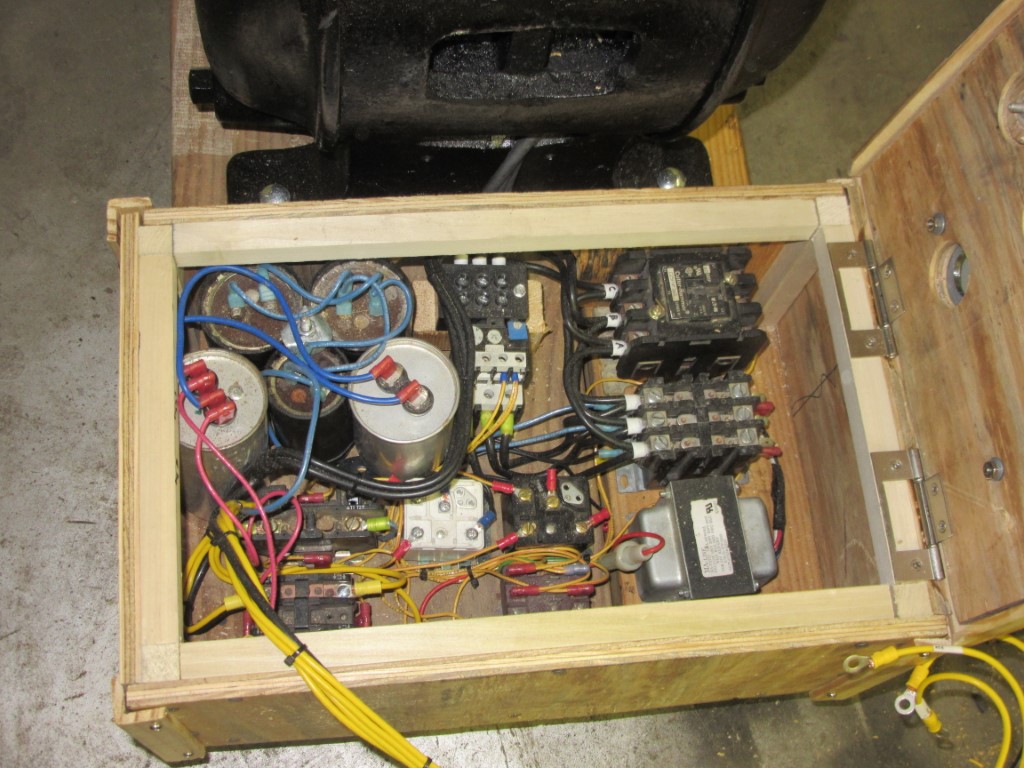

Virtually all of the parts used were salvaged parts.
I built it into a wood base with wheels, so as to make it semi-portable LOL!
The 3-phase outlet and test cord.
There's a lot in the box...
I continued the motor restoration videos, with the shaft and bearing reinstallation.
[TUBE]-p0qtqYTiGQ[/TUBE]
There is a link to the phase converter build at the end of the motor repair videos. If it doesn't appear, you can copy this link to the first of the phase converter build videos:
https://www.youtube.com/watch?v=RyG_hOwCrAY
I'm sorry, in advance, for the rant in the videos. Just a little irritated with the trolls these days. :)
This motor has so much iron and copper in it, that it makes an amazing phase converter. Well more potent than expected. Could start another more modern 10 HP motor "effortlessly" and even was able to start a 20 HP.
Thanks for the interest and hopefully you've enjoyed seeing this yard decoration be put to use again!
