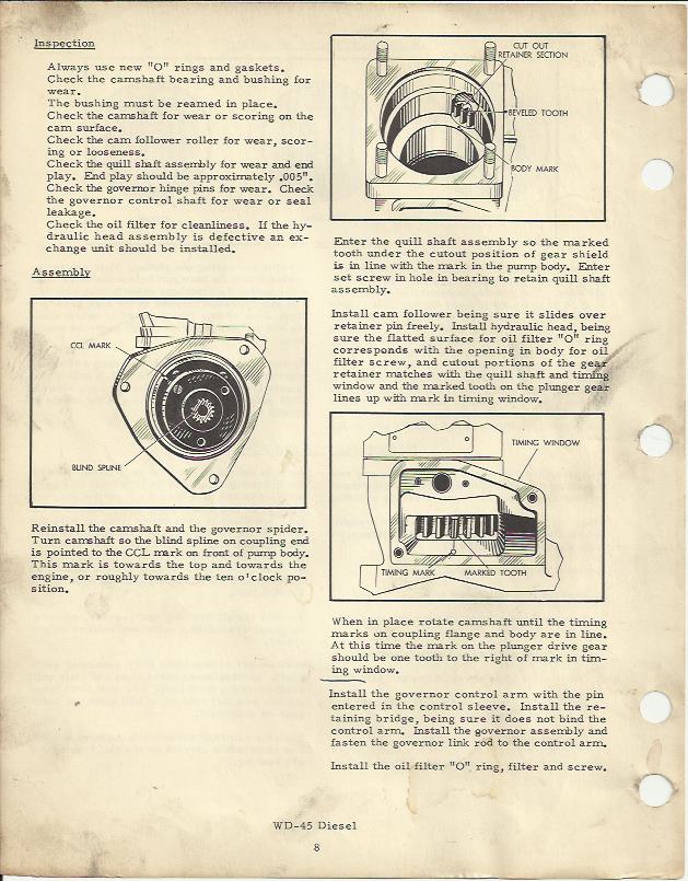

I will post the PBS lit here, it is for a WD45 diesel but will be similar.

Thanks, JC(WI).  That will be really helpful.
The governor arm is free.  I believe when I first attempted to move it, there was a slight resistance, I'll bet it and the sleeve were just lightly stuck.  It didn't take any force at all to get it to move, but it was just a bit sticky for a while.
It is moving completely freely now though.  I'm sure that the pump plunger probably has the same tiny bit of gum holding it up, so it can't do its job.
With the information you've posted, I should pretty easily be able to pull the hydraulic head and get to the pump plunger.  With access, I can gently apply a bit of persuasion and work it back and forth until it is free.

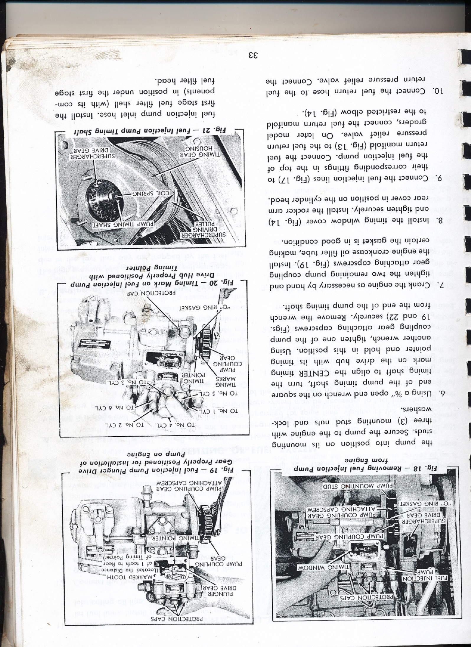

Here are a couple of pages on timing a PSB 6 from the AC Forty Five manual.  Apologies for the one upside down

Ian Beale View Drop Down
Joined: 03 Oct 2011
Location: New South Wales
Points: 1020
Post Options Post Options   Thanks (0) Thanks(0)   Quote Ian Beale Quote  Post ReplyReply Direct Link To This Post Posted: 04 Jan 2018 at 5:54pm
Dave
All positions from Jensales.
Plus I was navigating upload at the time

One point I’d like to confirm with those who have been there before me relates to aligning the sheet metal window on the quill shaft hat.  I assumed that I need to align the timing pointer on the pump drive with the timing mark, then install the quill shaft such that the window in the hat faces out, allowing the hydraulic head gear to drop in.
In this photo, you can see the pointer, with the timing mark about twenty degrees past the pointer.
[url=https://postimg.org/image/5lsncly7p/]https://s26.postimg.org/4jigu2feh/20180121_083817.jpg" />[/url]
Here is how I installed the quill shaft with the line aligned with the pointer.  It made me a bit nervous that the sheet metal hat isn’t quite centered, but I tried one tooth in either direction and this is clearly the best fit.
[url=https://postimg.org/image/oe4ig7a1h/]https://s26.postimg.org/urtljgexl/20180121_084239.jpg" />[/url]
Now, my problem is to find out how to put the No. 1 cylinder on top dead center of the compression stroke.  I found the timing window on the flywheel housing.  It is in an easy to get to spot which is impossible to see because of the torque converter hoses and other stuff in the way.

I see that the pump drive gear has a FRONT mark and a timing punch mark on a tooth immediately below that FRONT mark.
[url=https://postimg.org/image/v5uximjh1/]https://s26.postimg.org/xafajpl3t/20180121_102105.jpg" />[/url]
If I’m right about the position of the engine,  I expected to find a timing mark on the accessory drive gear.  I couldn’t find anything though.
[url=https://postimg.org/image/ipy7pf0l1/]https://s26.postimg.org/4w9v0d7zt/20180121_102304_001.jpg" />[/url]
[url=https://postimg.org/image/qwq7gg0s5/]https://s26.postimg.org/e5c19xr09/20180121_102306.jpg" />[/url]
[url=https://postimg.org/image/cc94m50tx/]https://s26.postimg.org/qiovhdbp5/20180121_102329_001.jpg" />[/url]
[url=https://postimg.org/image/d31urcq6d/]https://s26.postimg.org/rm8zsrjbd/20180121_102330_001.jpg" />[/url]
[url=https://postimg.org/image/te1yo6aj9/]https://s26.postimg.org/9w7b88dll/20180121_102333.jpg" />[/url]
[url=https://postimg.org/image/6pcro7nw5/]https://s26.postimg.org/alq3k78vt/20180121_102355_001.jpg" />[/url]
[url=https://postimg.org/image/ly2p2e29h/]https://s26.postimg.org/ypgv8wc1l/20180121_102358.jpg" />[/url]
I see that the pump drive gear has slotted bolt holes.  I assume I need to find the timing mark on the accessory drive gear and set the gear in, then align the pump drive flange score to the pump timing pointer, then tighten down the drive gear on to the pump drive flange.  That will ensure the quill shaft hat window will allow the hydraulic head to drop on.  At the same time, the hydraulic head rotator gear will be timed because the marked tooth will be aligned with the timing pointer in the timing window of the pump itself.
Those in the know, please confirm the above pump installation procedures.  If I’m right about the procedure, maybe I don’t need to worry too much about timing marks between the accessory drive gear and the pump drive gear.  As long as the engine really has No. 1 at top dead center on the compression stroke and I have enough room in the pump drive gear slots to align the pump drive flange score mark with the pump timing pointer, everything should be O. K.
I pulled the valve cover and rotated the engine by hand a handful of times, identifying when the No. 1 cylinder valves were rocking from one closing to the other opening.  From there, I rotate the engine three hundred sixty degrees, figuring that should be close to top dead center.
Garlic Mom got her flashlight and hand mirror and squeezed between the tire and frame to watch the timing window for me.
We went back and forth about thirty degrees on either side of where I thought top dead center was.  We decided that this hole and circle must be the top dead center mark, as it seemed to be just in the right spot.  That spot also corresponded pretty well with 360 degrees from the valve rock point.  Is this really the timing mark?
If it is, I should be at top dead center for the No. 1 cylinder.  By the way, I assume that No. 1 is the one closest to the fan and furthest from the flywheel.

Pete
Try that set of pages for the AC 45.  If yours is similar -
1.  You ought to have a timing mark on the top LHS of the flywheel housing under a squarish plate.  When you have No 1 (Fan end cylinder) about TDC you need the FPI mark lined up with that pointer.
2.  You need the marked tooth on the head lined up 1 tooth to the rear of that timing pointer.  If you have it lined up directly it seems the plunger is hydraulic locking until the distributor lines up with the injection pipe port - which doesn't sound good for the internals
3.  Then there is another timing pointer under a plate on top of the timing housing (the oil filler on an AC 45).  Which has to line up with the centre mark on the boss that holds the timing gear.  And the plunger spring wants to turn the shaft away from lining up with that mark.  You set that on the grader (blower engine) with a shaft that sticks out the front of the timing case which has a square end for a spanner and then tighten the 3 bolts as you turn the engine to get at them.  I'm not sure how you'll do that as I don't have a manual that covers  10000-on engines.  Would be in a comprehensive HD 11 engine manual if you can find one of them.
I've never been in the skew gear section so no help there.
When you do that spill valve shaft and the tang area make sure there are no tiny burrs on anything.  We had problems with throttle response from one which used to catch with the primary fuel pressure on it.  It took our very patient diesel mech son most of a day to find it.
How we got into this in the beginning?  We scored an unused short block with a supposedly reconditioned pump.  Which leaked fuel into the oil.  Because it was missing the bottom O-ring for the head.
Hope yours works
