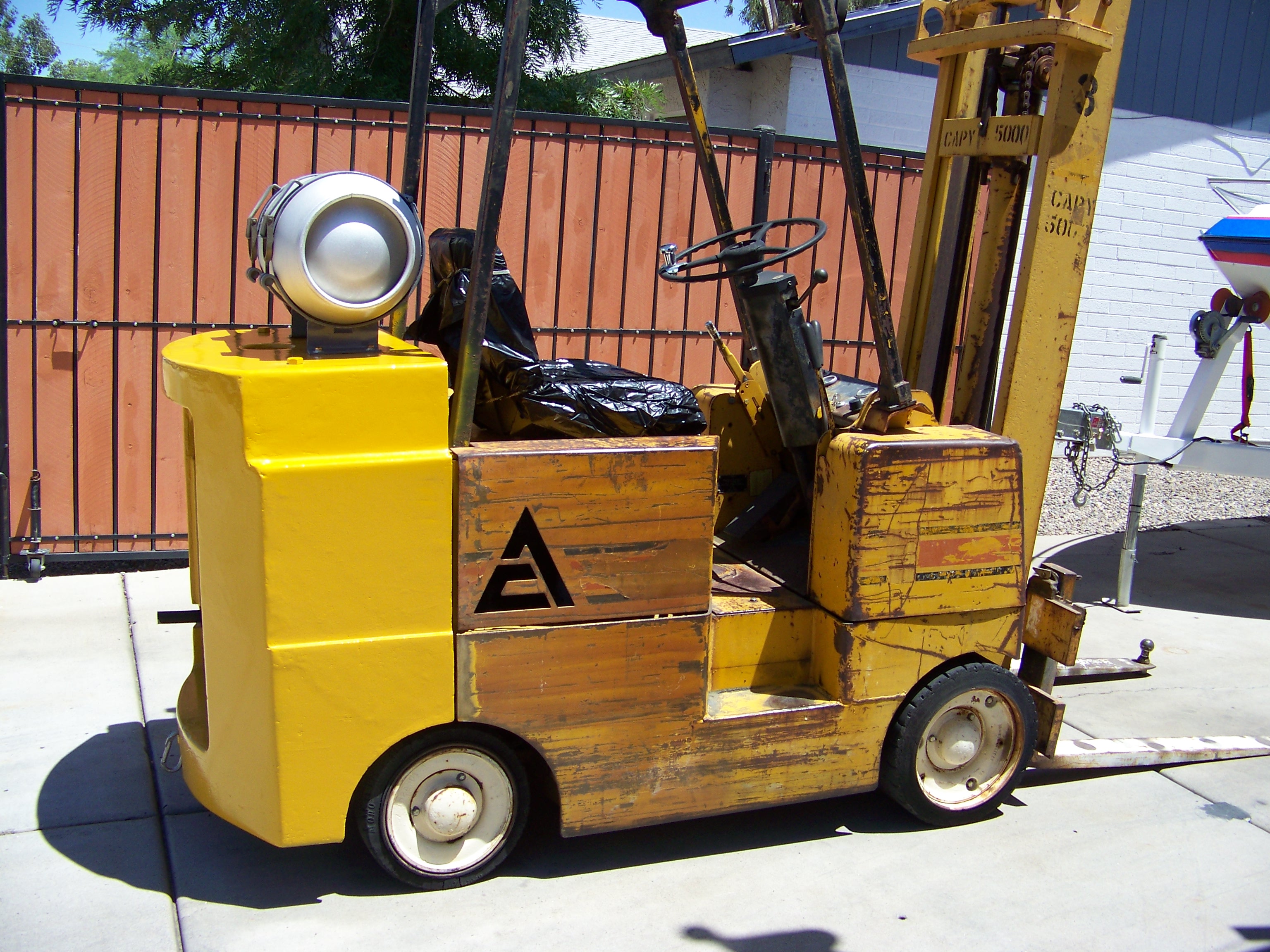

Just checking in. Yep, the seat looks a lot better. I bought a complete one with track for $60.00. Feel a lot nicer to sit on. Did some more paint work At this rate will take years to finish? Was going to post a picture but guess I forgot how

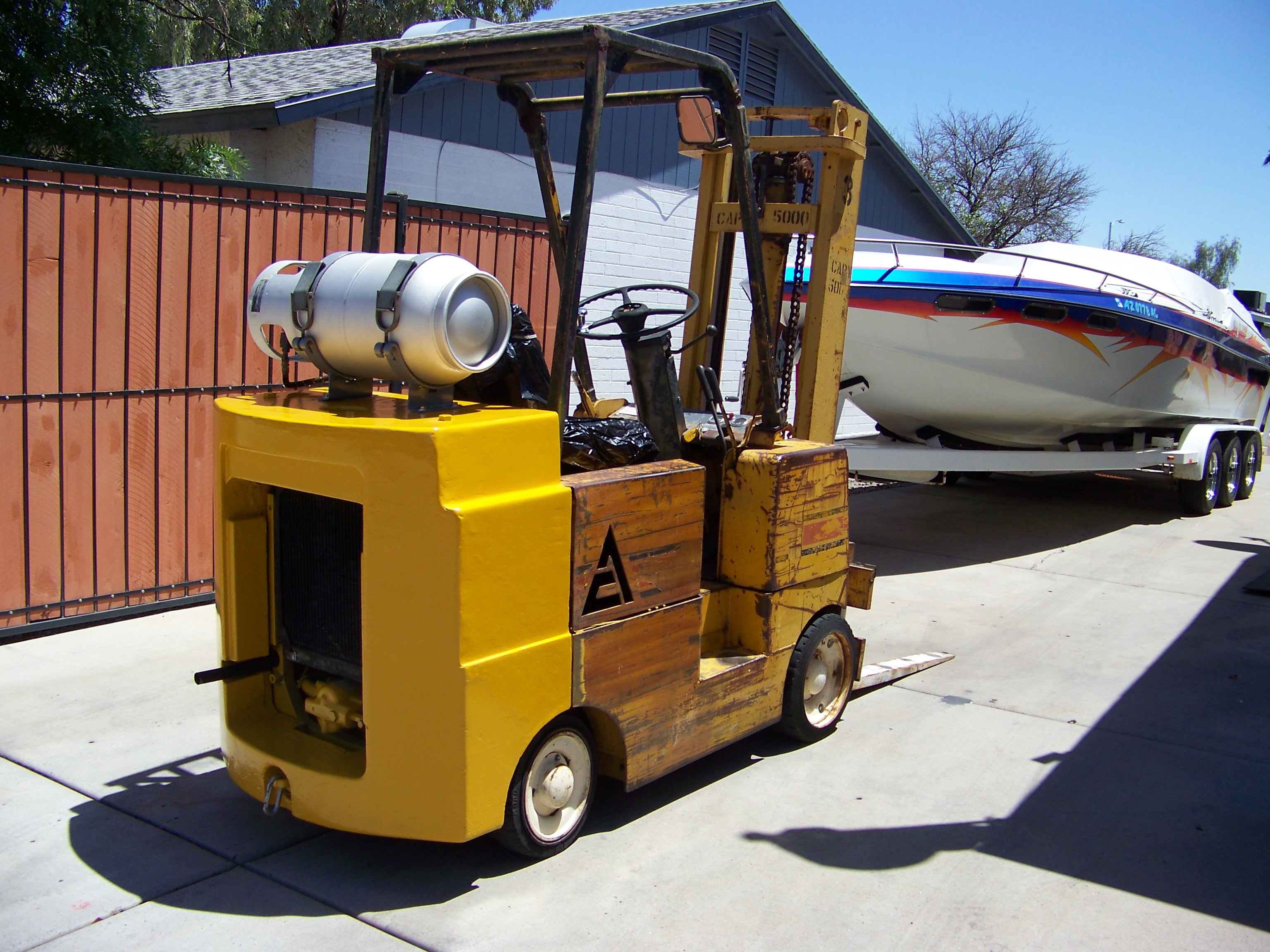

Chris, I run 4 qts of Shell rotella T-4 and 1 qt of Lucas oil stabilizer in mine, found that it reduced the smoking a lot. Good luck

 Darn that is getting to look really Good! Nice work scrubbing and painting the counter weight.
Appreciate the info on the oil too.
Share the paint type and color. Is it close to what the original was? Don't know if mine will ever look that good, but there is hope. Just need lots of money and much more time!
Thanks for the pictures too.

The paint is CAT yellow. Bought it at a hardware store by me. No it does not match original color. Original was more of a mustard color. Still working on boats. I stopped getting notifications from the web site?  Didn't know any one was posting. Stay healthy
