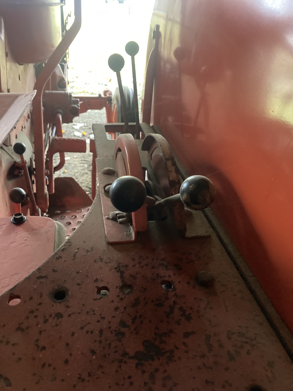

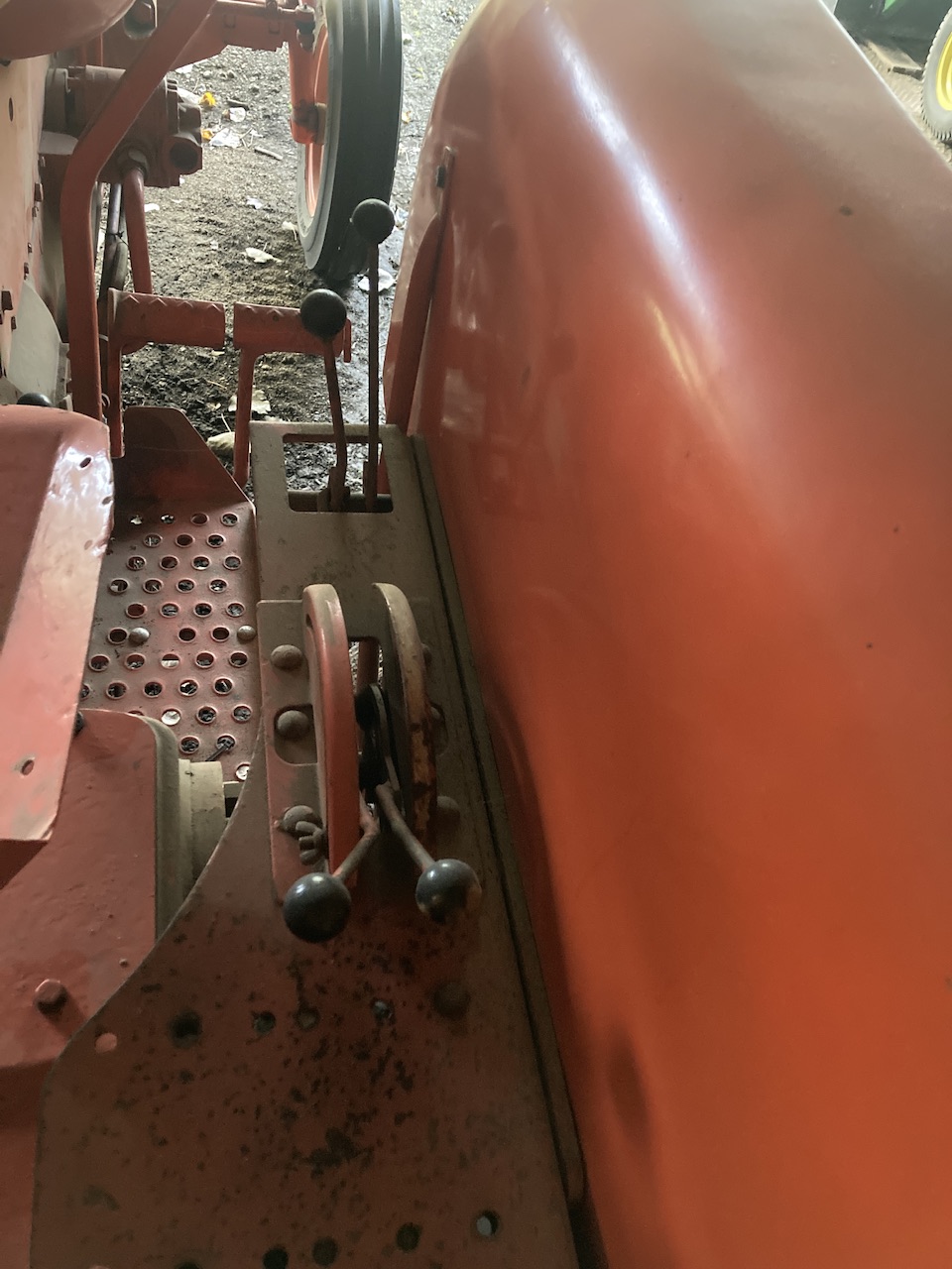

Post Options Post Options   Thanks (0) Thanks(0)   Quote RedHeeler79 Quote  Post ReplyReply Direct Link To This Post Posted: 28 Oct 2023 at 1:31pm
Look like this:

Post Options Post Options   Thanks (0) Thanks(0)   Quote RedHeeler79 Quote  Post ReplyReply Direct Link To This Post Posted: 28 Oct 2023 at 4:38pm
The above pics are a snap coupler tractor
