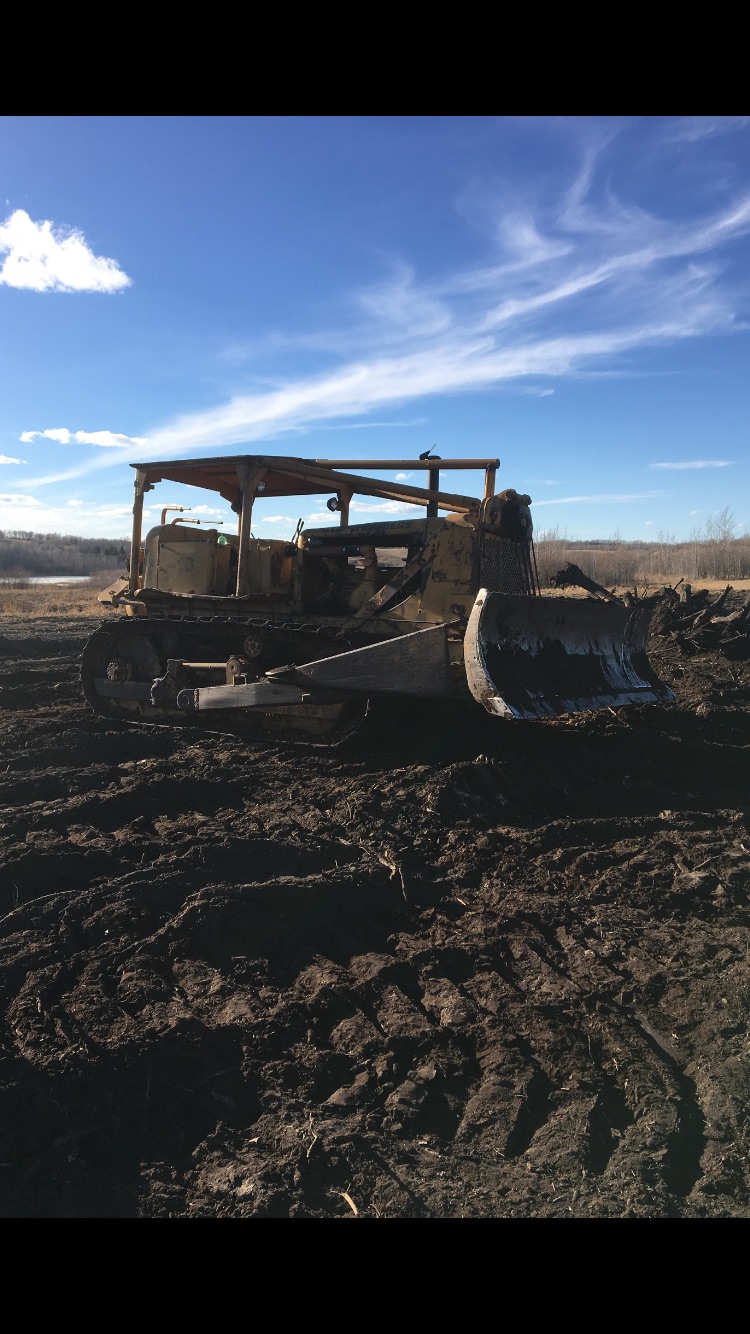

Post Options Post Options   Thanks (0) Thanks(0)   Quote Stewart Quote  Post ReplyReply Direct Link To This Post Posted: 02 Aug 2024 at 9:56pm
I use a Hd16 around the farm that is powered by a Detroit 671 , the hole through the hood where the exhaust used to come through had a rough patch welded in , made me think right away it wasn’t the original engine. The old girl can sure push dirt . Need good bearing protection or you’d be deaf in no time .
