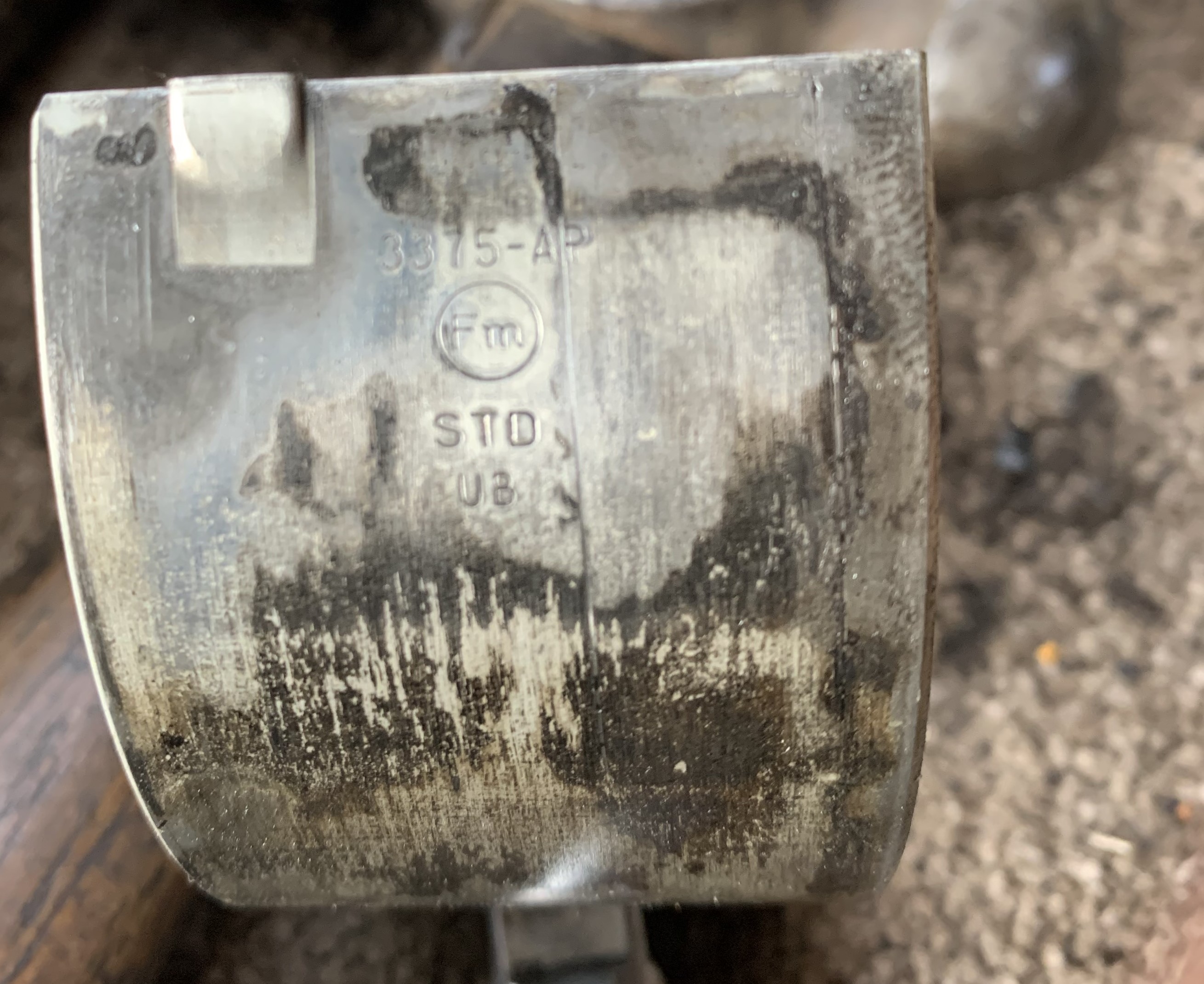

Have apart bearing spun on top of other have photos just not sure on the best way to post on here

Std
bearings

std

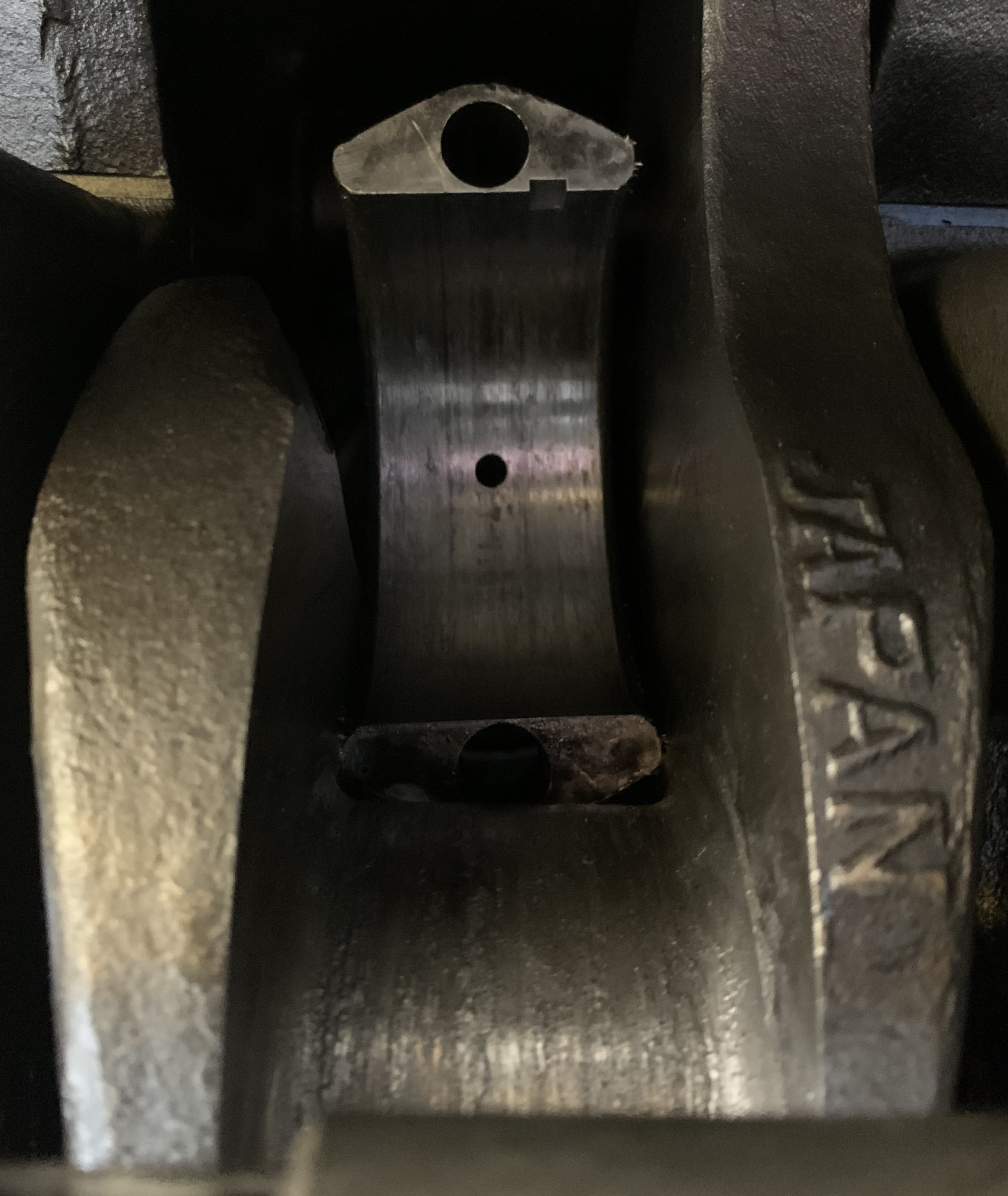

Has any one got any thoughts looking at the crank shaft you would have to agree its pretty bad funny thing is not a lot of heat on rod ends or backings hmmm has any one been here before ? Is the metal on the crank just soft metal and if polished off crank may be ok? Its the Japan crank which i was surprised with i thought my model still had the usa crank geee i should give up but i keep thinking how good it was when using in the past any thoughts criticism welcome

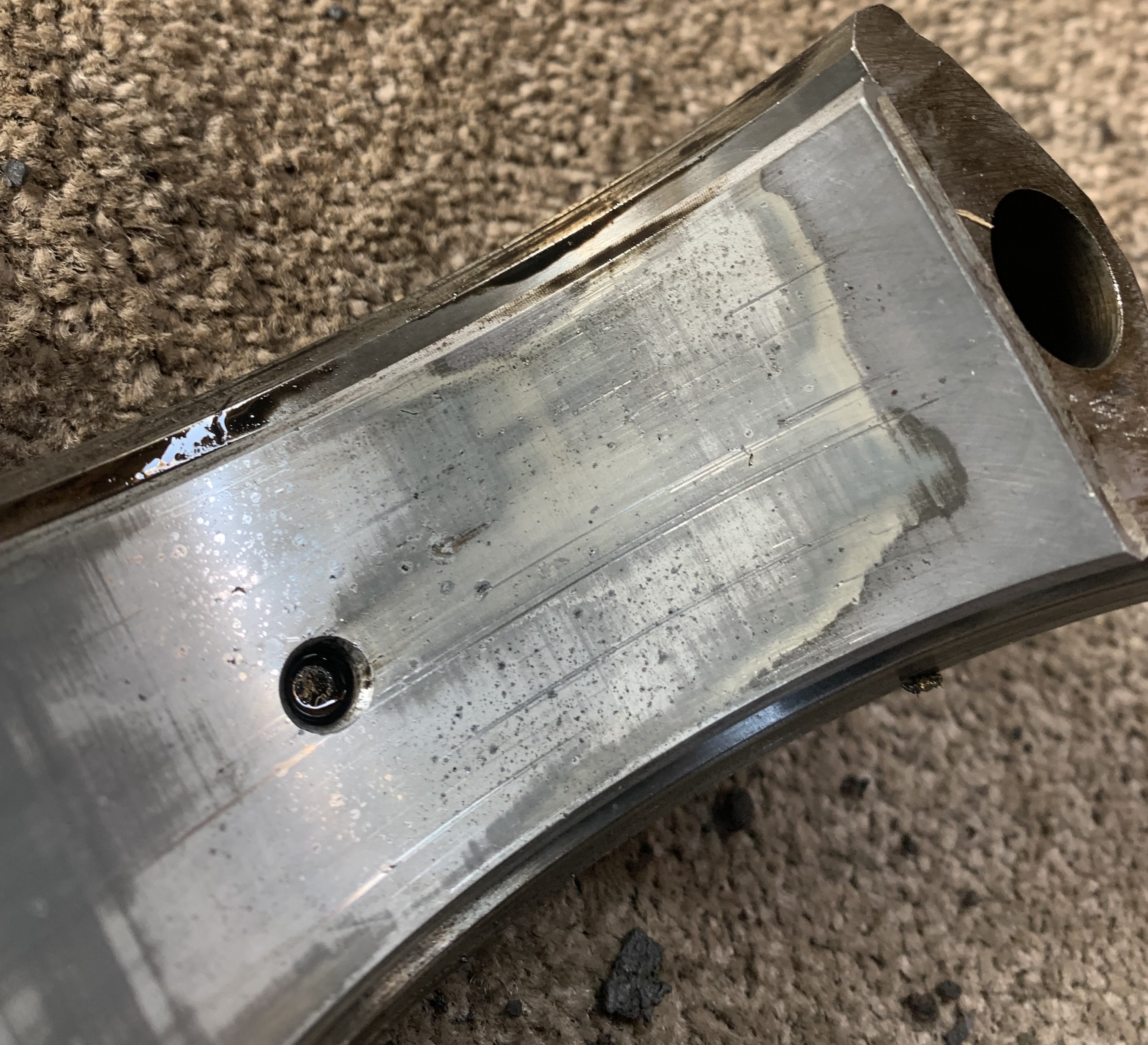

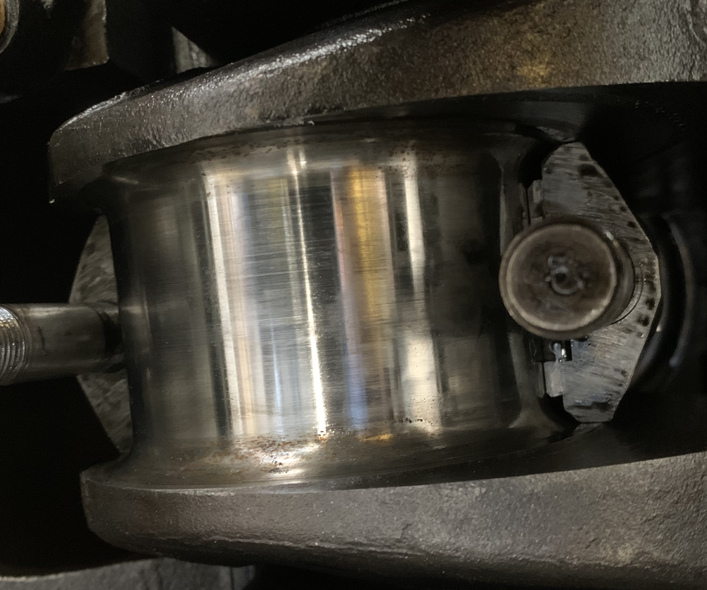

Ok Russell; The engine may need to be removed for repairs. However to ensure the crankshaft will require regrinding it needs measured up before going much further. I would take an inch wide and 18' length piece of emery cloth strip and after rotating the crankpin, (journal) to the bottom of it's stroke and pushing the rod away for clearance, polish that journal with the abrasive pulling the emery cloth fully around the journal each way using your hands. Usually the soft babbit, antimony, and copper based materials will easily remove with the cloth. You will than need to clean that journal using a clean, lint free cloth. Using an outside micrometer measure the journal top and bottom, and side to side at perpendicular axis to one another. This will tell you if the journal is out of round. Any more than about a .001" - .0015 out of round and the engine probably won't hold a bearing very long. If the journal is out of round, you can wager the rod is also and probably worse. These most times can be repaired also, but it requires cutting the cap and resizing the rod journal end to correct dimensions.
If it were me, I'd clean that journal up best possible with engine in the tractor, get a good measurement and ascertain this part before going further. If proven satisfactory for both dimension, and out of round, then rotate the crankshaft 90 degrees, and pull the rod and piston down with a wire around it's base, install the rod cap, and measure the interior at 90 degree spacing basically the same as you did the crankshaft journal. If anything is found out of tolerance, the engine will need further repair.
Given the scuffing I see on the other bearing shell you posted, the engine could use a "freshening" which is easy in the grand scheme of things. Citing the engine still has standard sized journals is in your favor for economical repairs, (relatively speaking).
I'm interested in what you find out with the measurements. Keep the sump mounted back up onto the engine to preclude any rusting from the humidity in the air too along with catching airborne dirt.

Thanks for the reply Do you have a suggestion for the grade of emery paper to use i have plenty here but its pretty course i think its about 120 grit . I will have a look at my micrometres i have here im not sure i have one the right size you would kind of think with the bearing halves stuck together that the conrod would have to be out of round but like you said start with the crank. Do  you know  or would some one else know if its a big job to get engine out of the dozer ? can you remove engine with out removing radiator

I typically use 320 Emery cloth when polishing journals. Also use a light machine oil and polish just till a clean surface. I expect you will need another connecting rod but am always conservative on the internet with suggestions as to not paint "doom and gloom" which is so prevalent. I think if the crank journal is found to be good, you can pull cylinder head #1, install a bolt and clipped washer into the block deck to ensure the liner doesn't push out of the block while you push the piston and rod out from the bottom to renew the connecting rod. Hopefully the prognosis is good once the crankshaft is measured up. Many times a rod can be resized, but many times not.
I wouldn't attempt to pull the engine with the hard nose and radiator in place myself as it needs to move forward to clear encumbrances to remove. Usually best to lift a little and pull more from the front than straight up. A wheel loader, or crawler loader is a good tool to use for the lifting as everything is heavy. Hopefully you can do an inframe rebuild and all be good. Regardless it will be much easier to work with if the blade and push beams are removed.

Had a couple hours spare yesterday started to emery crank shaft i spent probably a hour or so but did not make a lot of progress still plenty of white metal on the crank shaft is this normal? using 320 grit paper wondering if i am doing somthing wrong or its just one of those jobs that will take lots of time
cheers

You could start with 240grit but it will scratch deep if aggressive. That bearing has been very hot to be adhered so tightly. Not what I consider abnormal as the appearance from your other bearing shells reveals oil starvation.

I know Codger has you well covered, I'm encouraged by the one picture of the journal. Measuring the journal with a calliper will be important. What I would add is using plastigauge if you manage to get a hold of a new set of bearing shells. Even if the clearances are critical it may do for an OK bandaid for your dozer. You would need to determine that your rod is acceptable without resizing and yet if that would be a game changer it's worth pulling the head and that one piston. This may be somewhat of a gamble but it wouldn't have to cost you much money...
