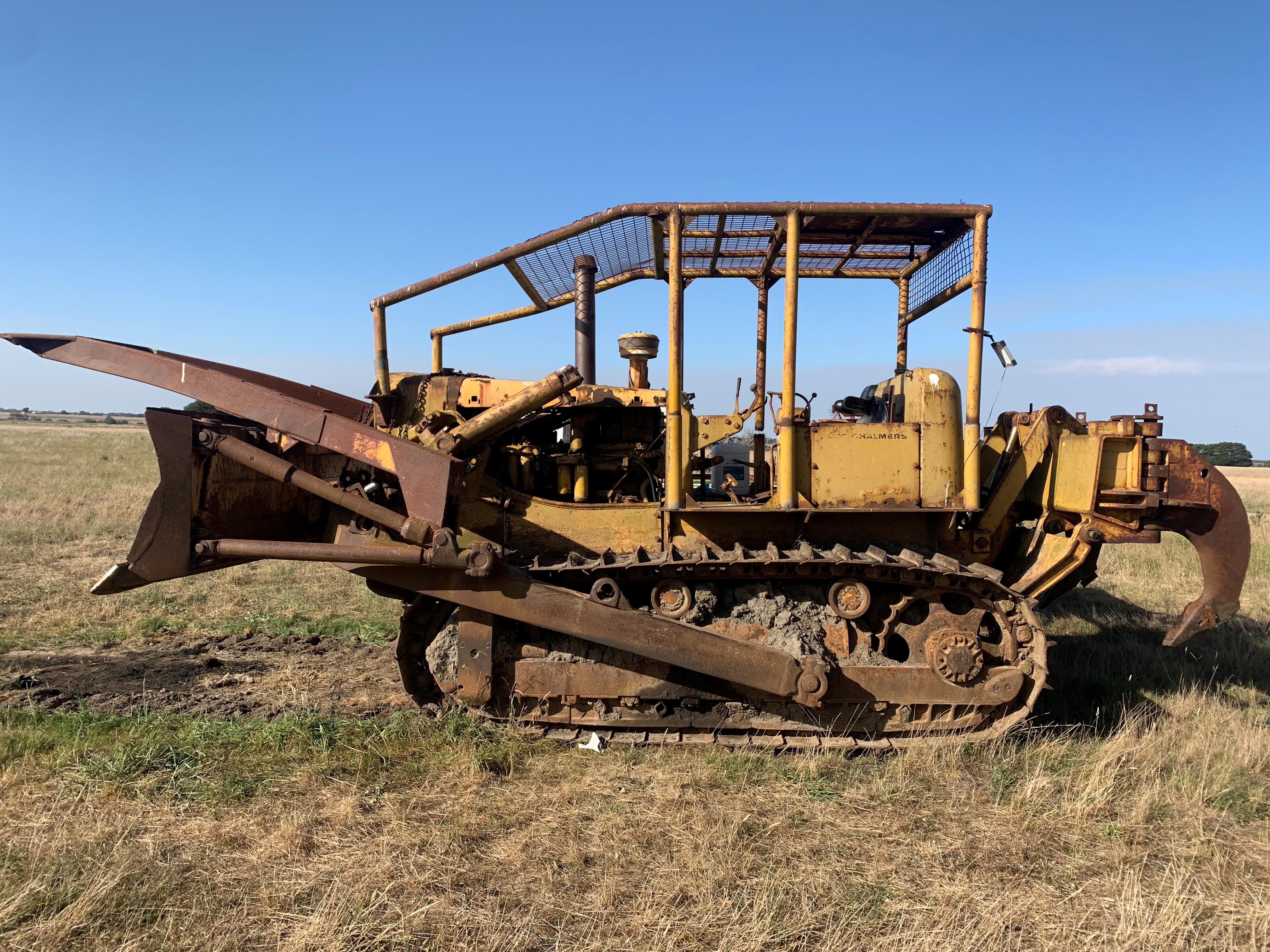

Here is a pic of my dozer I put some batterys in today with mixed luck it turned over a bit then had to click on starter a few times to get it past tight spot it seems  then it would turn some more then same again at one stage it turned like normal but only one revolution its hard to hear any noises might have herd a clink sound thats it really im grumpy with it there is a bit of oil or fuel stain under exhaust manifold cylinder 5 and 6 i have not noticed that before had the batterys in and jumper leads as well so plenty of juce cables got hot im lost i guess if you were just to look today you would say flat batterys or bad starter but with what happened earlier the tappet sound and stalling theres somthing not right  i have a story to tell about today but not now i was so lucky
thanks
Codger View Drop Down
Joined: 23 Dec 2020
Location: Utopia
Points: 2726
Post Options Post Options   Thanks (1) Thanks(1)   Quote Codger Quote  Post ReplyReply Direct Link To This Post Posted: 13 Feb 2024 at 7:06am
I smallerized the photo so I can see it complete without scrolling around:
This is a copy of your verbiage:
Hi Codger
thanks
Edited by Codger - 13 Feb 2024 at 7:08am

By the sounds of your writing I cannot rule out the starter, or something in it's path. You could have a tooth or two knocked out of the flywheel ring gear or starter drive, the starter motor itself could be subject to needing repair etc. With the engine rolling over and not either locking up, or hitting a hard stop, I'm feeling the bottom end is probably fairly sound.
I would remove the starter motor and have it a good look over along with any needed repairs. With a helper I would bar that engine around 360 degrees without the starter installed inspecting the ring gear as the engine is rotated. If tight spots are found in the rotation we need to drill down to their cause.
I wouldn't be all that concerned at this point of the leak you noticed. Probably a slightly leaking gasket that seals up when the engine warms. However with the engine cranking over, the injection pump is still pushing fuel into the engine through the injectors, (if working) and this fuel is not being burnt so it remains liquid. It will find the easiest place to leak.
At this writing I'm more concerned about getting the engine to roll around as should. Hopefully you have something rather simple as the root cause and it's not something catastrophic to the tractor. It's difficult to put a lot of $$$ into such an old machine but it if works it will still do a day's work just as good as a much newer one; albeit slower.
I've seen such stupid crap put engines down over the years and I don't give up so easy. The dumbest one I seen was on a Ford pickup that the engine blew and locked up right after clutch replacement. Engine surely was locked up, but not because of the engine. Somebody didn't torque the flywheel retention fasteners and one backed out lodging between the flywheel ring gear, and the flywheel housing. Nothing wrong with the engine at all.

Thanks for your reply's and the reseizing of  the picture hope you liked the dozer . I really cant see it the starter motor as was working fine and the noise in the engine just before it came to a halt im unsure . I did joined the forum for help more minds are better im a bit stubborn . I will take the advice and remove the starter and have a look as advised i would be so happy if this was the problem and would feel a little silly but i will give it a go i am still thinking spun rod bearing . I do appreciate the help and thank you both i will report back when i get the starter sorted

Hi Russell
Yes, I like the dozer and want to see you return it to service. I have an 11-B series and partial to the brand and engineering that built it.
You described a "tapping" in the engine where a rod knocking is much louder. However, that being said, your interpretation may differ from mine. Usually a rod knocking is accompanied by a misfiring engine prior to letting go. If you have a spun rod bearing you quite possibly would have seen metallic "glitter" in the drain oil. Coolant in the oil will commonly cause a bearing to "turn" or shift in it's mounting. This is why I asked about coolant level. With carrying 40psi oil pressure at a low idle and possibly spinning a rod bearing, the engine would have had to have been tired, and/or very high hours yet the lubrication system was doing it's job.
I think it prudent to drop the belly pans and oil sump to get a look internally but attempting to rule out anything ancillary prior to doing that.
