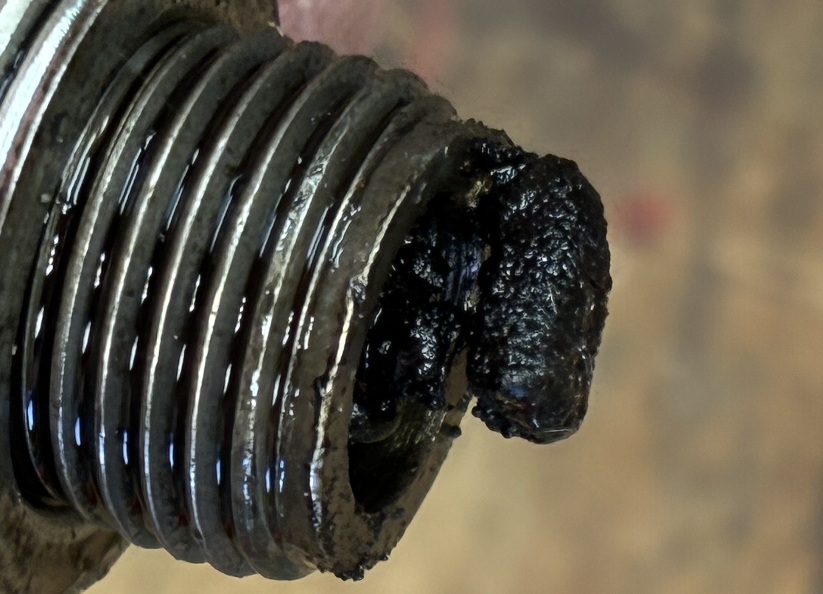

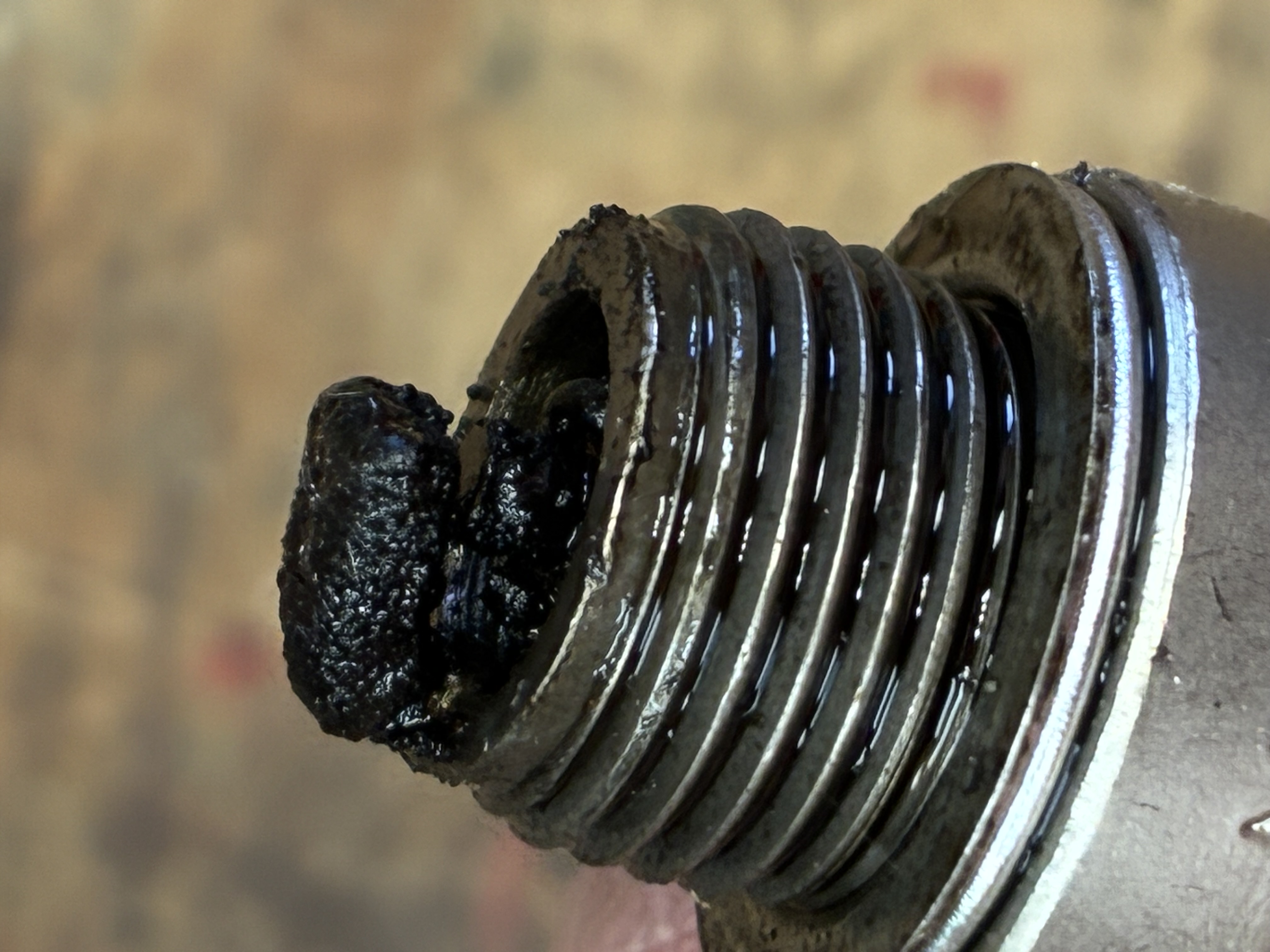

Is this oil or gas fouled? The other 3 are dry black

hard to foul ONE PLUG on gas... buildup sure looks like oil

After all the leaves are chopped up, it’ll be in the shop for a rebuild over the winter.
