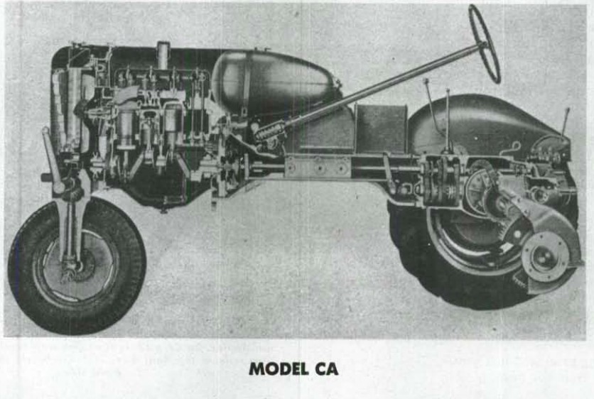

the differential case  has 4  bolts that hold the final drives to each side.. The finals on the B-C are completely vertical to the case... the CA has the final cases turned slightly so the finals tilt BACKWARD somewhat.. giving a longer wheel base..
The troque tubes go by DATE.. The early B and C are identical and have no mounts for the implement... When the CA replaced the C, they added 4 tapped lugs to each side to hold implements under the tractor... at that point the same torque tube was used on the B which was still in production.

Post Options Post Options   Thanks (0) Thanks(0)   Quote steve(ill) Quote  Post ReplyReply Direct Link To This Post Posted: 09 Sep 2026 at 8:08am
you can see the LUGS on the side of the torque tube... and the angle of the final drive mounting.

I just now did a crude tape measurement of my CA and Model C transmissions, the CA 4-speed transmission is a smidge more than 1-1/2" longer than the Model C 3-speed.
The majority of the length increase is from the rearward angle of the final drives.
