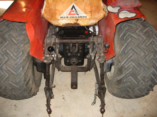

Post Options Post Options   Thanks (0) Thanks(0)   Quote AcFordHawk Quote  Post ReplyReply Direct Link To This Post Posted: 30 Jul 2025 at 10:07pm
How it should look assembled minus the middle third link and sway chains (limit the side to side movement of the lift arms).
