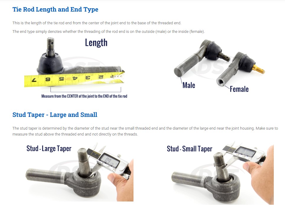

Dave - those are all rod end bearings , the ones used on this tie rod are automotive type and about 1" diameter threads . the stud is a tapered machined surface that wedges into spindle housing

Coke... if the get a couple dimensions, you might match up here..

 Price 92.09 for one side 64.14 for the other - /  After trying to do online interchange on sizes for the taper and coming up blank - well lot of wasted time - should have just called Herc U Lift right out . Same part fits 704 and 705 fork lift steering
