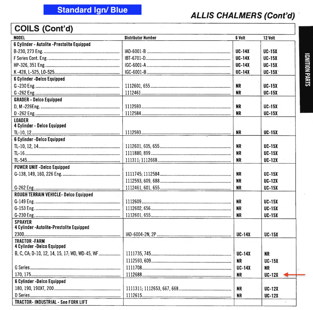

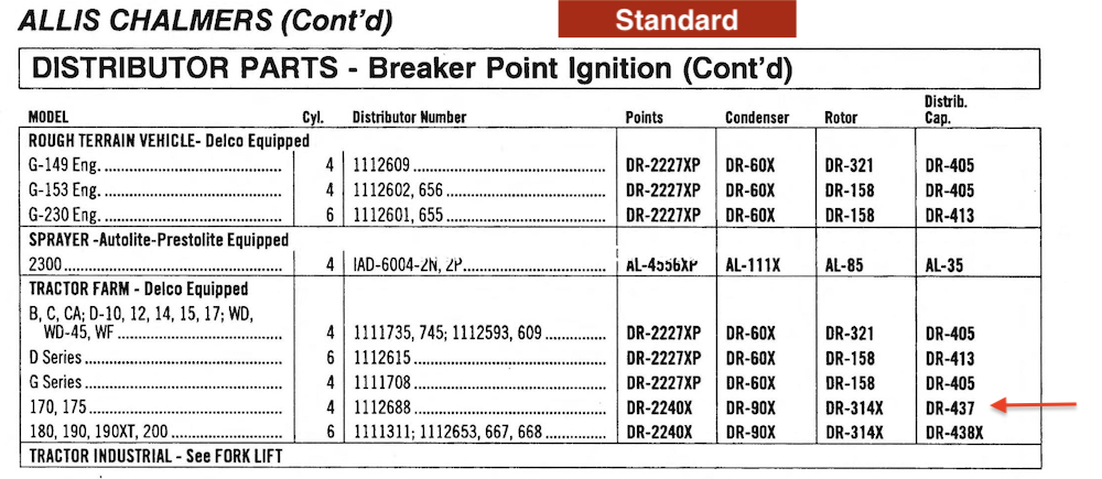

Tracy, these are Standard Ign / Blue Streak

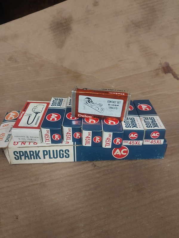

Tracy, if you would like I could fix you up with NOS tune up set. Kenny L.
