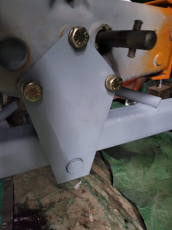

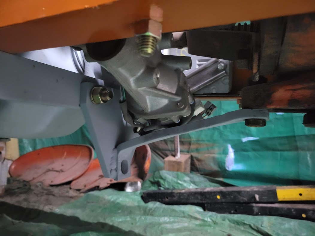

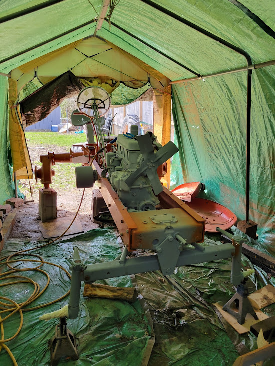

I was able to get the front axle back into the chassis last night with some new mounting hardware. the power steering fits nice above the rear axle mount.

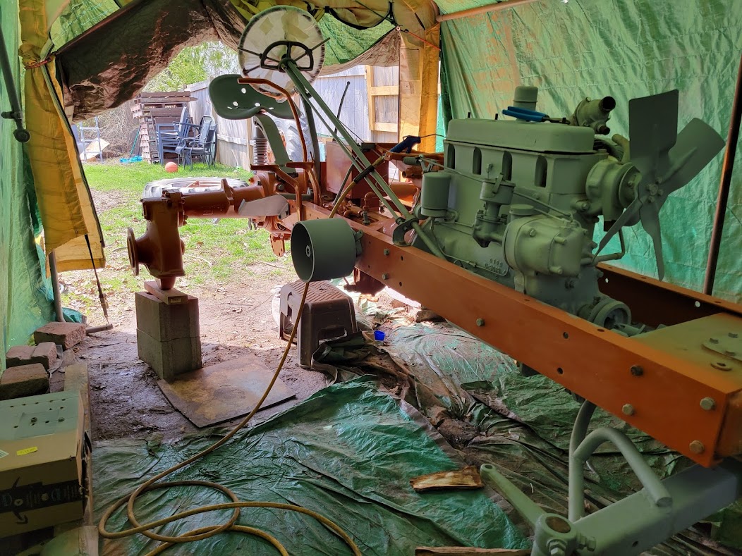

I was able to make some more headway over the easter weekend here.

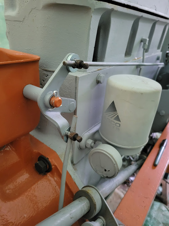

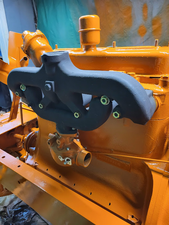

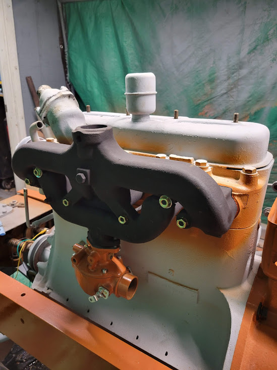

Exhaust manifold installed as well as carb loosely installed to check some other functions.

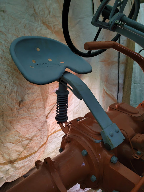

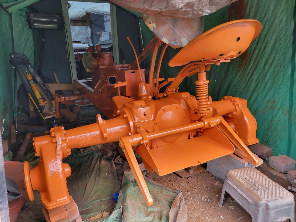

Seat also repaired and primered. I took the seat spring apart to clean and primer. I also installed new spring bushings

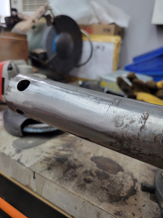

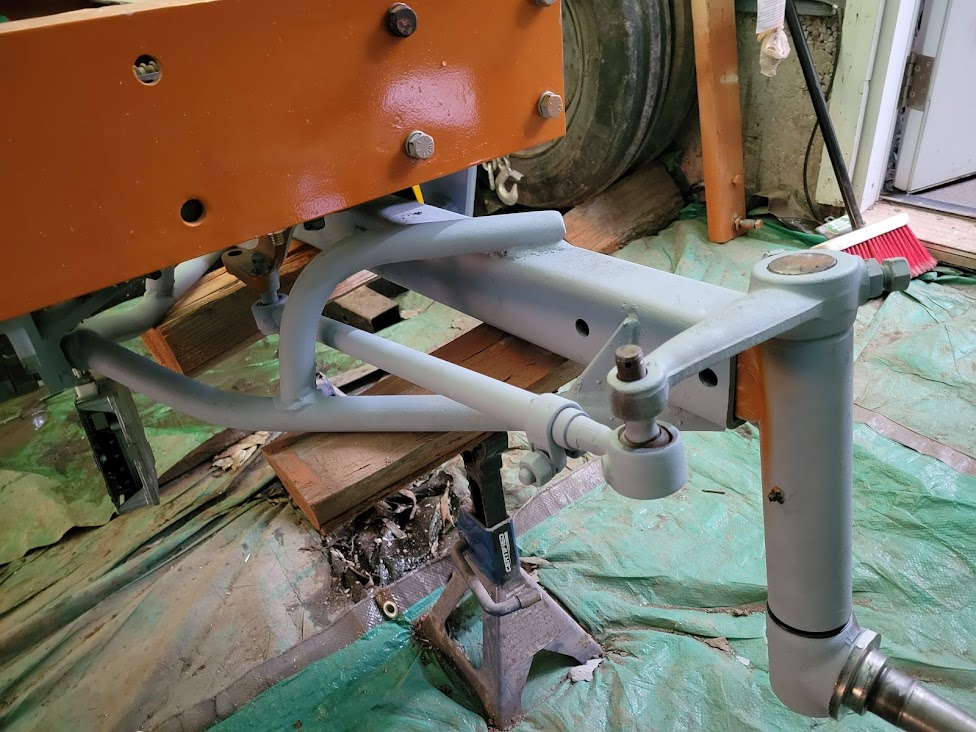

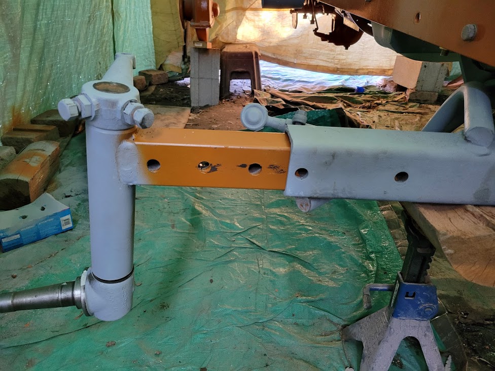

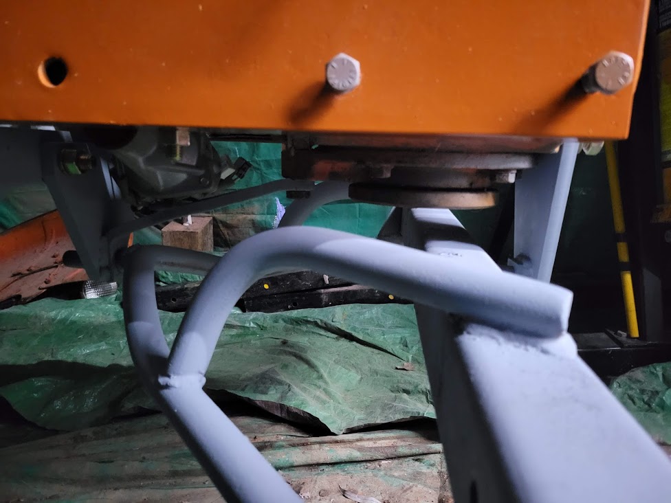

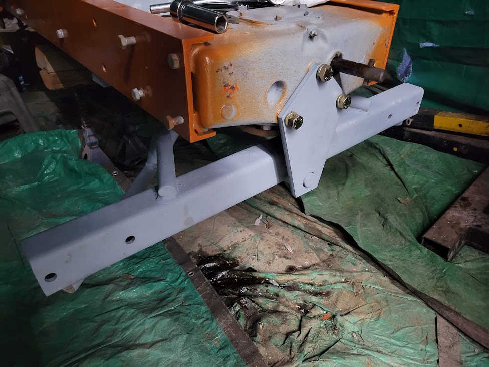

I also got the front end apart and new bushings installed, I had to repair the spindles to fit correctly without slop. These are the final photos
I also rebuilt the throttle linkage and installed onto the tractor.

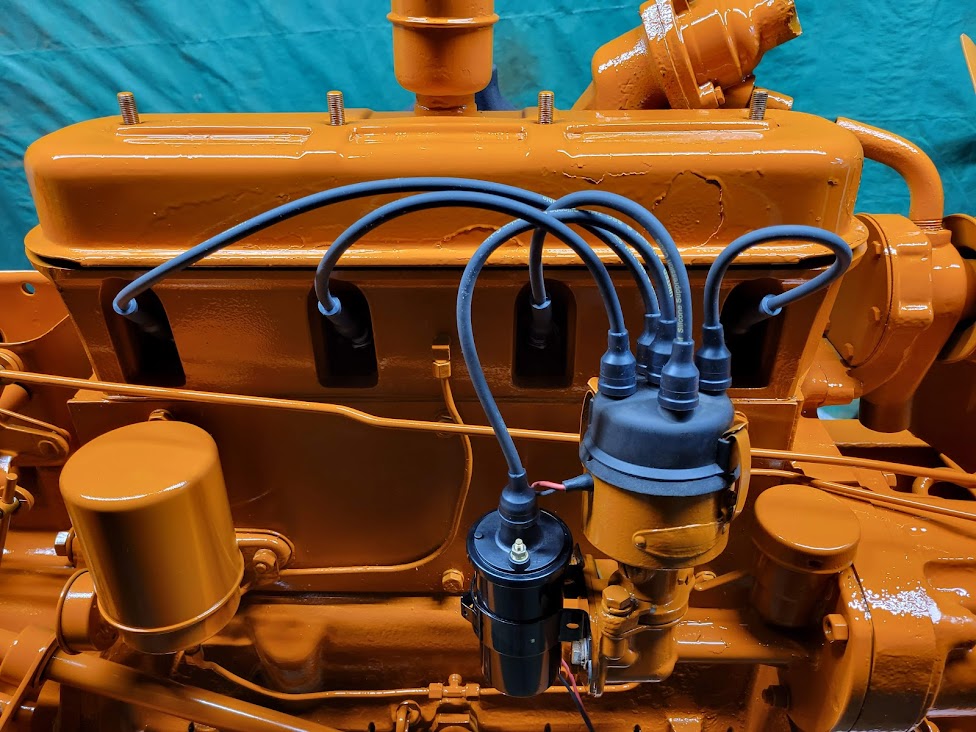

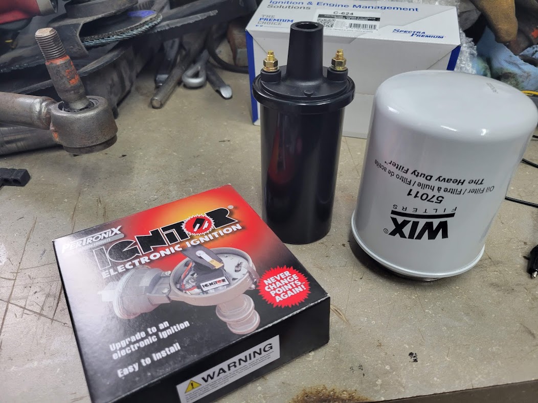

Some more parts have arrived! oil filter, ignition coil and Pertonix ignition 12V negative ground setup.
I also picked up some engine oil and filled the engine up, pertronix is installed but not wired, I have valves to adjust tonight and do some more spindle work or the left steering spindle. once that is complete we will be very close to paint for the remainder of the pieces of the chassis. Hoping for the whole running chassis to be painted orange by the beginning of next week!

You're making a lot of progress!
I swapped over my WD original-style manifold today for the newer WD45 manifold like you have. About to button up the carb and there was no space for the original carb bolts. So I had to stop and go get new studs so I won't have it fired back up until tomorrow.
Definitely a bit tight on that manifold! i had to cut mine to fit as well.

 It is coming along very nicely! You have the large tension spring for the throttle linkage?
Reworking the vertical steering shafts will help it steer like a new one. I did some similar things to our WD, and it steers very nice now! Your power steering system is very cool. Nice job engineering and fabricating the attachment hardware!
My old brain cant hardly get around that but your make it look easy.

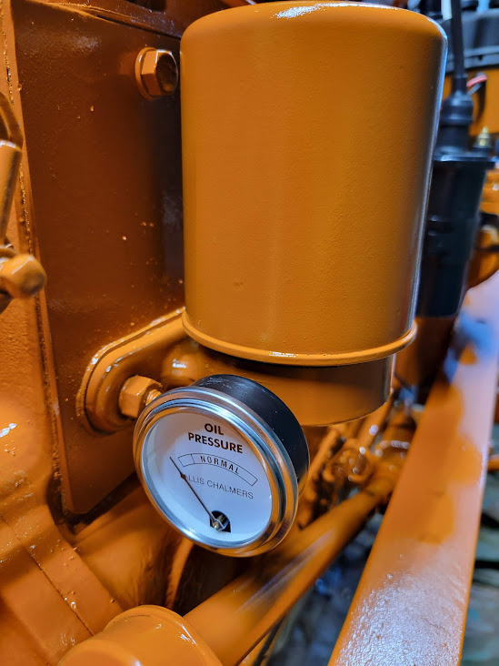

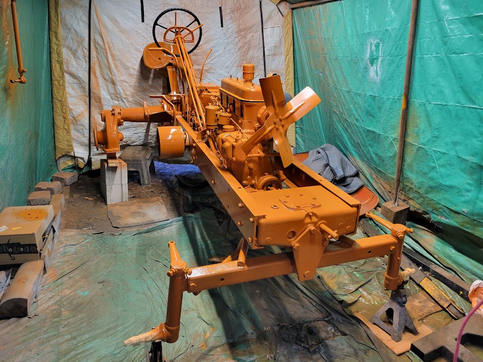

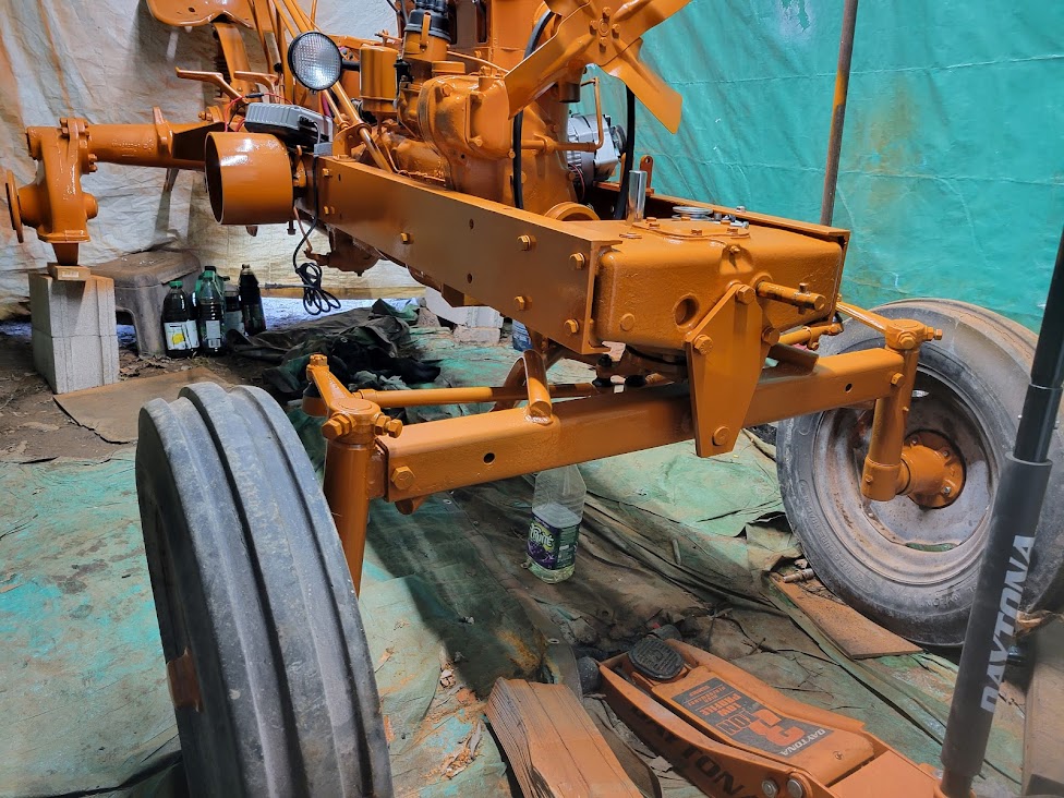

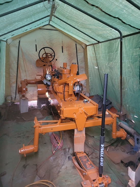

Yesterday was a very progressive day. The warm Temps allowed me to complete the majority of the items i wanted to. I prepped for paint by finishing some loose ends and getting cotter pins back into certain areas as well as some missing bolts.

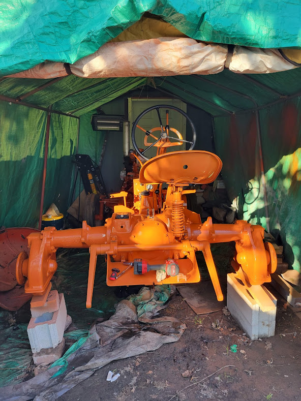

here is the tractor prior to painting
After 2 coats of paint, this is what Allie looked like
After the 2 coats, I touched up a couple areas with a 3rd coat.

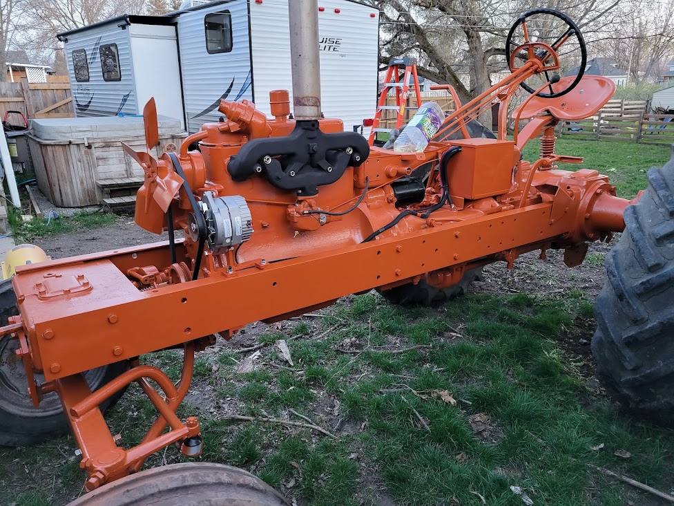

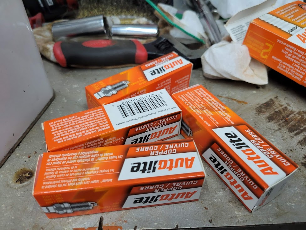

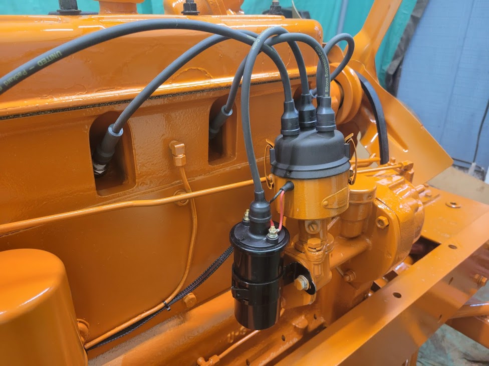

after the hardener started its magic, I was able to put some new spark plugs and ignition wires into place. along with a pertonix ignition kit and new coil
Exhaust manifold and carburetor looking good in place!

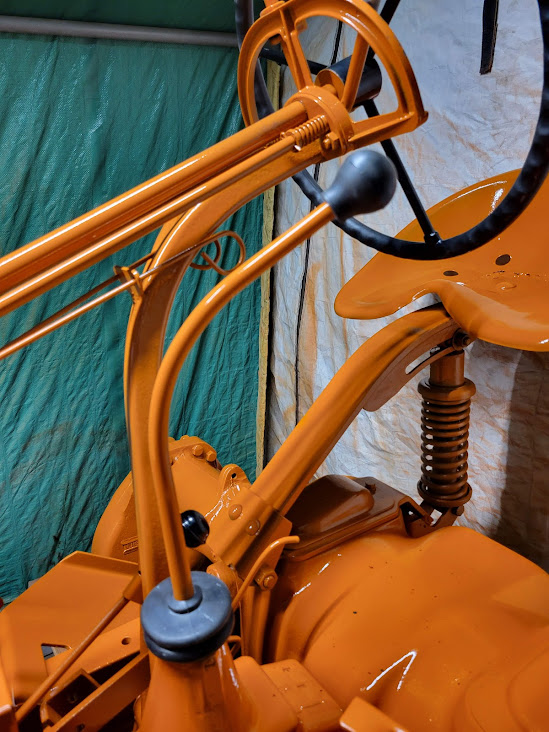

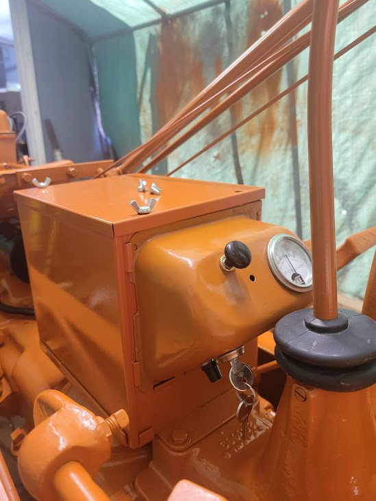

I also got the shifter boot and knob into place. I was really looking forward to installing that shifter boot. It was one of the first parts i purchased! its been a long wait but it finally found its home.
And the new oil pressure gauge.

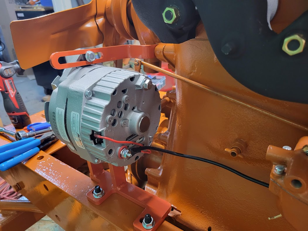

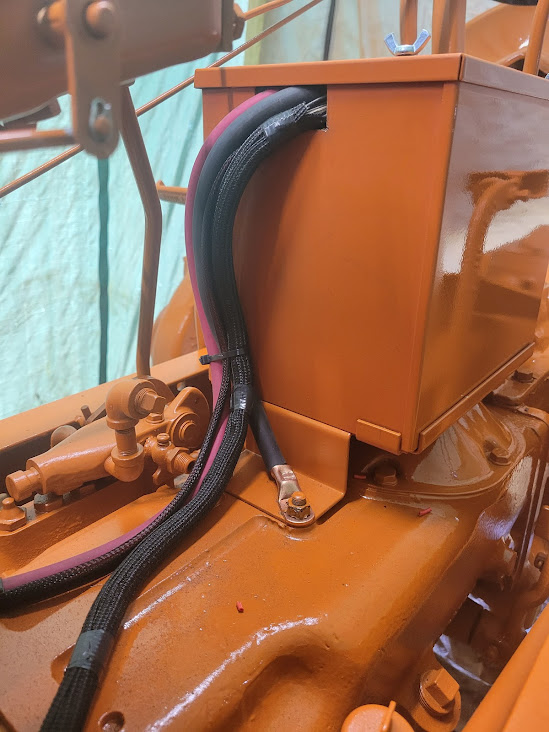

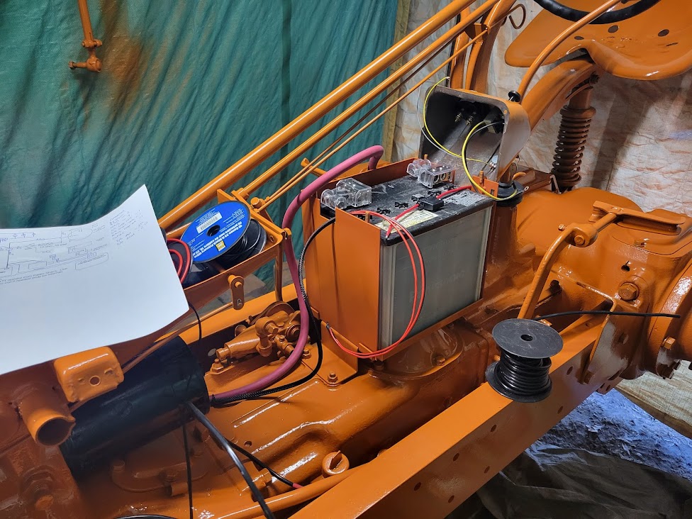

Got a couple rolls of wire in to wire up the tractor. I have my wiring diagram ready and a new alternator on it's way. Should be ready to wire this one up tomorrow and prepare for it's first start!

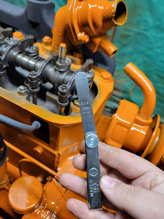

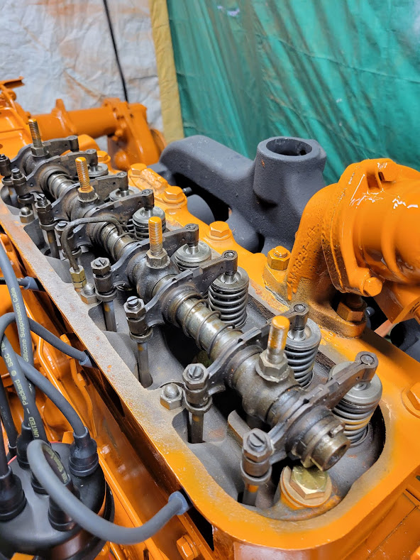

Valve adjustment also completed. set to 0.014" as per some of the guides on this forum. Of course i will need to double check for valve adjustment when hot, this is a good starting point on a cold engine.

made some considerable progress over the weekend.

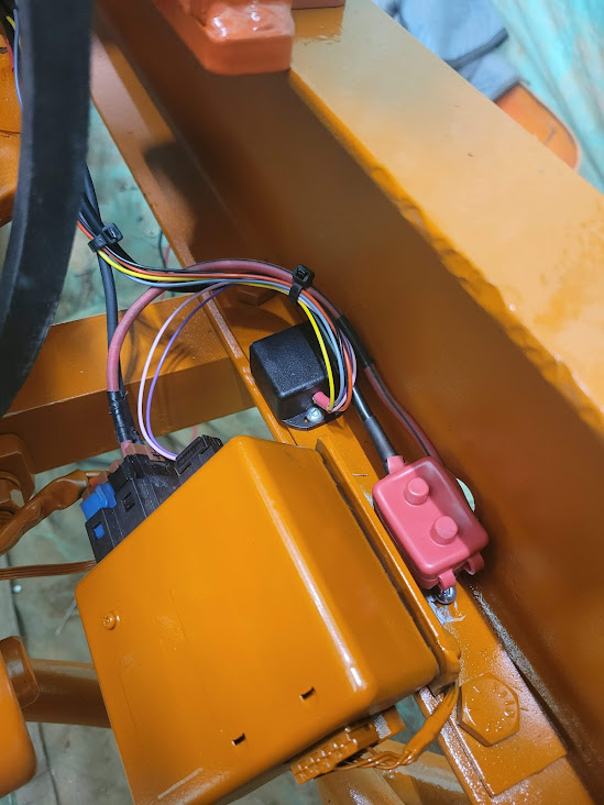

Got the wiring completed friday night into saturday - lots of wires to the front of the tractor. mainly for the alternator and the power steering.
Here was all the wire loomed up and tucked away. I think i genuinely used just over 65 ft of wire total..
I also got the console in placeand ammeter wiring correct. Looks good to me!
I then installed the front hubs with new bearings. packed and ready to go now.
And the front wheels were put back on to make it mobile. It was also a good test for the power steering unit. It works amazing.
I also fired up the tractor for the first time. After having to reposition the distributor (180* out) it fired right up. Ran very good as well. I also changed all fluids and refilled with Hytrans.

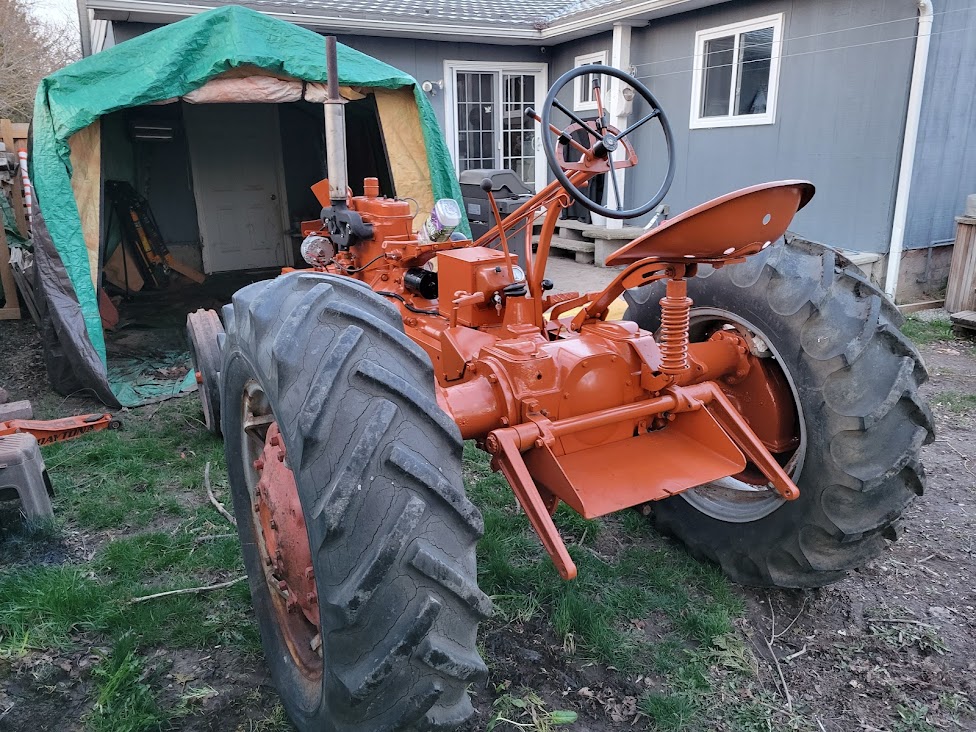

Well, The tractor runs on its own wheels. those were HEAVY! they are loaded...
but, The tractor moves on its own wheels, back and fourth, runs well considering. Lots of little work left to do but making some progress!
brake adjustment here in progress.
And out of the shed on its own power. check out that nice juice bottle for a fuel tank!

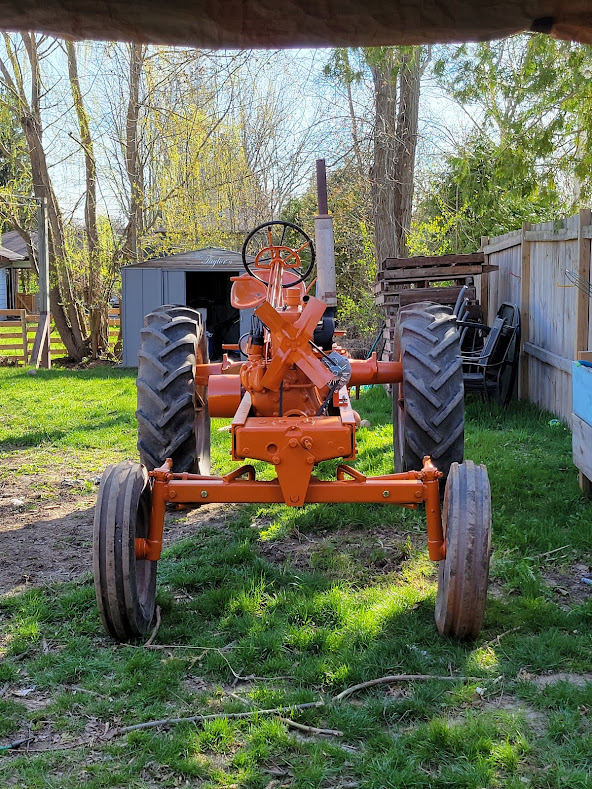

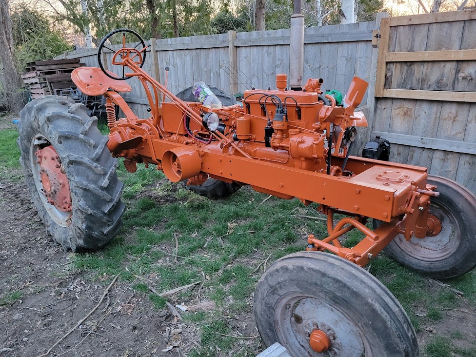

Was able to get the tractor outside this weekend for some sunshine! Just plugging away on the air cleaner fabrication as well as a few other odds and ends.

Nice work, goes to show you don't have to have a fancy shop to turn out nice work.

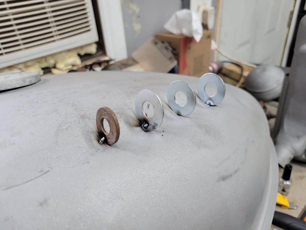

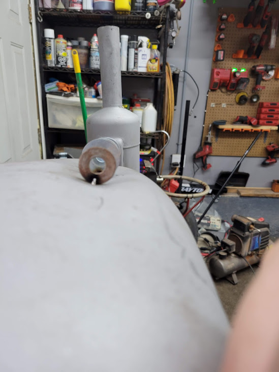

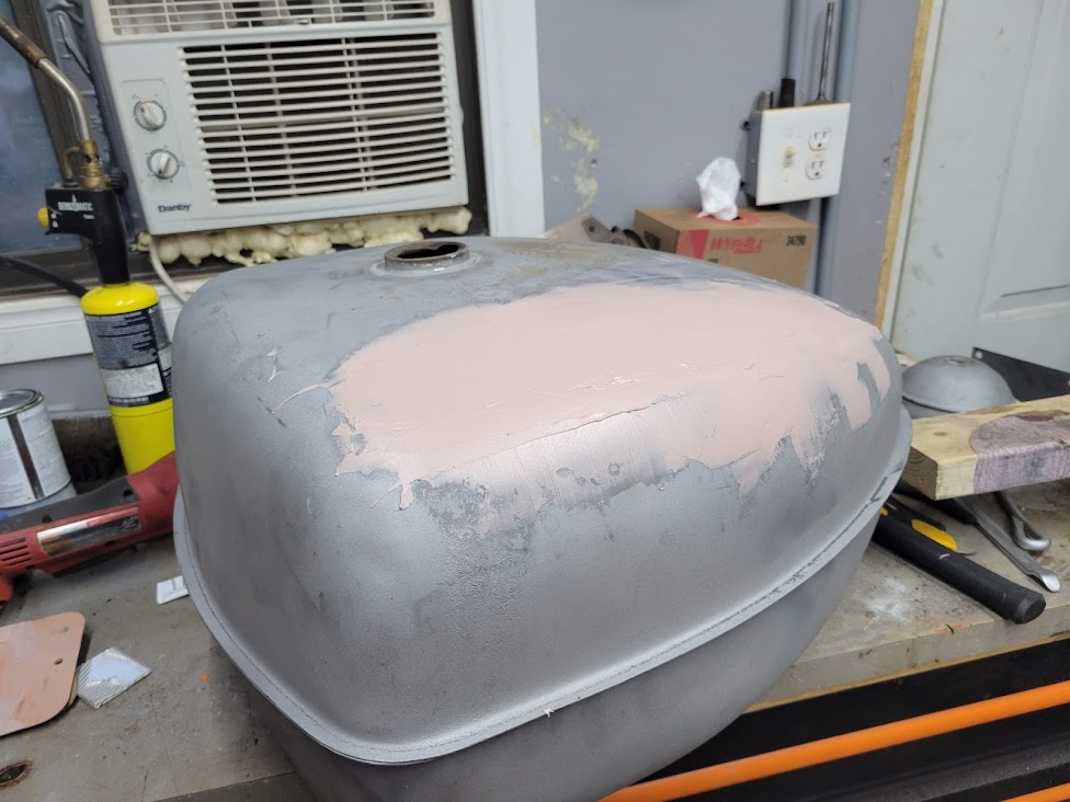

I worked on the fuel tank a bit over the weekend. I was able to get the large dent slide hammered out and body filled. will be a good looking tank when finished up..

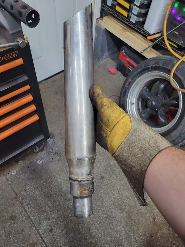

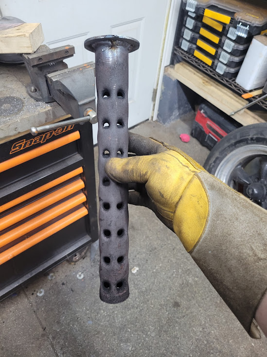

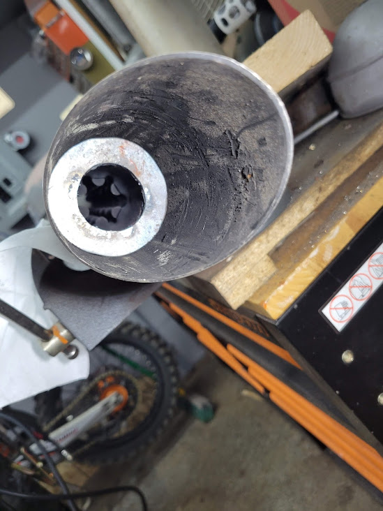

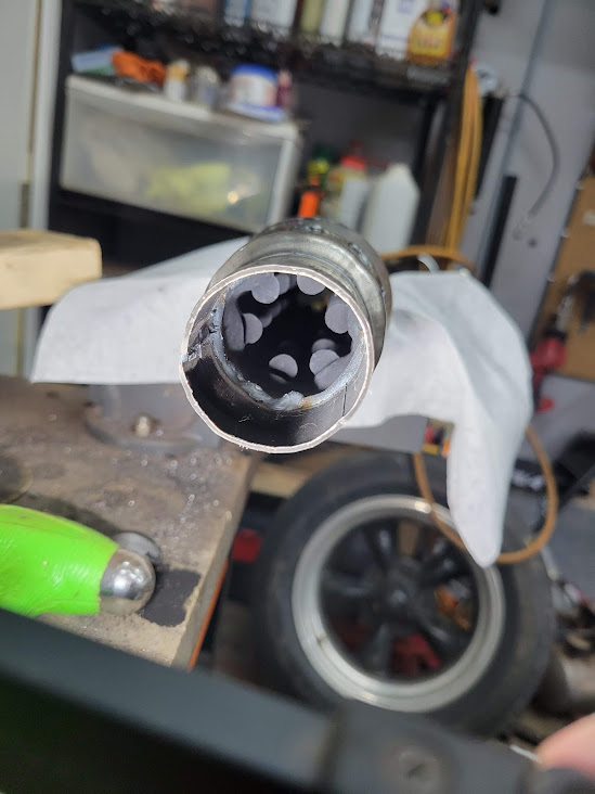

I also have wanted to put this exhaust pipe onto the tractor since day one. The only trouble was, That the exhaust was a straight pipe and it sounded horrible..
So, I took apart my rotten Stanley muffler and essentially repacked mine with Stanley bits and pieces. Fabricated a top plate to hold it in place and welded it on the bottom side.  Now i have a quiet muffled straight pipe! it works very well!.

Those are neat ideas. I have a tank of another color with a similar problem. Was gonna buy a stud welder but those washers could save the day.
Points: 4454
Post Options Post Options   Thanks (0) Thanks(0)   Quote IBWD MIke Quote  Post ReplyReply Direct Link To This Post Posted: 31 May 2022 at 6:58am
I'm with you on the sound of a straight pipe. Never cared for it. Your mod would help I'm sure.
It was pretty amazing how much of a change it adds to the exhaust. It works very well.
