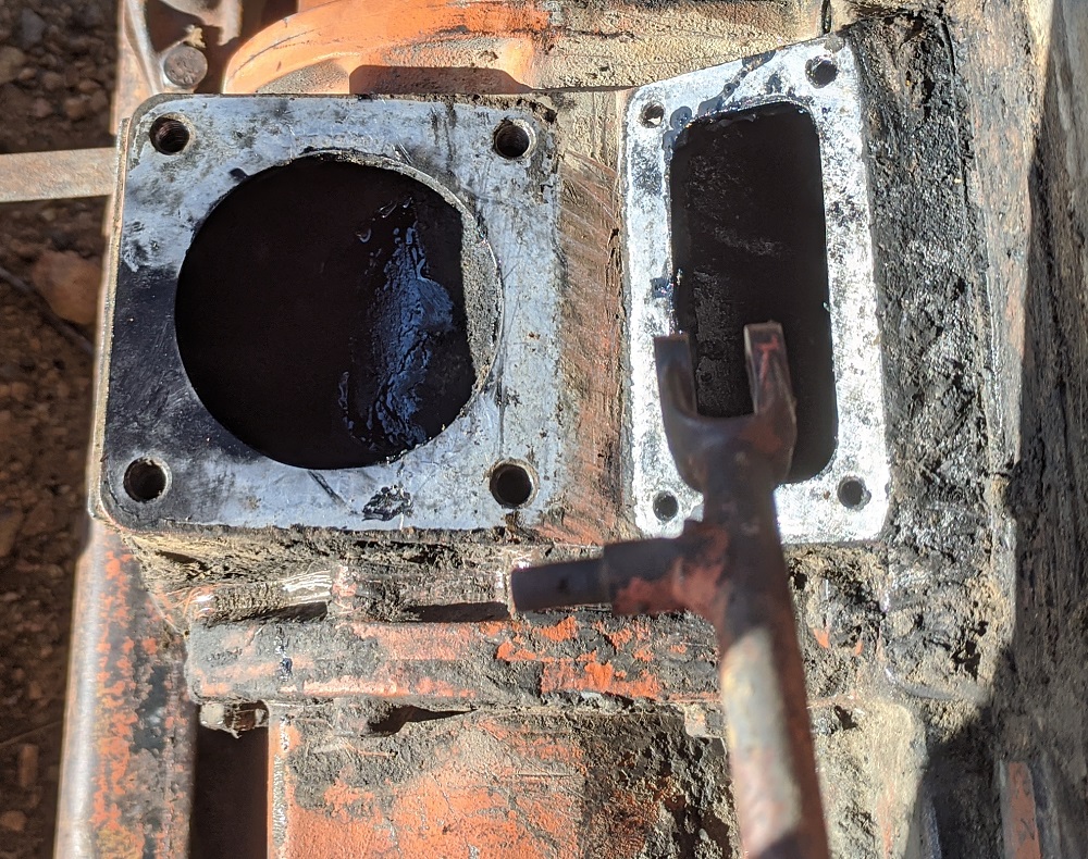

I have removed the governor and air pipe, ready to extricate blower.  I don't know where or if to split it at the central assembly or does it all get removed to the front of the engine.  I better not screw this up.  What do you think?  Thanks

Post Options Post Options   Thanks (0) Thanks(0)   Quote dadsdozerhd5b Quote  Post ReplyReply Direct Link To This Post Posted: 08 Jan 2020 at 1:14pm
Once the intake pipe is removed look at the blower lobes when cranking and see if they are spinning. If so it is not the blower. If not then you have some kind of issue. I have not personally had a blower off but I believe it comes off as an assembly.

Post Options Post Options   Thanks (0) Thanks(0)   Quote WaltDevore Quote  Post ReplyReply Direct Link To This Post Posted: 08 Jan 2020 at 5:17pm

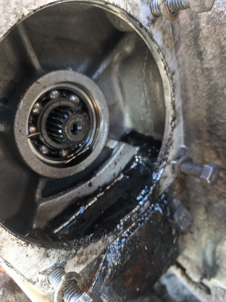

Looks like solid pieces in there.  Do they rotate?  I have no jumper cables right now so can't turn the engine over.  If this rear shaft rotates, will that indicate the blower is good?

Post Options Post Options   Thanks (0) Thanks(0)   Quote WaltDevore Quote  Post ReplyReply Direct Link To This Post Posted: 08 Jan 2020 at 5:19pm
If this shaft is rotating, will that indicate the blower is functional?
Points: 56151
Post Options Post Options   Thanks (0) Thanks(0)   Quote DiyDave Quote  Post ReplyReply Direct Link To This Post Posted: 08 Jan 2020 at 5:27pm
Looks like you have busted splines or some other foreign material, laying against the bearing.  Maybe its an oil reflection, IDK...Wink

Post Options Post Options   Thanks (0) Thanks(0)   Quote WaltDevore Quote  Post ReplyReply Direct Link To This Post Posted: 08 Jan 2020 at 5:29pm
It's the wire retainer for the ball bearings I think and a little puddle of oil.  If this shaft doesn't turn, is that a bad blower?

If you can't turn the splined shaft something is not right

Blower sitting on the ground, no governor and nothing else attached should roll with some resistance. Hanging on the engine is still connected to drive coupling. Either corrosion or metal displacement or bad bearing will lock one up, is only .0015 clearance when new lobe to lobe and I did not misplace a 0.

Post Options Post Options   Thanks (0) Thanks(0)   Quote WaltDevore Quote  Post ReplyReply Direct Link To This Post Posted: 09 Jan 2020 at 1:25pm
Well, the shaft rotates with the engine turning over.  I sprayed ether into the air pipe opening and the engine air heater opening.  Zero response.  I guess a compression test is next without the injectors??
