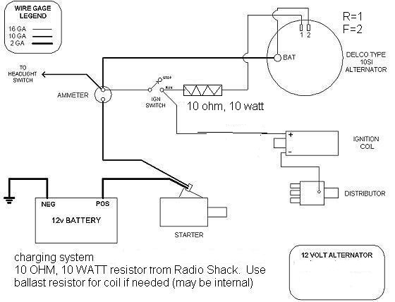

Something like this... you have to figure out the mount and pulley / adjustment is the biggest deal..... Make sure the SPEC says "IR" Internal Regulator... Some dont..

Eric.... something like this ? I agree the double mount makes things easier..
