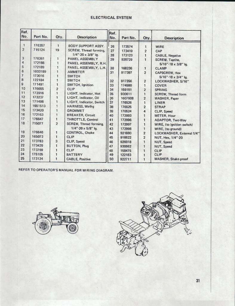

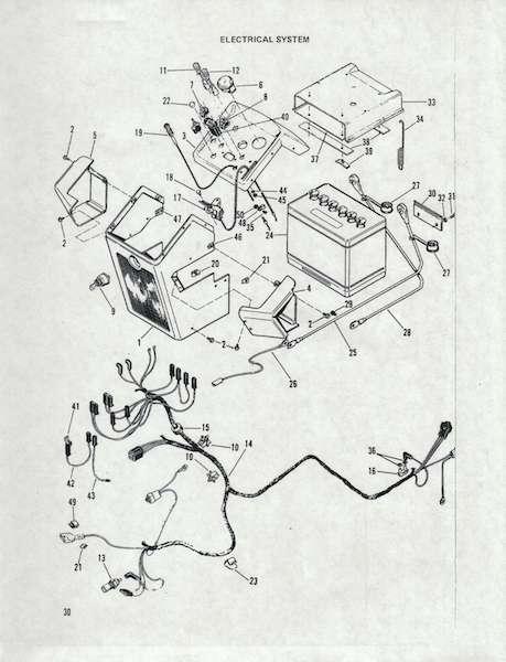

Schematic for the Simplicity versions of the Allis 720, sorry about the size kept trying to reduce and having difficulties copying from the Adobe file.

thanks you guys it will save alot of time
