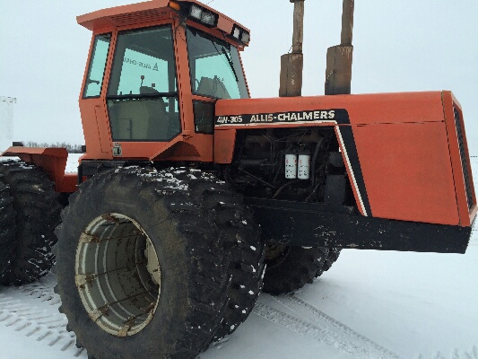

I have seen a couple of the 4W305's with a 855 cummins one at 300hp and the other at 350hp. The swap costs around 20g including a decent 855. If the 6138 was aquired at a reasonable cost there shouldn't be too much else to change to make fit so it could be more cost effective, maybe even keep the twin turbos if the 6120 exhaust manifolds will bolt to the 6138.

I realize this thread is 5 years old but this subject is 40-50 years old so here goes. First to Oldred. Are you the guy that bought my blown 731 in about 1990? IIRC someone from Rimbey bought it and I see you are very close to there. If so I would like to catch up with you sometime and see what you have been up to for the last 30 years! On the subject of the thread, I replaced the 731 with a small cam NTC 350 into my 8550 because of high parts cost from Agco, much better availability of used engines and parts from Cummins, 9 gal/hr with the Cummins vs 14 with the 731, much better starting engine, much better pulling engine, and on and on. I have been extremely happy with the conversion and still own the tractor and could go to work with it this afternoon if needed. I designed and had a local machine shop build a bell housing to mate the Cummins to the AC 24" bolt circle transmission housing. I pieced together a two plate 14" Cummins dish flywheel and modified a Lipe pressure plate with the release fingers removed and added more springs to hold on the 12" Allis friction plates that had the right spline for the input shaft. I know this is going the wrong way for what the discussion is to install this block in a truck, but it could be machined the other way. A couple of years ago there were some interesting threads on this forum about what happened in the Allis head office that allowed a transmission out of a 150 hp 2 wd to wind up in a 300 hp 4wd. I started a thread "did the bean counters take charge" or something like that, and a very smart and interesting guy from high up in AC responded. 427435 who was a regular contributor, and sadly we lost him a couple of years ago, gave a great response that went something like this. AC is bleeding red, no R and D money, stick the 20 speed PD trans into the 8550 and speed it up to 2800 rpm so the torque will be less than 600 ft lbs, put a fuel limiter in the Bosch style fuel pump to cut the fuel under 2500 rpm, even at WOT. All to get a tractor out on the market which has dried up to 1200 units total across all makes and models in the mid eighties. This was the second last attempt to save a dying company. Except for the 305 which was the last and actually turned out to be a pretty good tractor. My 8550 with the NTC350 was and still is, a really good tractor if you do your heavy pulling in 5th gear low range in the drop box and low range in the PD. Straight through the main transmission. I have long believed that AC had a great engine in the 844 made to pull at 18-2100 rpm. Every bit as big and beefy as Cummins or Cat. It would be cool to see what that 844 could do in a truck.

Transaxle,  No I did not buy your 731 engine. I did however come to your farm about 10 years ago and looked at your 8070 that you were selling and then we went and checked out your 8550.
I bought a 4W305 way out by Melfort Sask soon after we chatted and been using it on my JD 9501 PT combine and large rental manure spreader.
