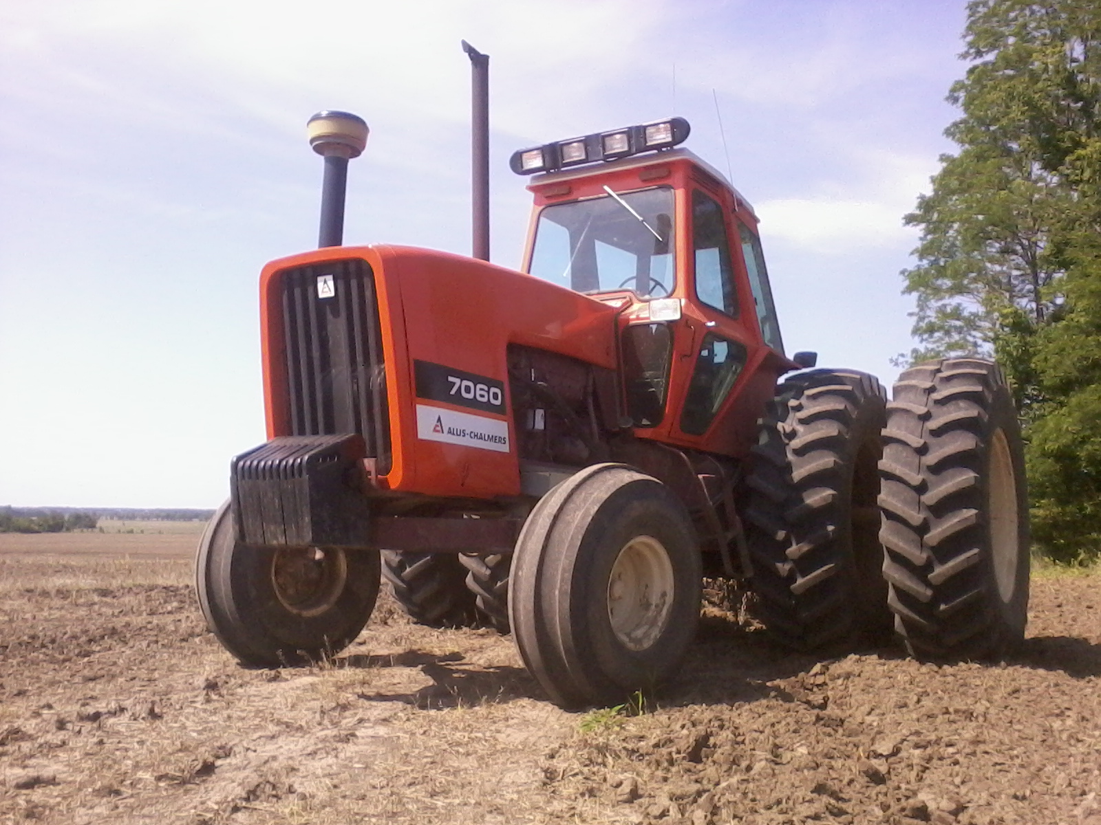

I was thinking about finding a 7580 to use on my 3x3 after this year. I can’t imagine using anything less than the 7060 that’s on it now. Maybe my density’s set too high or my pto clutch is too tight because it lugs every stroke and maybe unrelated but now my torque limiter has a spring rattling it sounds like. I took the duals off so I didn’t ruin my new tires, but now it’s wanting to jackknife me turning down hill and bouncing all over. I can notice the weight shift when the back bale comes off as well. I was going to find a 7580 and take the back duals off. Just be more steps if you have a knotter giving trouble.
