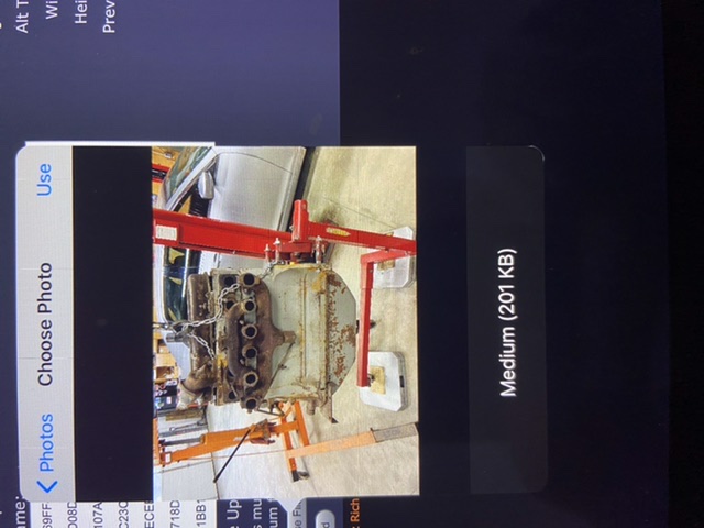

Post Options Post Options   Thanks (0) Thanks(0)   Quote Ed (Ont) Quote  Post ReplyReply Direct Link To This Post Posted: 13 May 2025 at 4:21pm
This is medium size.

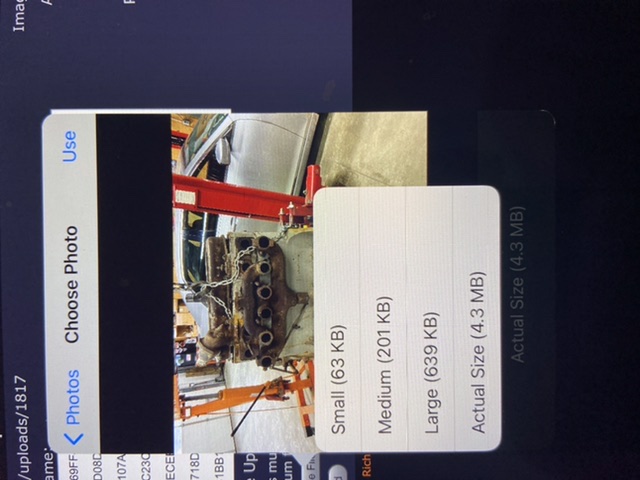

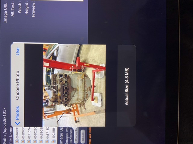

Ed (Ont) View Drop Down
Joined: 08 Nov 2009
Location: New Lowell, Ont
Points: 1657
Post Options Post Options   Thanks (0) Thanks(0)   Quote Ed (Ont) Quote  Post ReplyReply Direct Link To This Post Posted: 13 May 2025 at 4:33pm
Look at top pic. See where it says actual size at bottom of pic. Tap that and it will give you the choices you see in middle pic. Choose medium and use that. I find that I usually try twice to get it to load.
