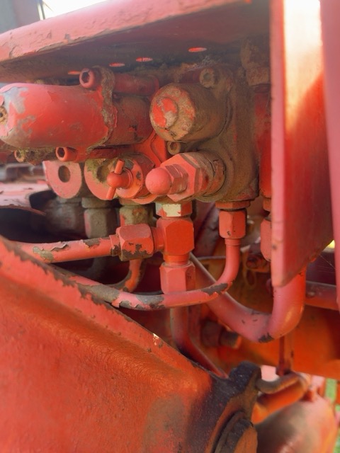

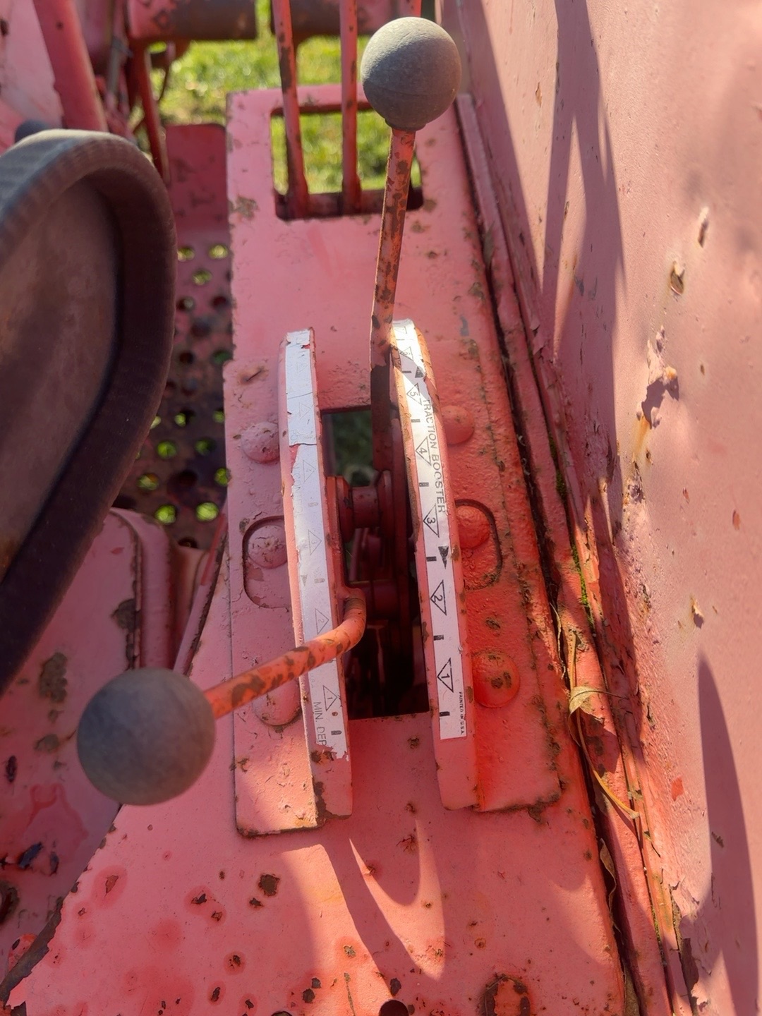

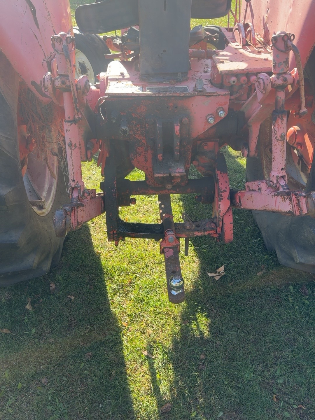

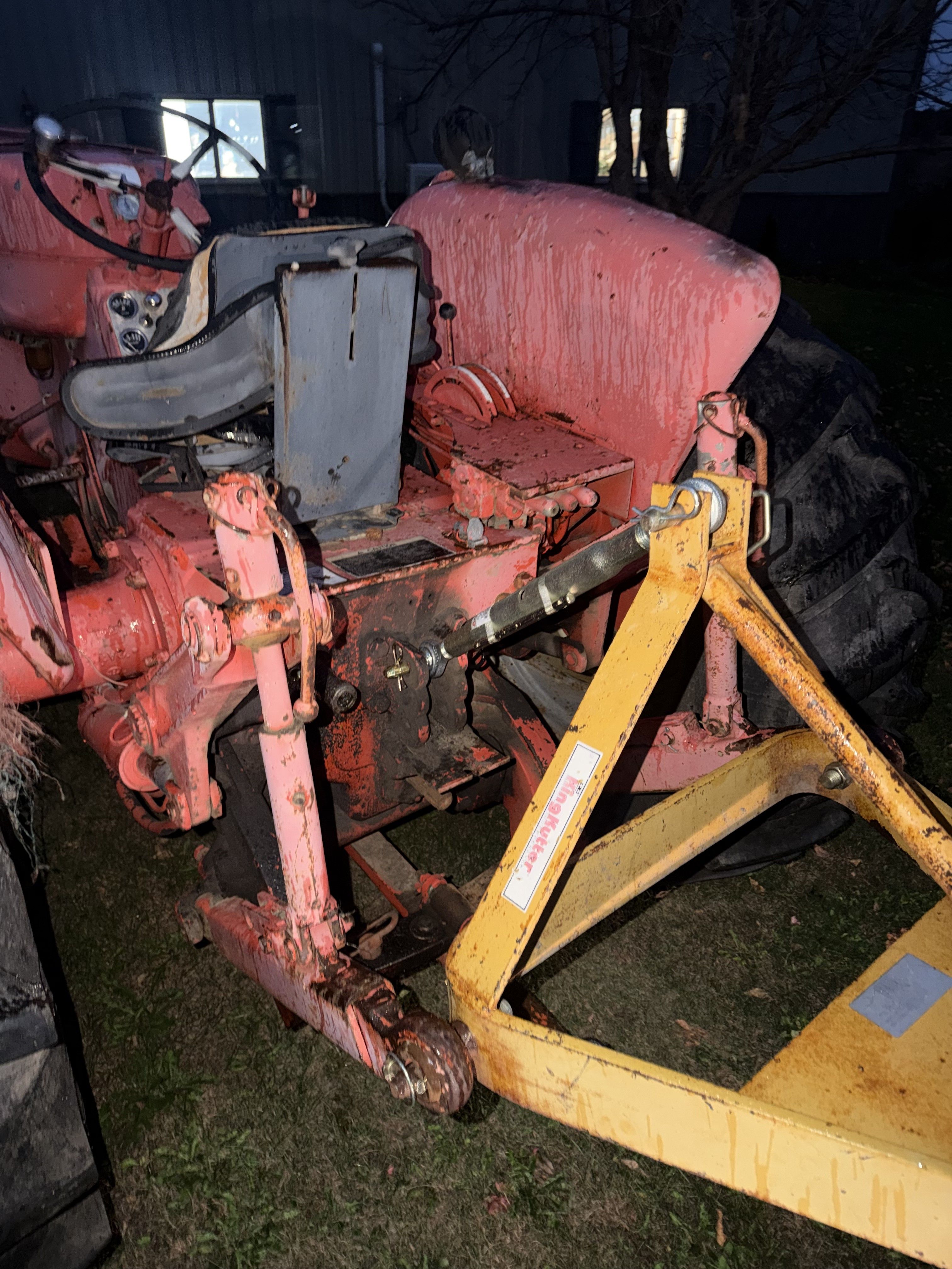

I've got a D17 Series IV that's got 3-point arms that don't want to move.
All of the levers are moving (I sprayed some lubricant to really free them), and some will make some noises...but the 3-point arms don't want to move.

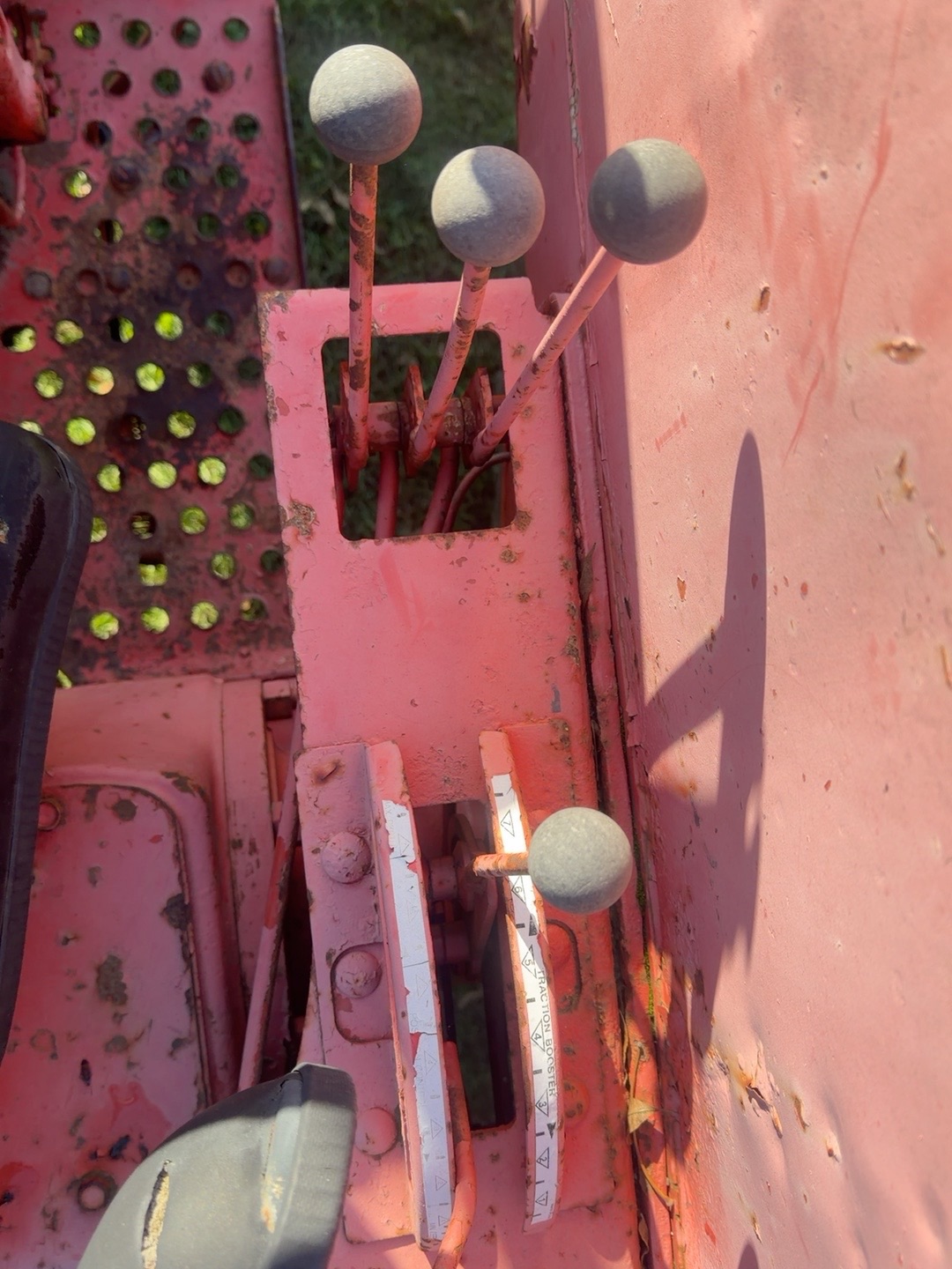

I believe I'm supposed to put both of the rear levers (traction control) to the forward position, then the farthest right lever in the front (set of 3) is the one that should control the 3-point arms (up and down). I move that lever forward and back while stepping/jumping on the 3-point arms and they aren't moving.
Any ideas?

Believe the short lever on the left is to go foward

Believe the short lever on the left is to go foward, position control. And ya got to force the arms down.

On the front right lever witch is the main three point hitch control you should be able to feel the detents as you move it

Both rear levers should be pushed forward to the front of the tractor.  If that doesn't help, your linkage under the console is seized up.  There are 2 or 3 pivot points under there that should move freely by hand.  If any of them are stuck, you will have the problem you currently have.  You have to get under there and lubricate them good so they move freely.  It's a common problem after 60 years without lubrication.  The traction booster could also be stuck, but from my experience, 90% of the time the linkage is the problem.

Ive got a 8070 that does the same thing. I take a comealong and hook to the arms and go under the drawbar and pull them down. After they start moving it works fine. Ive sprayed around the rockshaft with penetrant and i think that helps some but it still sticks sometimes

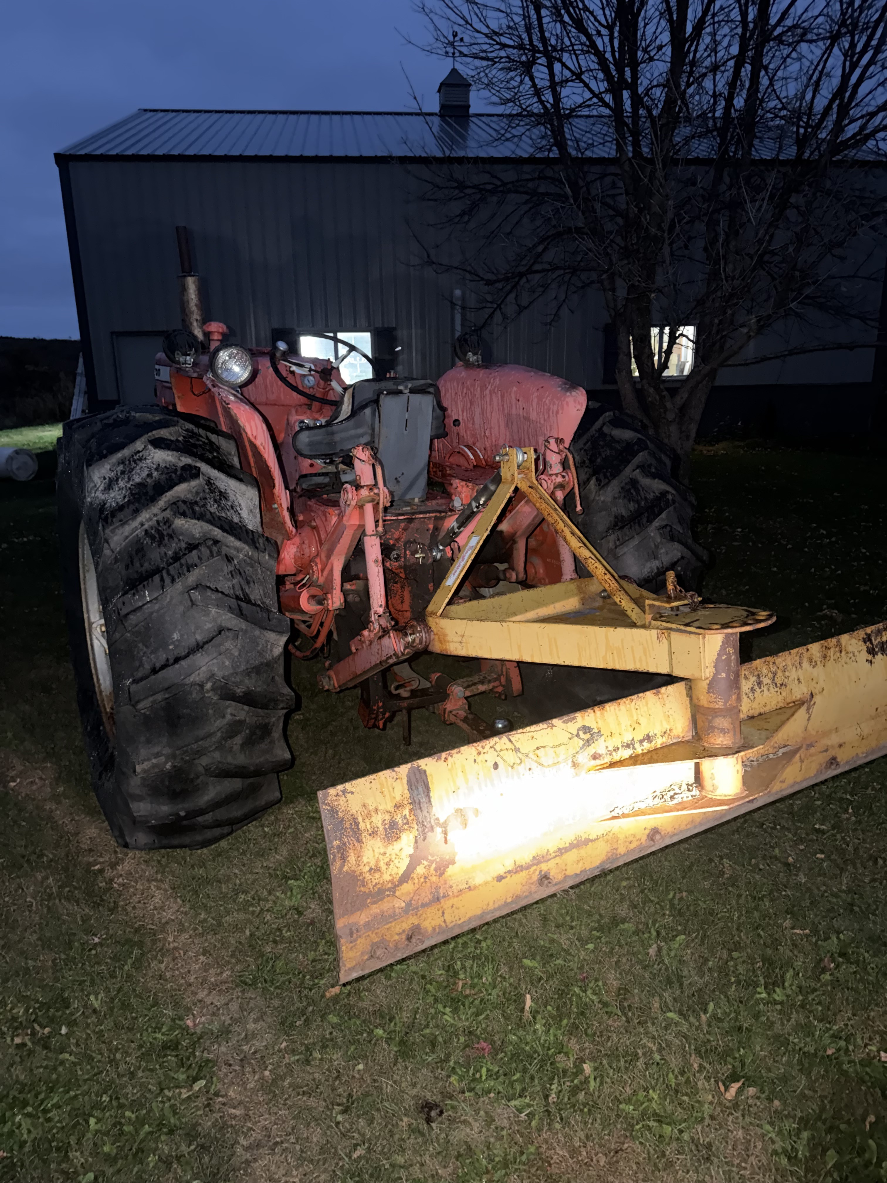

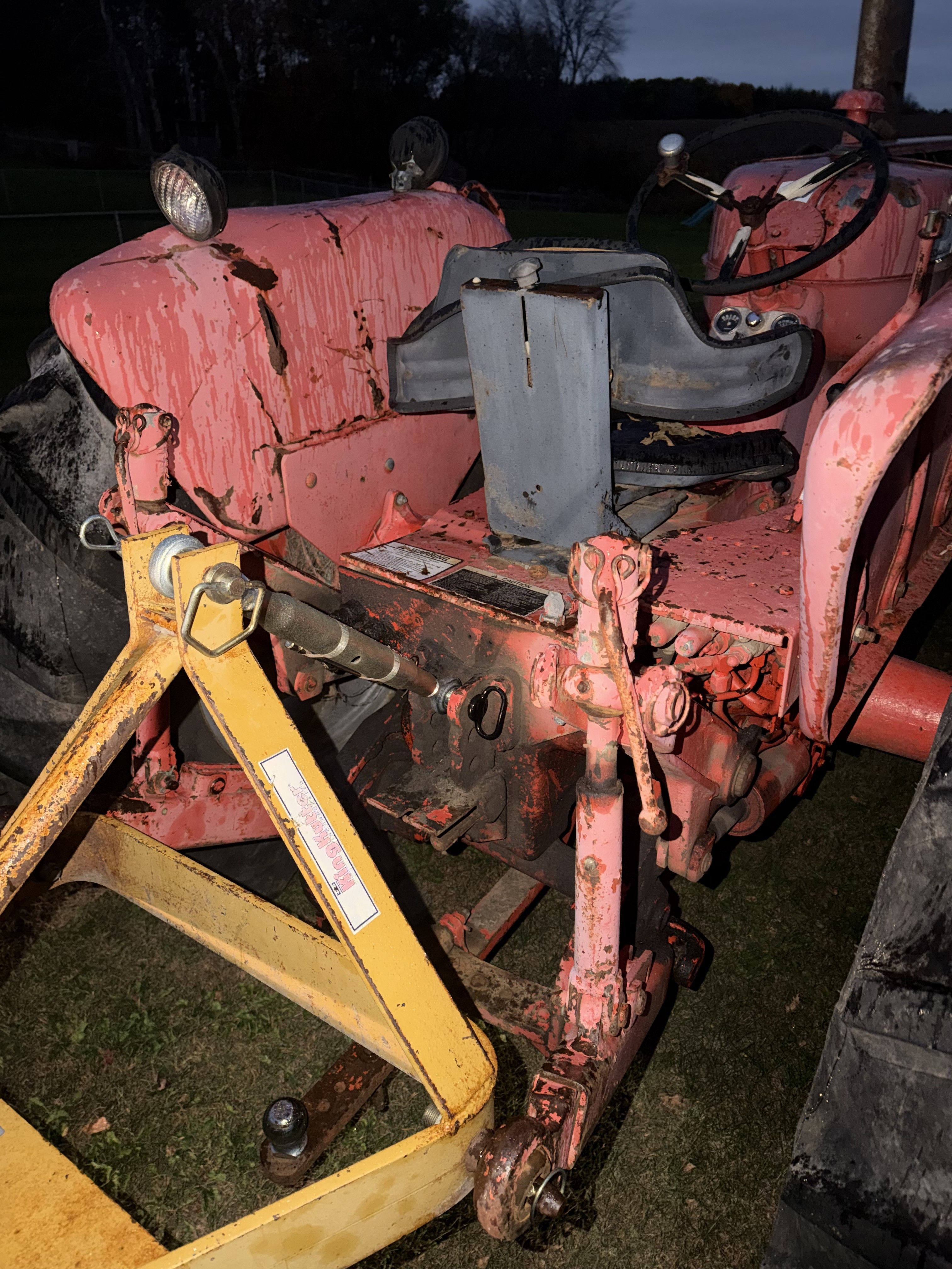

I managed to wrestle a rear 3-point blade on with the arms stuck where they are. With the added weight, plus cranking downward with my comealong, unfortunately the 3-point arms are still stuck.
I'll pop off the cover for the valve on the right next, hoping that the float inside is stuck and that's the problem.

Take a 7/8" wrench and loosen just one of the connections at the base of ONE cylinder !!!   They are teed together so you only need one leak !!  Loosen it a couple of turns and if the weight of that blade doesn't start the arms to drop, the cylinders are STUCK !!!   Stand in front of the rear wheel away from the blade to keep yourself safe. This isn't a difficult test and a very accurate one at that.

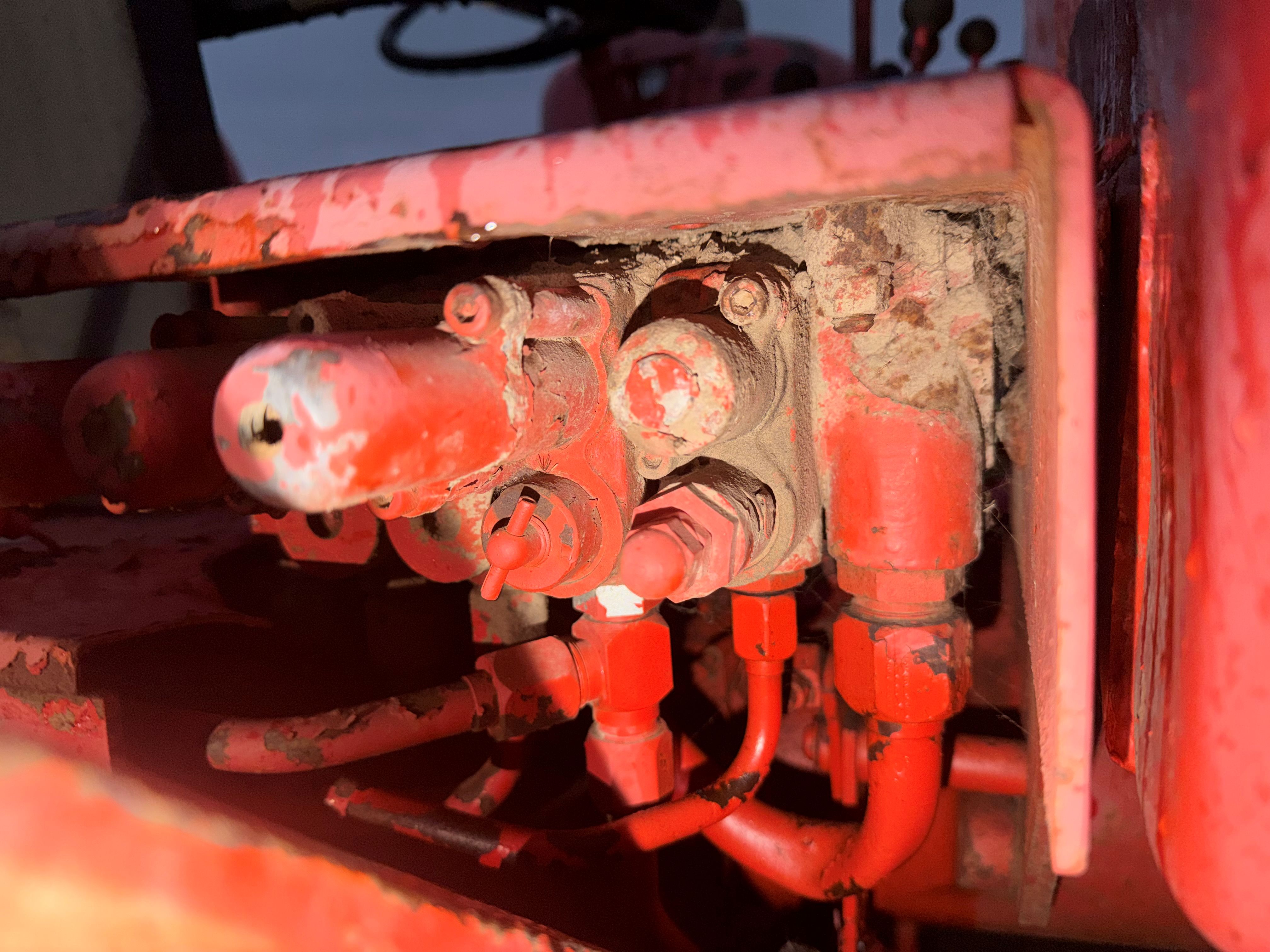

I tried valiantly to pop the valve cover off on the right hand side underneath the levers...and the allen wrench screws were extremely stripped.
I also tried valiantly to unscrew the 7/8" nut on one of the hydraulic lines that attaches to one of the cylinders and it absolutely wouldn't budge.

You can follow that oil line/hose up to the hydraulic valve and try to loosen the line nut at the "TEE" and accomplish the same thing. Lots of penetrating oil would be good. A little torch heat down below on that cylinder nut would break it free. The 7/8" wrench has to be a good one so it doesn't spread out and damage the nut. It will come loose. It's just a matter of attacking it correctly for however rusted tight it is. As far as those allen head bolts go, you must always get a large diameter punch and smack them hard a time or two directly on top of the bolt head with a 3 lb club or you have zero chance of getting them loose.

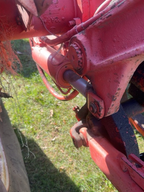

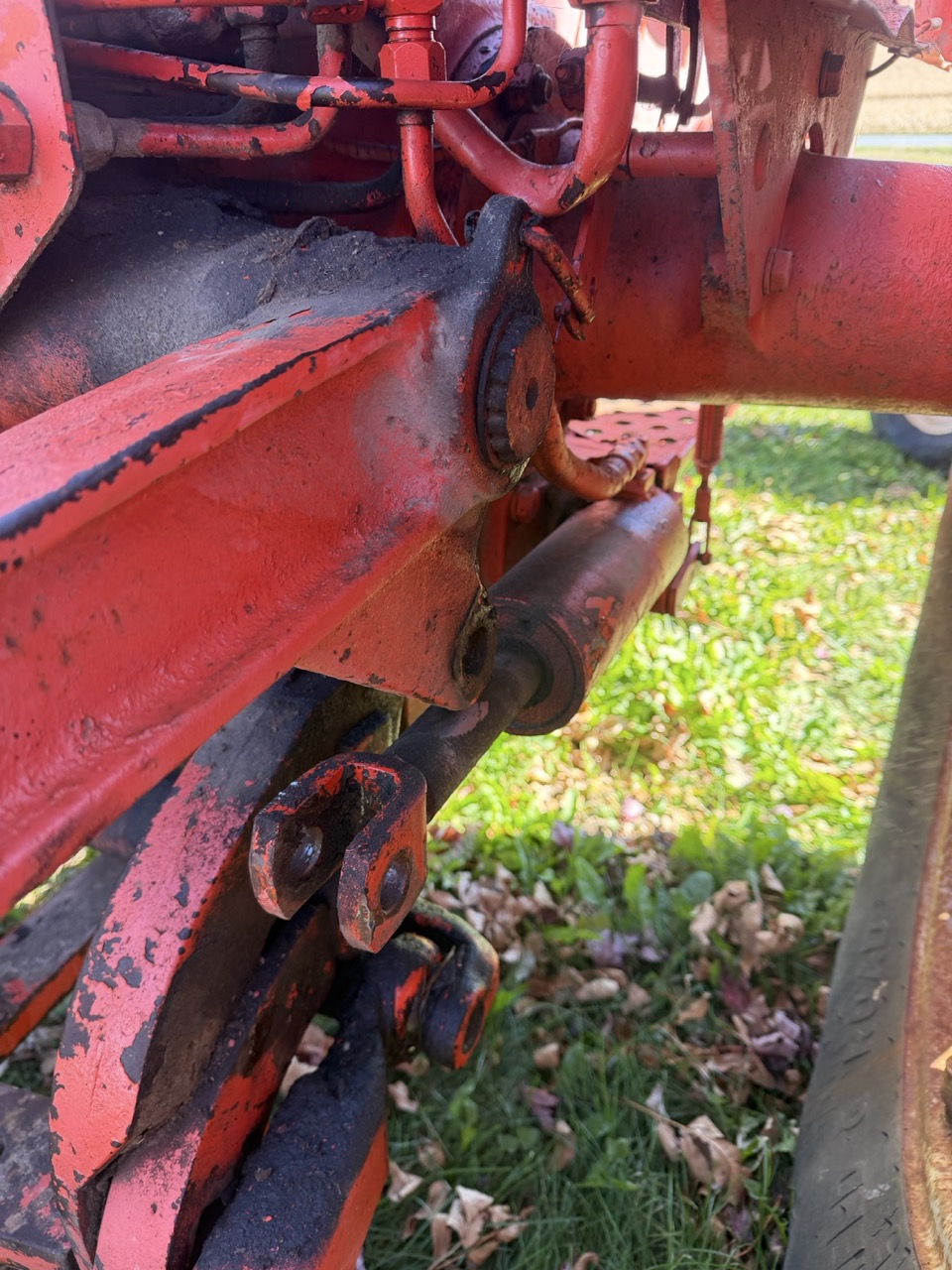

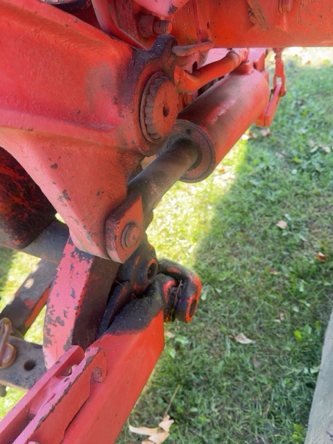

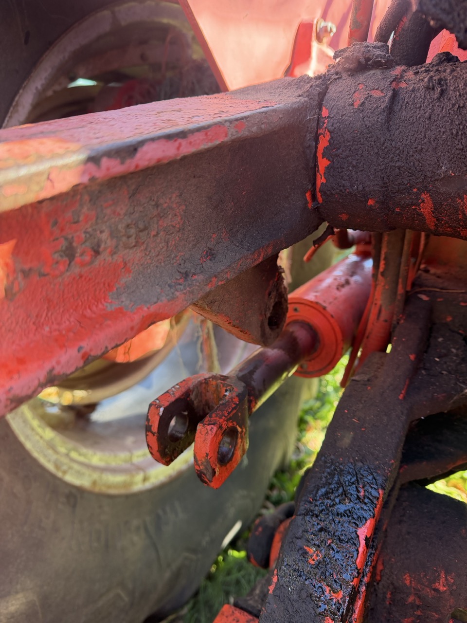

Had a mobile mechanic come out and did the following:
1) Opened hydraulic line and fluid came out
Arms still stuck
2) Popped valve cover off and flushed out gunk and cleaned inside
Arms still stuck
3) Popped pins out from 3-point arms to detach from hydraulic cylinders
Arms dropped manually
4) Attempted to hammer/force cylinders in (while pressing “down” lever)
Cylinders didn’t budge
The conclusion is that the cylinders are seized and need to be replaced. There’s rust on one of them and the mechanic suggested to find a replacement as opposed to repairing, if possible.
Anybody have any thoughts on this? Any leads on hydraulic cylinders for a Series IV D17? Thank you!
Edited by Derricks - 20 Oct 2026 at 10:43pm
Points: 9035
Post Options Post Options   Thanks (0) Thanks(0)   Quote Mikez Quote  Post ReplyReply Direct Link To This Post Posted: 20 Oct 2026 at 10:07pm
Have those fixed. Any good hydraulic cylinder shop can fix you up
Points: 9264
Post Options Post Options   Thanks (0) Thanks(0)   Quote SteveM C/IL Quote  Post ReplyReply Direct Link To This Post Posted: 20 Oct 2026 at 11:12pm
I'd fix em. If outside tractor,leave collapsedto spare from rusting more. HYD shop better equipped than you to work on them. Price it all first. Replace VS rebuild.
Edited by SteveM C/IL - 20 Oct 2026 at 11:13pm
