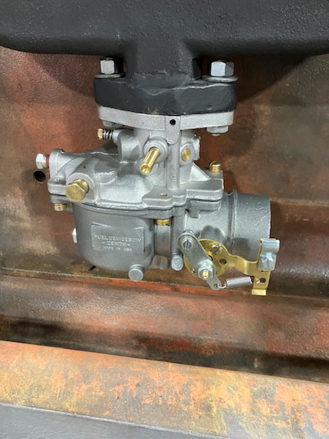

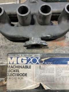

working over new manifold for new d19 zenith carb
Points: 23661
Post Options Post Options   Thanks (0) Thanks(0)   Quote DrAllis Quote  Post ReplyReply Direct Link To This Post Posted: 16 Mar 2025 at 4:45pm
The D-19 carbs I have used in the past (Marvel-Schebler, not Zenith) I drilled out the seat of the needle and seat. This is because gravity fuel flow from the tank sometimes couldn't keep up when running 2500 RPM on a 300 ft track. So, be prepared if you run fine up until the end and it seems like it might be running out of gas

i believe thats the very first brand new tractor carb i have had , its big old girl it clears the block by 1/8  will start updating pictures

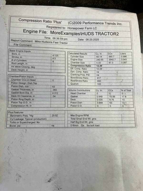

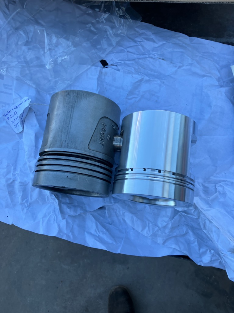

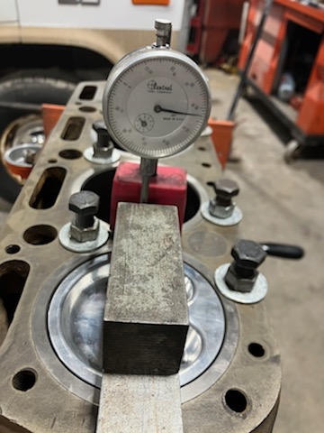

.060 above deck  head gasket composite is .065  still waiting on the head before we work on the pistons

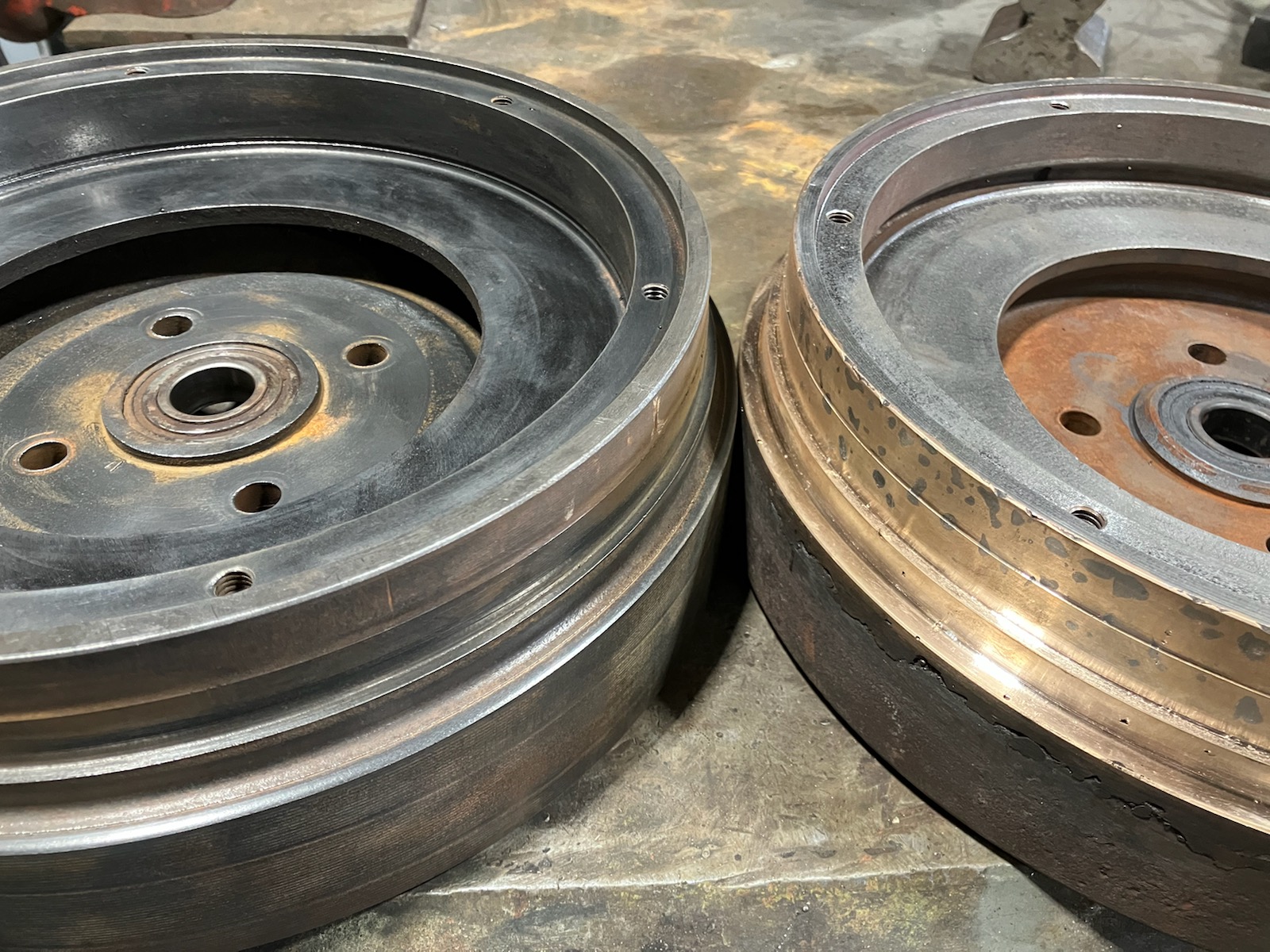

wasted money having the fly wheel of the wc turned for the ring gear it weighed 65 the wd wheel weighed 59.8 center in the wc one is solid i thought it would end up a few pounds heavyer but it came out 59.8 and the machine shop messed it up and had to weld it up and turn it agan   . my new little buddy star helping
Points: 23661
Post Options Post Options   Thanks (0) Thanks(0)   Quote DrAllis Quote  Post ReplyReply Direct Link To This Post Posted: 17 Mar 2025 at 12:17pm
Be sure to mark the flywheel for 15-20-25 degrees. The Fire mark is 30 degrees BTDC. 15 is half-way between fire and TDC. You'll figgure it out.

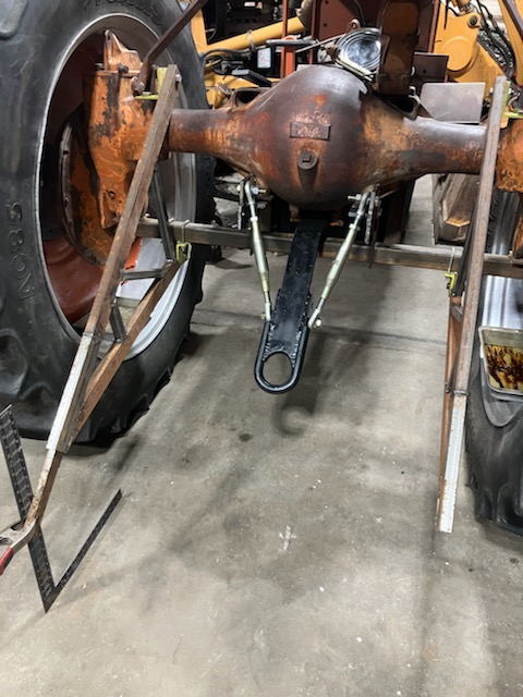

hitch and wheellie bars almost doneuploads/8753/IMG_1028.jpg
Points: 5488
Post Options Post Options   Thanks (0) Thanks(0)   Quote PaulB Quote  Post ReplyReply Direct Link To This Post Posted: 19 Mar 2025 at 6:38am
Just imagine where your pull point is going to be if by chance the pin at the front of the drawbar were to shear off. When I was a safety inspector for different clubs I discouraged drawbars with that sort of height adjustment. A cradle built around the drawbar with push bolts up and down that will allow the drawbar to slide cleanly our without changing the pull point to a higher position is much safer.

guess thats what the wheelie bars are for.   this is the first puller ive biult and probley the first dedicated puller in my area   their isnt much for hitches out on the inernet for hitch or wheelie bars for the wc  if  it dont work i will do somthing differant  . i should be the big fish in a little pond for a while hoping to spark a little more interest around here without spending a zillion
Points: 5488
Post Options Post Options   Thanks (0) Thanks(0)   Quote PaulB Quote  Post ReplyReply Direct Link To This Post Posted: 19 Mar 2025 at 7:21pm
When you find out it is an issue, it will be too late. Just build a support attached the same as the OEM. Then make a provision with push bolts up and down.
 I've seen numerous hitches break in the past 50+ years.

the framing square and the tube clamped to it is right at 5 inches beyond the radius of the tire and 10 inch high so if i put my pad on it that will be in the rules i should be able to pull a pin and slide them up and be flush with tires and not be in the way for loading.  i am hoping the angle is enought that if you hit the wheelie bars they are skids and not rippers

Hudco,  we havnt spoken for awhile.  Our conversations regarding flywheels.  yes the 45 flywheel does not have the undercut on the clutch side, but it does have less material on the crankshaft side. Have not been able to weigh them but the difference might be closer than we think, and reading you post above confirms that.

wc  and wd flywheel  but is a wd 45 flywheel any differant ? i dont have  one to weight i was supprised that the d17 wheel is lighter with the ring gear,  i think it was 58 lb.   by the way nice videos

We use two WC flywheels as weights on one of our pullers. One is for a crank starter and the other one has a ring gear. They both weigh 65 pounds.

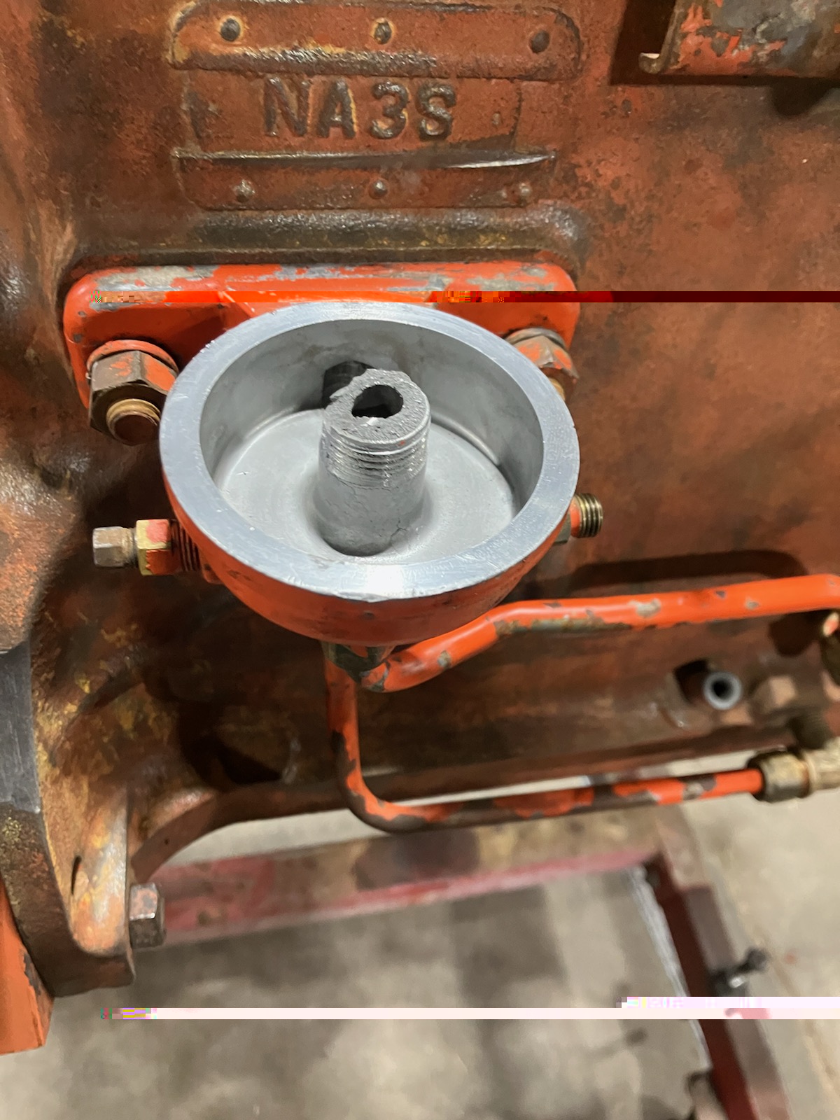

got some weights ready   but i need to find a oil filter base base for the d 17 series four engine lube system and also a usable distributer the inside of mine was rusted beyond rebiuling .  i have points condensors and tune up stuff also have a pertronix that i will use  ,  so far i havent found a filter base and distributor close around me
Kip-Utah View Drop Down
Location: Southern Utah
Points: 946
Post Options Post Options   Thanks (0) Thanks(0)   Quote Kip-Utah Quote  Post ReplyReply Direct Link To This Post Posted: 31 Mar 2025 at 4:14pm
Mike, I enjoyed our visit as well. Gleaner E, 170, 175 are all candidates for the parts you're looking for. Kip

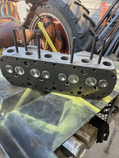

my machine shop finally got the head done i dont remeber the valve sizes but they are about all that will fit  in the long reach plug head   the shop laughed at my lift on the 175 cam and i didnt one rocker that needed ground , so i raided my private stash and bought a set of  murpheys 1.85 rockers,    to they are going to mill  .070 off the tops of the piston thats will put me .011 below the deck head gasket is .065  thats going to be real close for the valves .  at .070 they figered right at 12 to 1.  they are just going to cut a radius where the valve are not just keep cutting the top off.   how much will i need to cut for pockets for valve clearance ?     no offset cam keys

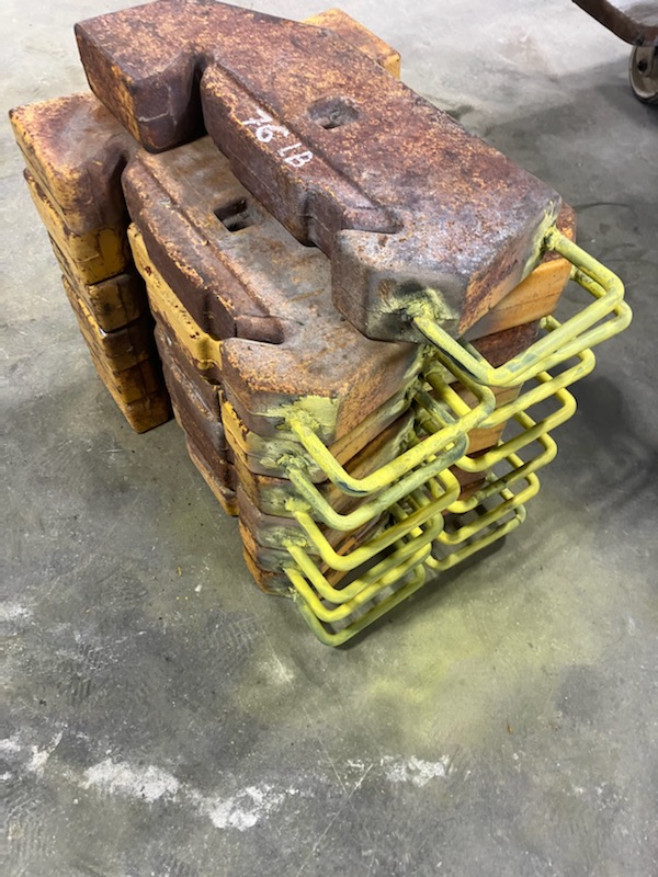

where should i place wieght brackets i have my battery underneath in front of the rear end i was going to build a bracket to fit three of those 75 lbs ih weights about a foot in front of the rear axle and some brackets off of the the square bar under the axle so that would put the weights just behind the center line of the rear end  i will biuld a bracket for the front but i am sure i need to start in the back.    where should i put put them for starters ?
