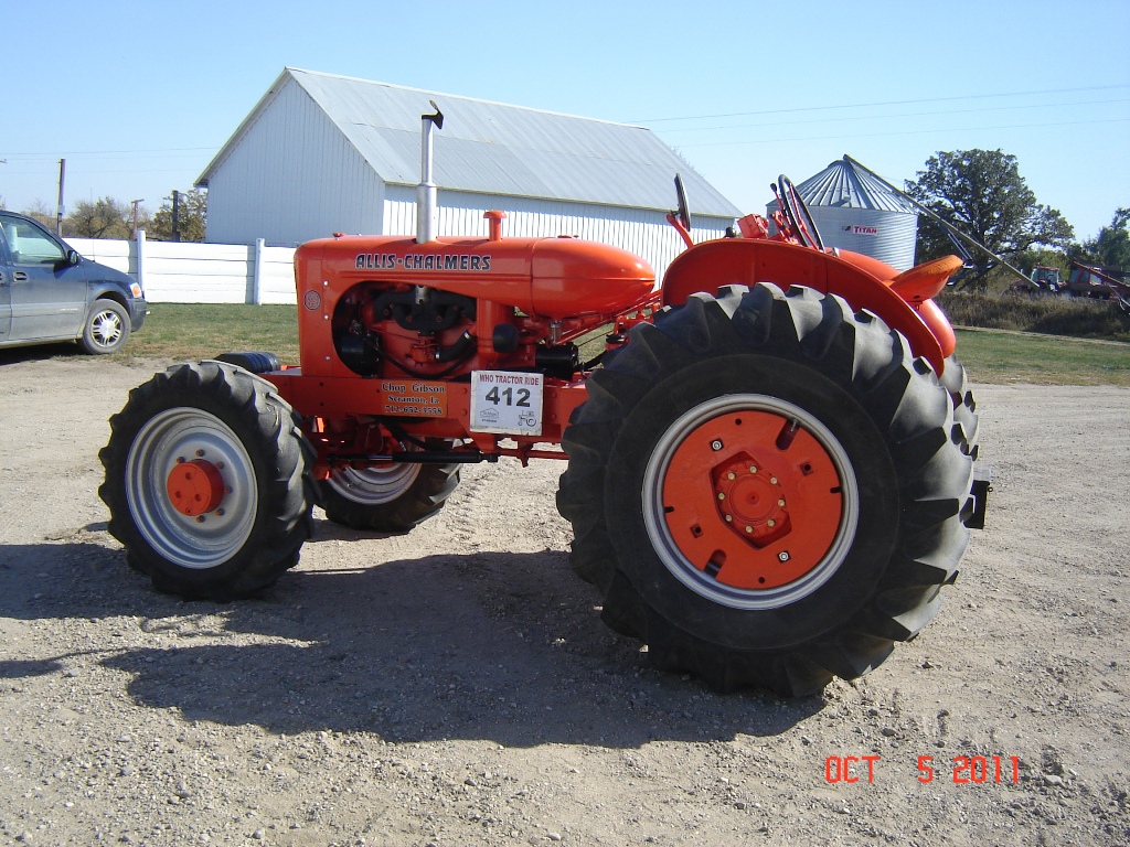

Doe's anyone have a picture of the 45 with the front wheel assist?

Any one know how he powered the front wheel assist?

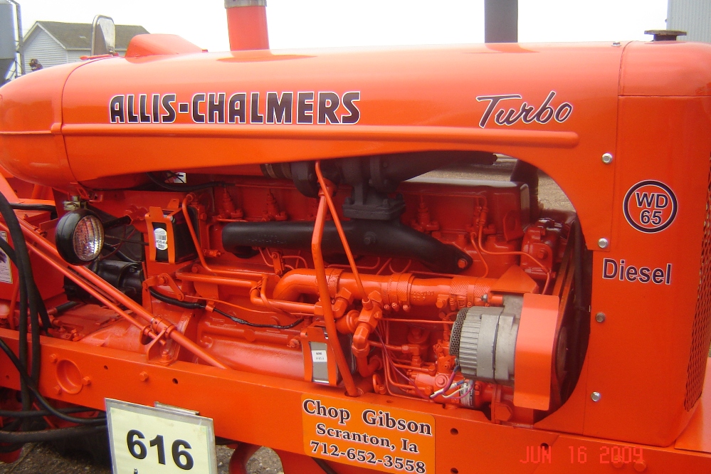

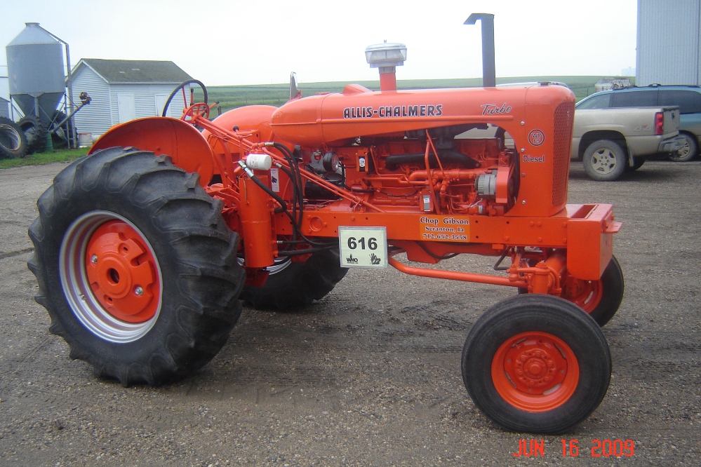

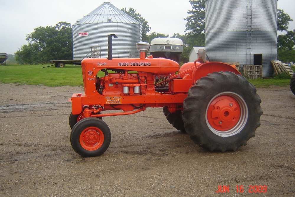

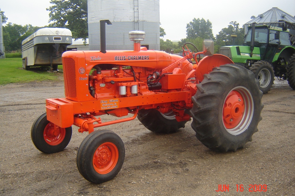

Is the grill and hood work the same or did it half to be extended and what bell housing was used and was the frame lengthened and I'm talking bout the wd65
Points: 23482
Post Options Post Options   Thanks (0) Thanks(0)   Quote DrAllis Quote  Post ReplyReply Direct Link To This Post Posted: 25 Jan 2015 at 7:28am
The grille shell has been raised probably 4 inches because there's four retaining bolts on the sides. Hood looks longer. Frame rails look stock to me but steering box been removed for more room for engine/crank pulley. I'd guess maybe a D-230 engine backplate made to fit the D-2900 or a reworked D-2900 backplate. A lot of work. My only criticism is the turbo drain tube....there was a better way than notching the top of the side rail.

Couple of pictures from the build. I think that the hood was custom built by someone from Minnesota.
