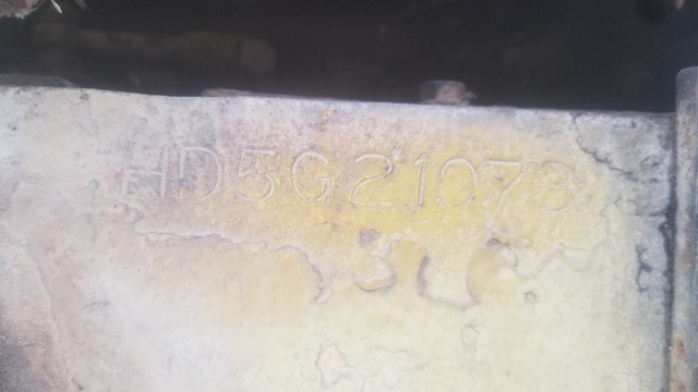

Last of the HD5 machines was 1955 ,
If you find the Serial # on dash plate or on the rear casting it can confirm the year built
Lot of small changes over years of production , improvements to loader frame are some along with the 2 speed reverse transmission .

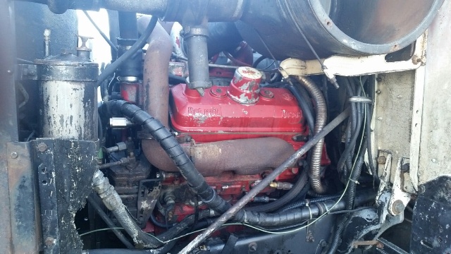

Ahhhh the sound of that 2-71 Detroit.....

I'll be over there later today and look for a data plate. She thought it was a 1958 build and seemed pretty certain, but obviously there could be disparity.

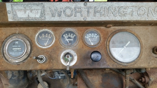

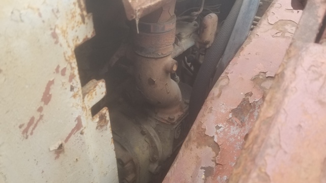

All levers and handles operate smoothly with even spring tension behind them. She said it pulled very easy with the 4020 Deere tractor. I didn't sit in it so don't know about the transmission shifting but the hand clutch feels as it should.
Drizzling out when the photos were taken and my phone shuts down on "humidity" constantly if out of the holder in this cool weather very long. I'm told the machine ran/operated well but was loud in a push......

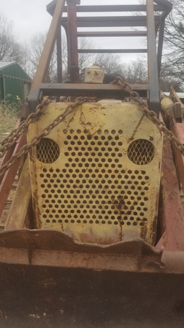

Some rather odd looking pads on the tracks, first time I've ever seen that.  Any story behind it?

I've seen those pads in the past but been a lot of years ago.
Few more photos:
Bucket cutting edge is broken out badly but I didn't snap a photo of it.

The Allis Chalmers HD5G with serial number 21073 was likely manufactured in 1954. The HD5 line was produced from 1946 to 1955, with a total of over 29,000 units built.

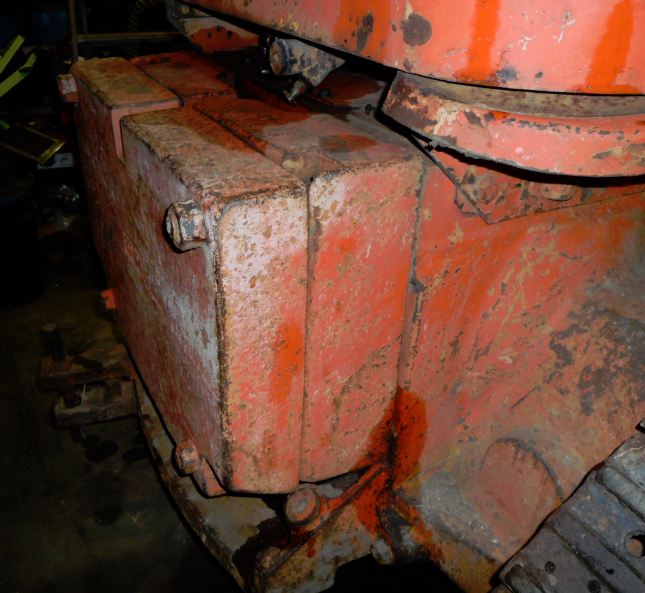

This is the counterweights on my HD5G - something I notice you are missing . Careful when using bucket as overloading machine without some counterweight will overload front idler axle and wheel bearings - Had 3 front idlers all with bent axles from machines I worked on and sold

HD5G 26784 1955 I bought it in 1972 and still have it

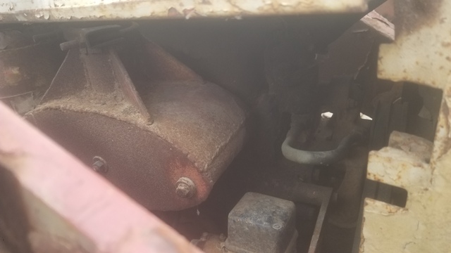

Thanks Coke. No idea to any of this myself. Looks like it's been a long time, (if ever) this machine had counterweights installed. Those on your machine appear to be cast iron/steel composition. If the machine proves serviceable when it's back at the shop, I'll give it a good pressure washing and remove the tracks to evaluate u/c further, and fully. It looks fair setting there with plenty of adjustment left, and there was no mention of any track walking off, but I'd like to evaluate the front idlers, bearings, etc. before pressing it into any kind of service as it will be kept several miles distant from the shop.
I did snap this but neglected to post earlier. No idea if it reveals anything to the discerning eye or not:

Most likely I'll winch it up onto the trailer and use the shop gantry to install a 4D battery. Getting too old to hike those up onto my shoulder any longer.....
Engine is not frozen as I can pull it around by hand. Hopefully no stuck injectors but will find out soon enough.

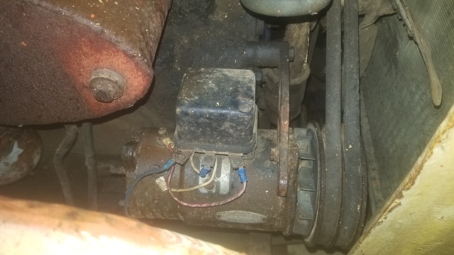

The 2-71 DD in my Son-in-law's HD5G has a twin belt drive; I removed the pulley from the generator and put it on a Delco one-wire 10SI alternator, then modified the mounting to suit.

Went ahead and picked up a low rpm pickup 10SI One wire 105A alternator from Amazon this morning. Ebay had the conversion sheave for a 3/4" drive belt so went ahead and ordered that also. Both offer free returns so no real risk.

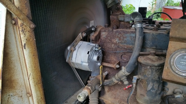

I did like Les and took the pully off the generator. It fit the Delco alienator with no modification.

I took the pulley from a alternator off a 70 series GMC that was double belt , then put in lathe and widened groves to accept the B width belts , so still running 2 belts

Was over there yesterday in the rain and the generator with two belts is still in place. Definitely B series belts so if that sheave will fit I'll reutilize it.

Was over there yesterday in the rain and the generator with two belts is still in place. Definitely B series belts so if that sheave will fit I'll reutilize it...
The twin belt sheave fit right on my 10SI unit perfectly and I re-used the belts as well, you will need to get a bit creative with mounting it Wink

I'll just build onto this thread with a starter problem. I did remove the 30MT starter from my Detroit engine and it is burnt internally. It was dropped at a local rebuilder who estimates $175, to $325 for a complete rebuild once opened up. Don't mind doing that if need be but my question is: Is there a modern gear reduction unit that is lighter in weight and draws less current available, and should I even look this route? Starter is 12 tooth CW rotation, 12VDC. No photos as raining when starter was removed and phone was purposely left in truck.

The generator that was on my Son-in-law's HD5G is a Delco-Remy third brush type that uses the third brush for current (amps) limiting but has a two-coil regulator for voltage regulation. The previous owner told us that the generator did not work, and he was correct, so I swapped it out for the 10SI alternator, which I do not regret.
I later checked out the generator on the bench and found that the regulator was not making ground contact, when properly grounded it produced voltage while being spun with a drill. I did not give it a full workout at the time but I plan to when I get my test bench set up.
Your generator appears to be a different type and has what might be a three-coil regulator, is it possibly a Prestolite? If it functions properly I would just run it.
