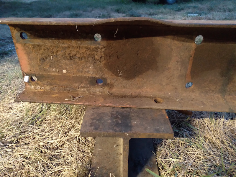

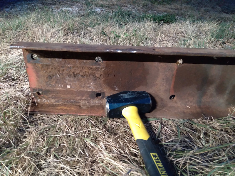

I'm getting ready to put the LH frame rail back on. Anyone know how these get bent up like this, just behind the front pedestal on the bottom side? Both frame rails of this tractor were like this. I think sugarmaker had a tractor like this in one of his threads, too. Didn't have high hopes I'd be able to do much but whomping on it with a 3 lb. hammer actually does work. I left some dents but those will only be visible from underneath. Good enough for a working tractor.
IBWD MIke View Drop Down
Joined: 08 Apr 2012
Location: Newton Ia.
Points: 4454
Post Options Post Options   Thanks (0) Thanks(0)   Quote IBWD MIke Quote  Post ReplyReply Direct Link To This Post Posted: 30 Jul 2022 at 7:09am
I don't know how people, (always the previous owner) bend stuff like that! Seen many things I thought were indestructible bent up pretty good. Couple of WD lift arms come to mind, how do you bend those?!

When you slide the grab hook end of a chain under there, you can get that.
This has to be it. Someone must have tightened binders or whatever way too much when tying down to a trailer. Hadn't thought of that but that's the only thing that makes sense since it was bent downwards. Thanks!

Really glad your making progress on the old WD! Frame looks way better. Yea I had one with a good bend in it too. Plus a bent rear lift arm. Some folks can bust a sledge.
A little heat on that might have brought it along quicker?
Frame rails going on. Nice to get things back together!

Chris, I remember you saying in your thread that you used a torch. I finally got a stick welder and a drill press this year... Torch and bench grinder are next on the list. I don't quite have a full service shop here yet!

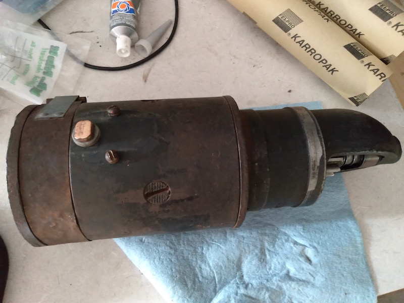

I've been chipping away at the starter between other projects and got it buttoned up last weekend - mostly needed new brushes and some commutator cleanup. I replaced the bushings as well although they weren't terrible.

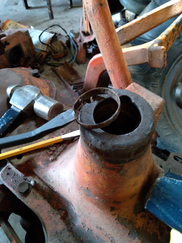

Getting the new retaining washer into the gear shift lever stumped me for a few minutes before I realized that the outer edge of the old washer was still stuck in there. I wrongly assumed the whole thing was missing or rusted away when I was able to pull the shift lever right out of the tower. Then the new one went in easily.
Also, the gear shift boot I bought new from AGCO a year or so ago, and had stored out of sunlight in my shop, has a crack starting in it already. Seems like there is no good source for these, sadly. Hopefully this tractor won't be sitting outside but you never know when you'll get rained on. I used a little tire bead lube on the shifter and the boot was pretty easy to install.

You might try spraying the rubber part after installation with paint to protect against UV. Imperfect protection, but better than none.
Grease on the inside may also protect against ozone creaking too.

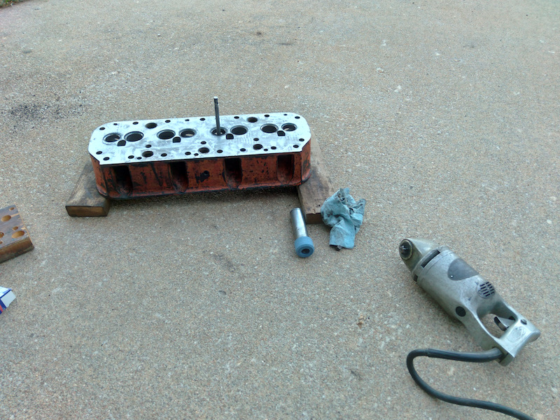

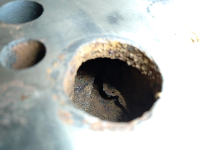

I've been cleaning up the head. Has anyone seen this much flash inside the water passages on your heads? It surprised me.

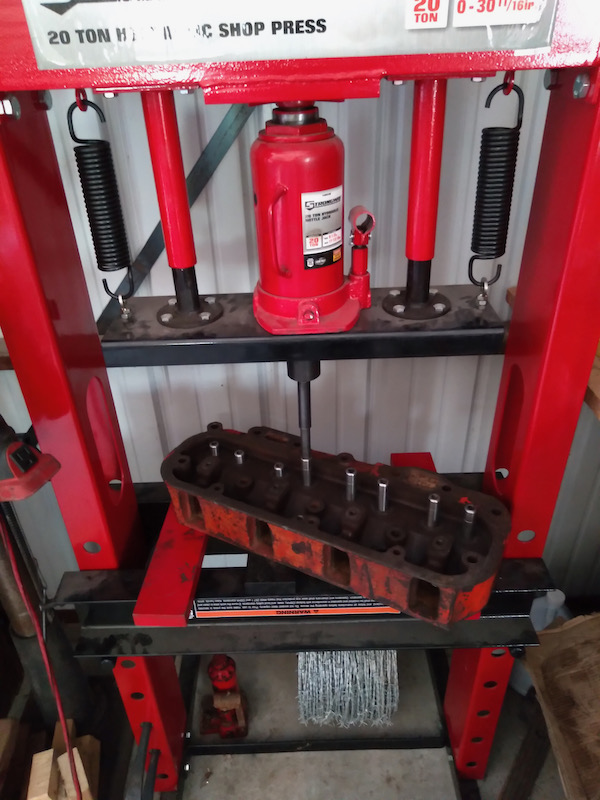

I pressed the new guides in after cleaning the bores. Just pay attention to the specs for setting the depth in the service manual.
I had a holdup with the old Sioux seat grinder when I started on the seats. The bearings in all of the stone holders were done for, so I had to order replacement bearings and wait on them. Should be good to go again now. I'm still learning how to do seats. I've only done one small engine and those seats were just in the cast iron of the cylinder. Worst case I guess I have to take the head in to have a seat replaced if I mess one up or can't clean it up with enough meat left in it.

Last I knew distilled water was about $i.00 a gallon so I used that along with antifreeze, water in this area has lime and iron in it.
I always use distilled water when mixing antifreeze. Back in FFA we restored a JD A that looked like it must have had pond water dumped inside of it. Like you pointed out, distilled is so cheap that there's no reason not to keep some on hand.
This tractor wasn't too bad inside the cooling system. I just thought all that casting flash inside was odd.

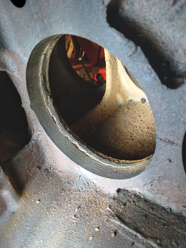

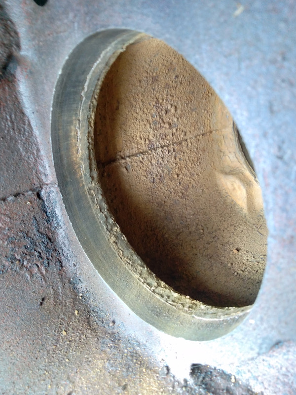

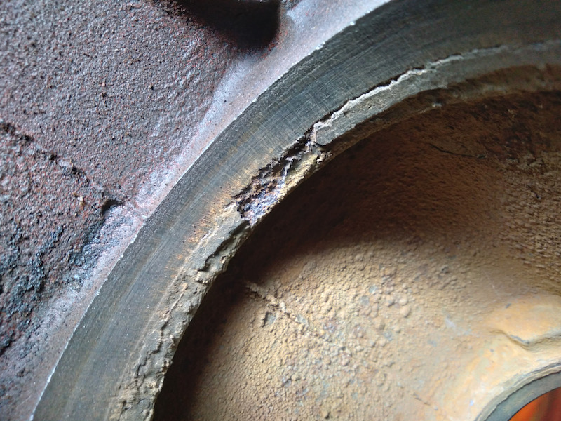

I started cleaning up the inside of the block tonight and didn't get far. The cylinder sleeve o-ring sealing areas in the block are awful. I measured and compared to the groove locations in the new sleeves, and the lower o-ring should seal fine on all of them, but the upper won't seal on at least 2 of them. They're pretty eroded away and as damaged as these are I don't think I'd trust any type of sealer/epoxy.
I'll be doing some thinking about this. I think my options are to have a machine shop sleeve the block or find a replacement block... Anything else I'm missing?

My brain is not working today. Upper seals? Remind me or take a picture or two of the area your concerned about? I was thinking there was just the seal on the bottom of the sleeve?
If you dont have cracks in the block in the lower web area you may be able to clean up the seal areas??
On another area: Might be a good time to remove the shift tower and check for wear areas, and possible needed repairs on shift folks etc?? Just sayin....
Your doing great! Keep at it. It will preform like a new old tractor!

Post Options Post Options   Thanks (0) Thanks(0)   Quote wjohn Quote  Post ReplyReply Direct Link To This Post Posted: 28 Sep 2022 at 9:32pm

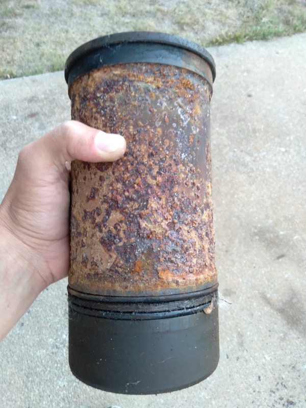

Here's a picture of one of the old sleeves. You can see the two o-rings I'm talking about lower down on the sleeve. They both seal against the ugly looking area in the lower part of my block. The new sleeves are similar but still nicely sealed up in the factory bags, so I'm leaving them alone until I'm ready to put the engine together.

If that crusty stuff is on the top side of the bore, I would scrape it off and polish it up. There should be a chamfer, to lead in the o-rings on the top of the bore. That area can get real crusty from the coolant, and sediment settling in above the top o-ring.
There is still crusty stuff I could further remove, but it is eroded well below where the top o-ring would sit. Even in the same bore, you can see spots where the original machined surface is still intact up high, and right next to it will be a spot that is completely corroded away. The lines that look like cracks are corroded well into the machined surface.

 Sorry I was not up to speed on the shifter. Hate to see you have to get another block. But that may be the answer. I had to do that on my WD45 due to cracks.
The danger is another block can have its own issues too.
Just a wild thought but could JB weld fill in the voids and be sanded smooth?? I know that is kind of a bandaid for sure. Could work??
Keep at it!

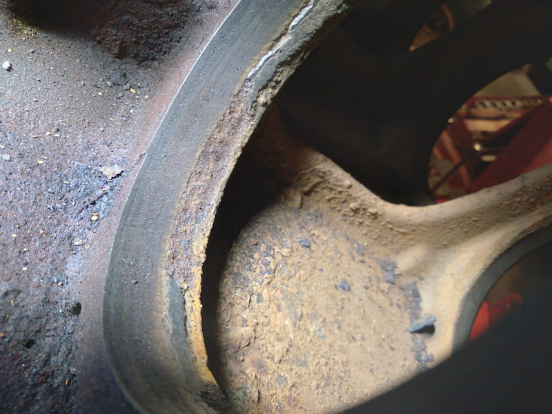

Chris, I've run into suggestions for JB Weld, Belzona, etc. online, but usually for filling pits and such. I pretty well gave up on that idea since I have the whole top 1/4-1/3 of the area flaked away. I don't think it would hold up at all like that. Filling in smaller pits with a generally solid surface around it, I think it would be fine. No cheap date here, I don't think! Like you said, getting another block means more inspections and chances for missing things, too.
Here are some better pics after I took a welding chipping hammer and light tapped on the flaky stuff... Disappointing for sure, especially with no cracks to be found in this block.

wjohn, I think a good used block is in order. If you were to repair that one, Belzona would probably outlast the rest of the tractor. Problem is, you would need to apply it then re-bore the cylinders.

Just another long shot. very long shot! What about spray weld, or spray metal? Yes would then have to be rebored. The shop I have do do engine work has the capibility. But would not be close by.
