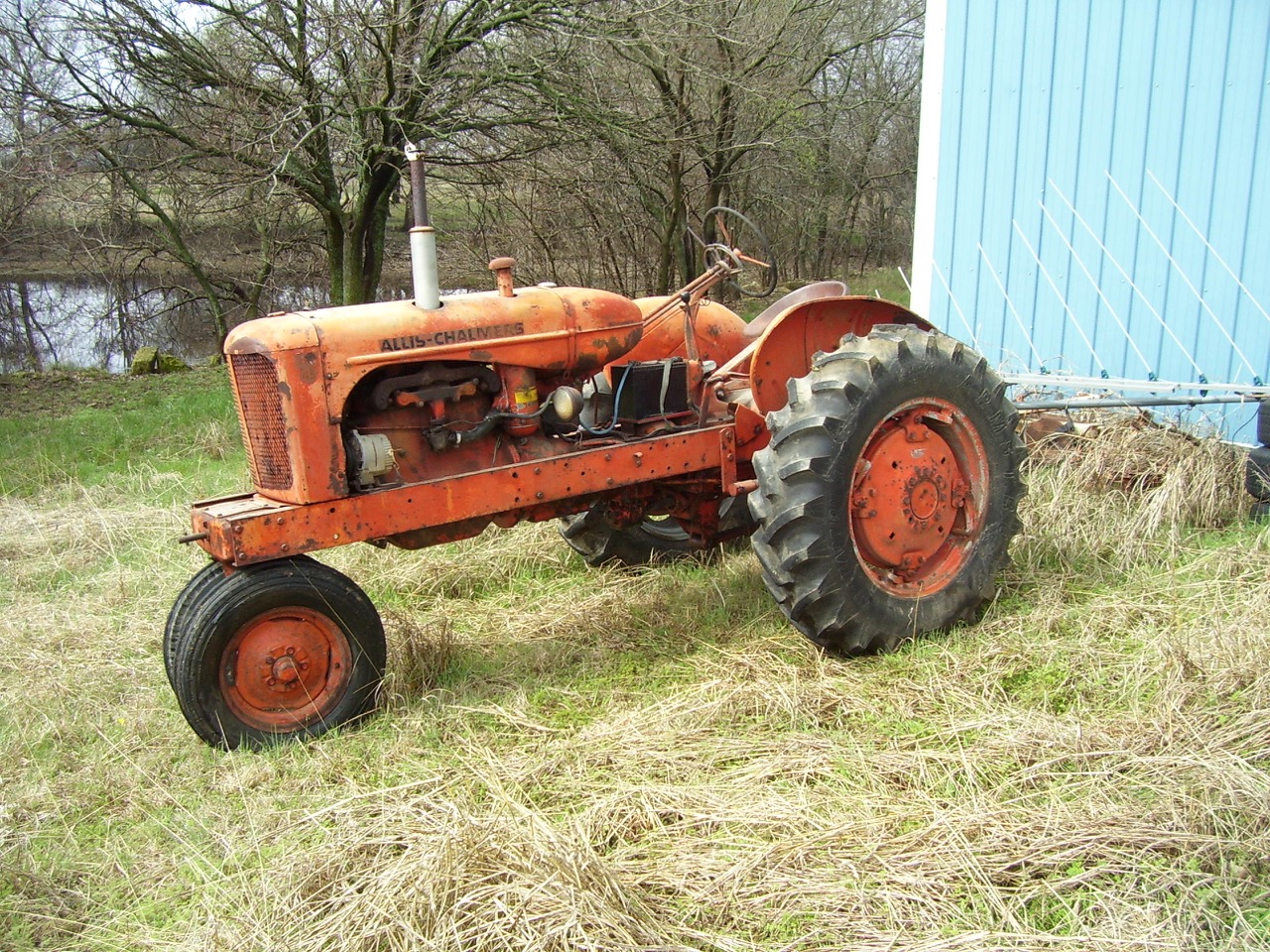

The seller just dropped this off today. Not exactly pretty, but it runs pretty well and everything functions minus the PTO that's missing the shear bolt. "Supposedly" the engine was rebuilt later on in its life.
It's going to need a number of leaks fixed (including what looks to be the rear main seal) and hoses, a belt, etc. The drawbar bail has been welded on but looks fairly solid. Rims look good. It'll need a front tire soon, and it sounds like there might be some bearing noise or something back around the axles or final drives.
Otherwise I'm hoping I can get out and disk with it soon and get some grass seeded with my JD drill.

Being mechanically sound usually trumps being pretty, and it sounds like it won't take much, and it'll be mechanically sound. Good snag! Darrel

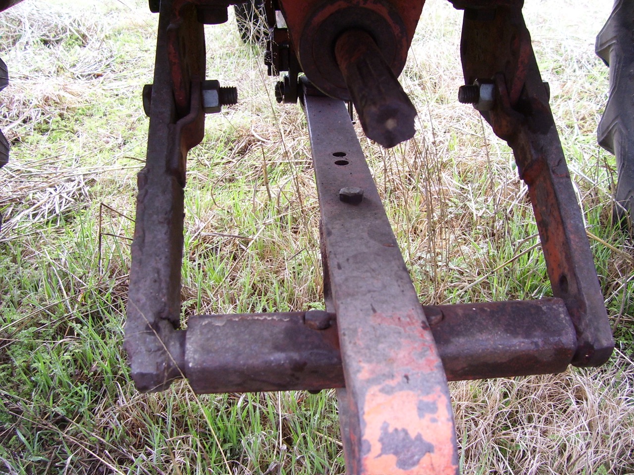

Looks like a pretty good find!
What's with the welding of the drawbar area?

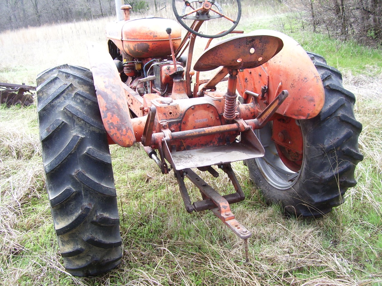

It wouldn't hurt a bit, to drop the final pans and clean out any sludge in there. Ya never know, it might have the original lube in it.
 Then while the pan is off, you can eyeball the final drive gears, and maybe pry around a bit to check for loose bearings. Straight  gear WD's always did have more gear noise than the later model with constant mesh trannies.
 There is no "shear pin" in the PTO. Anything run off it, needs a slip clutch or a shear pin of it's own.
 The bolt that connects the PTO output shaft to the long shaft, is a case hardened shoulder bolt.

notice no flip up seat, when they start  the flip up seat? love that on my 55.

As far as I know the flip up seat was an after market item.

I'm not sure. Someone must have broken that side of the bail at some point. It's not very clean looking but it seems to be solid, so I'll leave it for now.

Dad's '52 WD didn't have it either, so I guess I don't know what I'm missing!

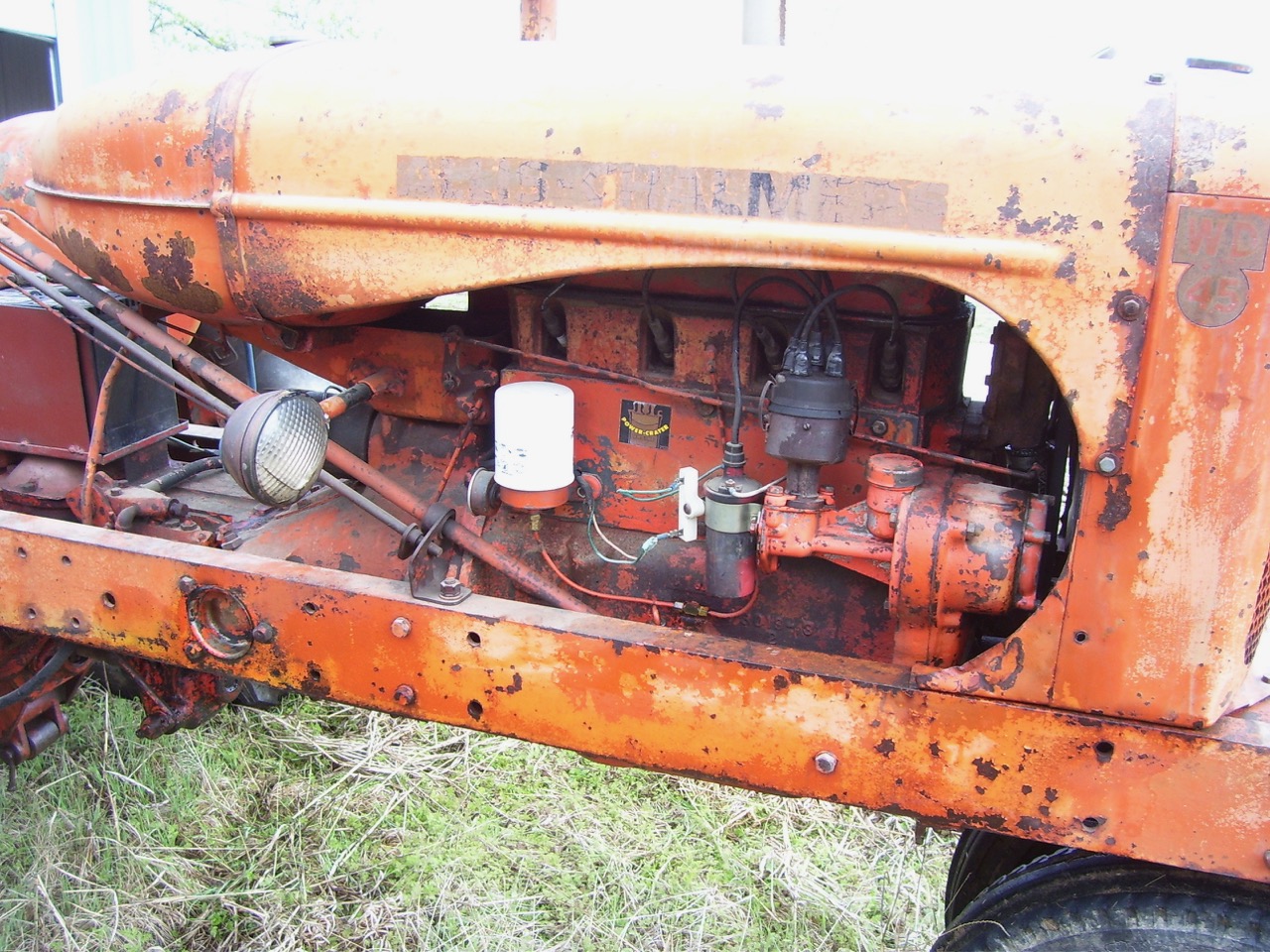

Man does that look like the ones I have brought home! It has indications that the engine may be a WD45. Looks like the oild filler cap is a WD45 type. Not sure but the head looks like the tall one. Has a WD45 decal on the rad shell. Power crater decal on the block??
Yea most have the welded bail. I have had to replace all three of my bails, I have one that's welded but looks pretty clean as a spare.
Your tractor looks like it should function well for some discing work. Rims can be a big issue, so thats a plus if yours are good.
Looks to have been mostly converted to 12 volt (alt) but still has the ballast resistor. My 45 had that too. Still cant figure why folks dont get the right coils when doing the conversions??

I was surprised to see the WD-45 power crater decals and the 45 head.  Looked at the shift lever and thought it may be a very late WD - they had the constant mesh transmission.  Over all looks good for a tractor "pushing 70".

Sideplate on engine means a WD or WC engine. Of course I bought a WD once but knew right away it had a WD45 crank in it by the way it snapped to attention.

Yep Lonn is right thats a WD block for sure! I completely missed that side plate. But as mentioned it may be a 45 engine lurking inside that block!:)

I saw the plate. I saw the Power Crater sticker on the side. Those stickers must have been a dime a dozen once upon a time.

Dad's '52 has those same Power Crater stickers on it, too. I almost wonder if AC put them in with a "45" engine kit or if AC only offered WD-45 decal sets for service parts, and people wanted to use every last decal.

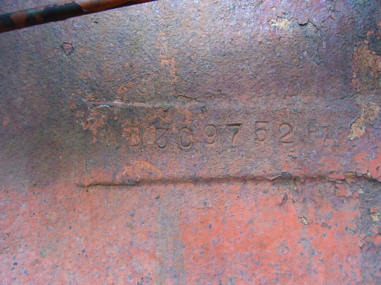

I didn't include the engine SN for fear of picture overload in my thread, but here it is. Seems like it could be original and I was glad to see the PA suffix, although if the internals have all been swapped out that may be moot. I should stick something down the spark plug hole and see if I can measure what the stroke is.

I thought I remembered seeing something about the tall head being on some of the WDs - Dad's '52 also has the tall head. Looking in the parts book shows that engine SN 289000 on up had it which would mean it's probably original to this tractor, too.

I think the seller said he had to replace the governor at some point, which would explain why it's the newer housing and fill cap. Good catch.

I pulled a spark plug and measured the stroke at 4"... Just a plain old WD crank. The carb is a TSX 422 so at least that matches up correctly.

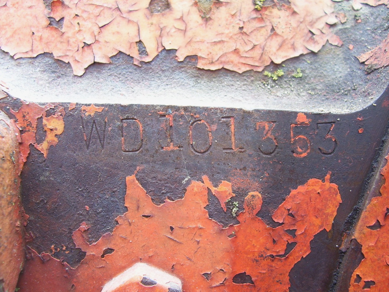

Your 1951 WD numbers fit in nicely on the WC, WF, and WD block chart I've been putting together.
Block casting number: U 3019-31
Engine serial number: WD309752PA
Tractor Number: WD101353
Here is a link to my chart:

Nicely done - I didn't know anyone was tracking the engine numbers as well. I just about couldn't find the 1 in the -31 on my casting but it's there.

Looks like it has been converted to a 12v alternator and a distributor?

bhaynes has some of this correct. But you never really know about these old engines till you open them up. Very few are as they were from the factory.
When my Dad and uncle put a 45 kit in the old WD's. it was moving from 4.00 dia inch stock pistons to oversize 4.125 dia pistons and sleeves. Most times the stroke remained as factory with a 4.00 stroke (factory for a WD) Now the WD45 had the same piston bore options but had 4.50 inch longer stroke. Different crank. It also had dished power crater piston compared tot he WD flat tops.
So most of these parts are interchangeable and these engines have been confiqured many ways since they rolled out of the factory doors.
A WD block (plate on the side) can be used to make a WD45 engine. And a WD45 block with no plate, was the replacement block at some point for all these. So it can be  a mix and match of components to meet the owners needs.
I think I have most of this right but feel free to add.
Yes the head is taller on a typical factory WD45 also.
Back to the current channel Wjohn has confirmed this nice tractor is a WD with some WD45 decals. I would drive it!:)
