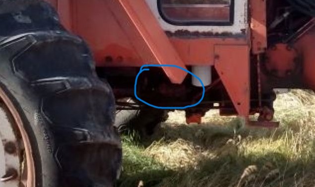

I looked through my pictures to see if I could get a picture of the valve. I found one. It isn't clear, but it does show valve location.
If it has the hydraulic valve try spraying WD40 or similar into the console and waiting a day to see if the detent loosens up. I usually just fog some in around the remote levers. I learned recently(from this forum) that all 190XTs with a PTO have the disconnect lever on the left side, but on hydraulic control models nothing was hooked to it. It sounds like yours may have been modified since it left the factory.

That blue circle is the Power Director valve. The hydraulic PTO clutch valve (an option) is 16 inches to the rear of that blue circle, if it has one.

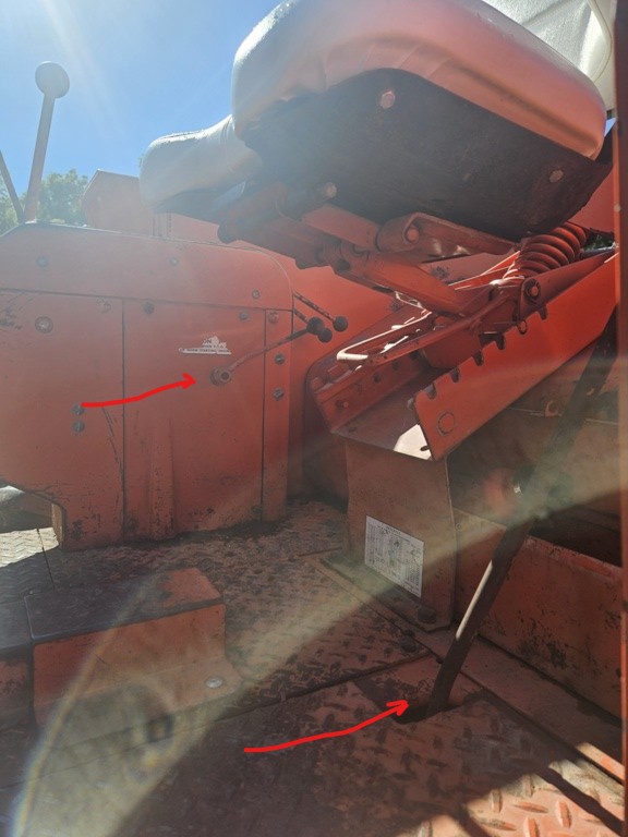

Picture showing both levers.

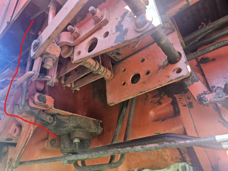

I believe this is the valve showing linkage and lines connected.

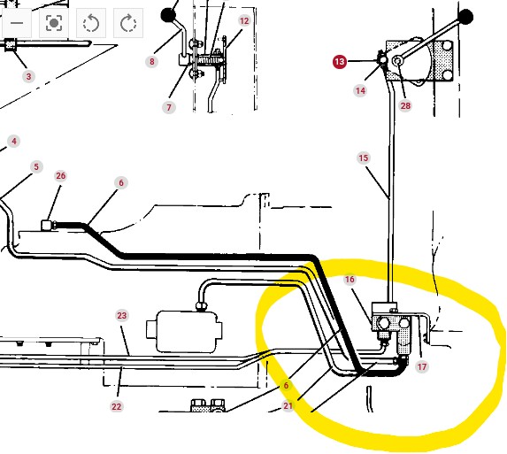

Here is the parts diagram for the PTO Valve.  I see 3 lines connected as in the diagram.

Post Options Post Options   Thanks (0) Thanks(0)   Quote DrAllis Quote  Post ReplyReply Direct Link To This Post Posted: 11 Jun 2026 at 9:30am
It appears the PTO hyd valve was added on after the tractor was built. There's no paint on it or the lines going to it.

The hand lever to the left of the seat was normally left off when factory equipped with the hydraulic PTO OPTION.  BUT, if you look behind the battery box and follow the link rod from the hand lever down to the torque housing, you will see a short lever that came on EVERY tractor at that time. So, BOTH types were on every tractor that had a hyd PTO clutch.
