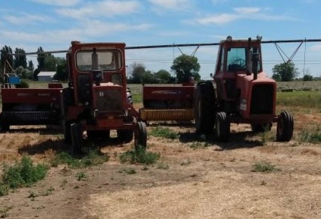

I looked through my pictures and most of what I have has the top of the exhaust about even with the top of the cab. My seriesIII has the smaller muffler on it (Stemco if I remember correctly) and I don't notice exhaust noise when I run the baler. What I remember is I think I hear more noise from the fan than the exhaust. The other nice thing about having the exhaust and the cab about the same height is you have a clearance gauge in front of you. We have center pivot irrigation and there are times it is nice to know if you will fit underneath.

I have a picture of the two muffler options , one on the seriesIII and one on the 7000.
I think you will be happy with the smaller one.
