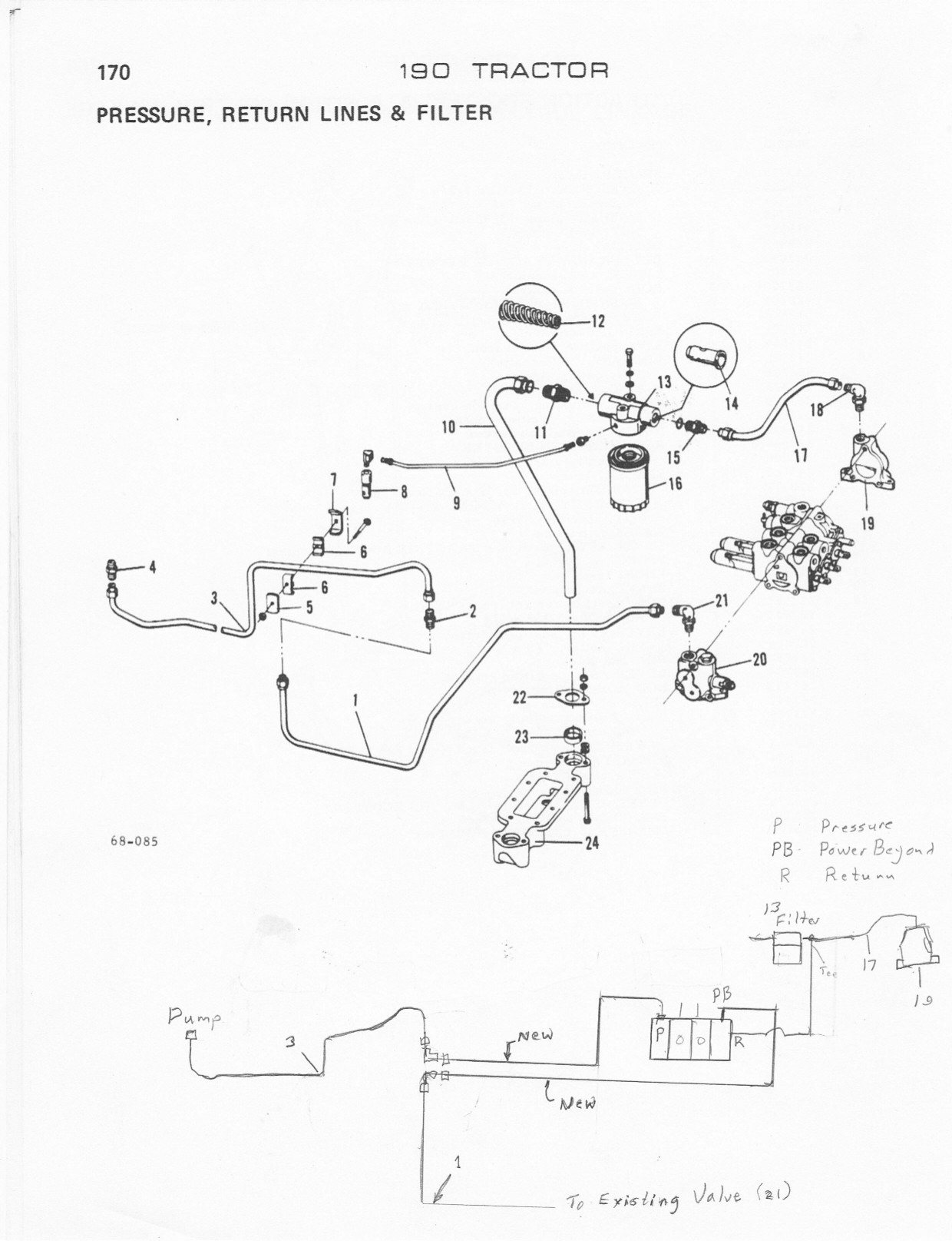

Post Options Post Options   Thanks (0) Thanks(0)   Quote Joe(TX) Quote  Post ReplyReply Direct Link To This Post Posted: 17 Aug 2018 at 8:28pm
Here is a sketch I posted for a 190. The 185 should be similar.

Post Options Post Options   Thanks (0) Thanks(0)   Quote Joe(TX) Quote  Post ReplyReply Direct Link To This Post Posted: 27 Dec 2022 at 2:22pm
You need the power beyond sleeve that goes in the T or return port. That goes to the inlet of the next valve. There should be another return port that is plugged. That is where the new return goes.
Your valve should look like there.

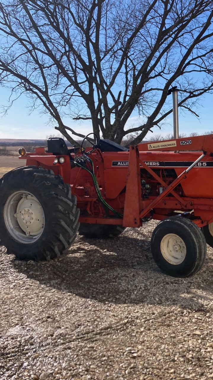

Post Options Post Options   Thanks (0) Thanks(0)   Quote 185turbo Quote  Post ReplyReply Direct Link To This Post Posted: 29 Dec 2022 at 10:45pm
Got the joystick hooked up and plumbed in , pretty slick
