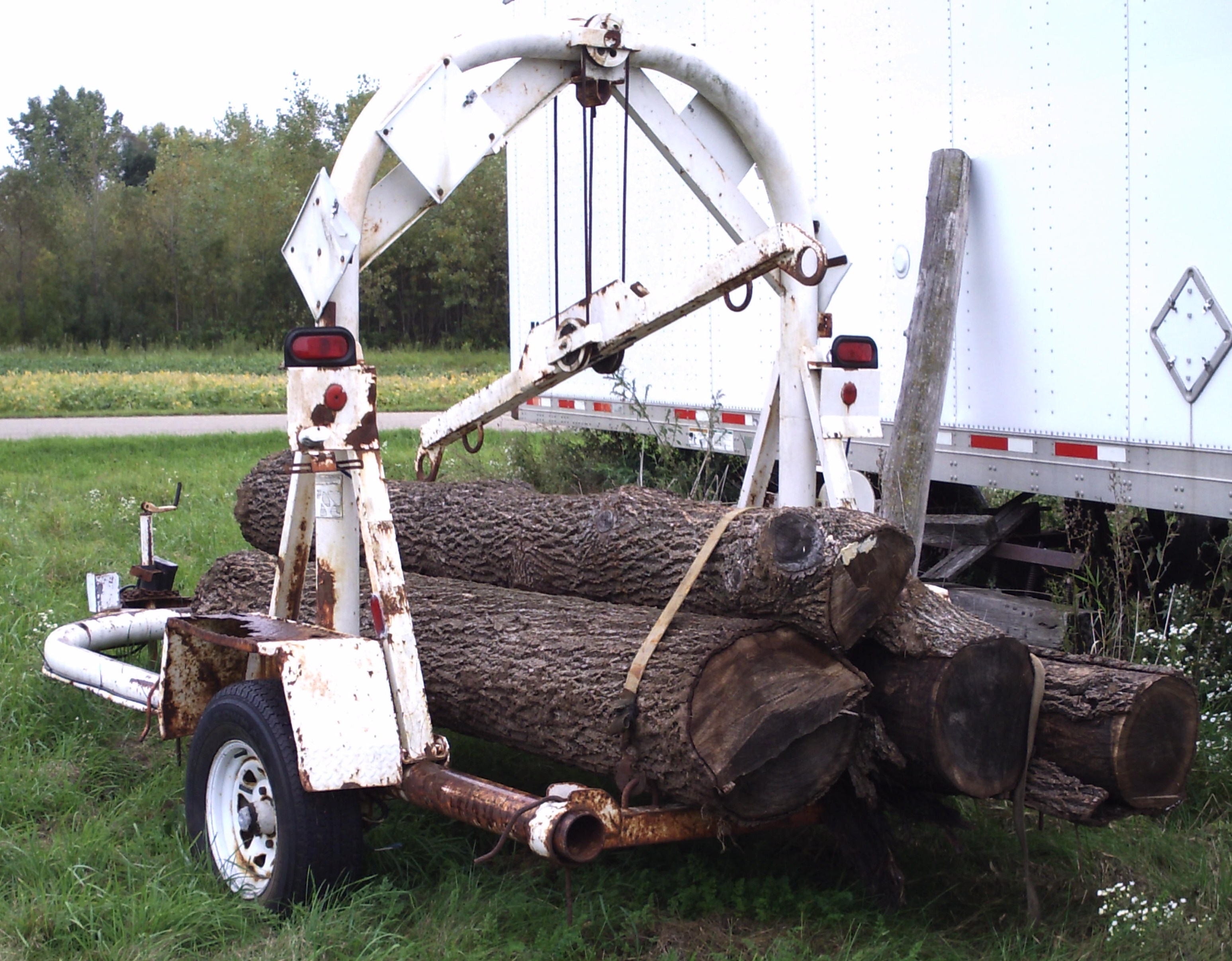

I wonder if an old propane tank hauler would work?
I have used a wagon running gear, put taller stakes on sides if needed.

I use an old Brindle propane tank trailer

Post Options Post Options   Thanks (0) Thanks(0)   Quote HD6GTOM Quote  Post ReplyReply Direct Link To This Post Posted: 25 Feb 2021 at 10:29pm
I hauled a lot of lp tanks on one of them. It gets a bit harry with a 1/2 full thousand gallon tank on them. Only did it once, was a repo situation.
