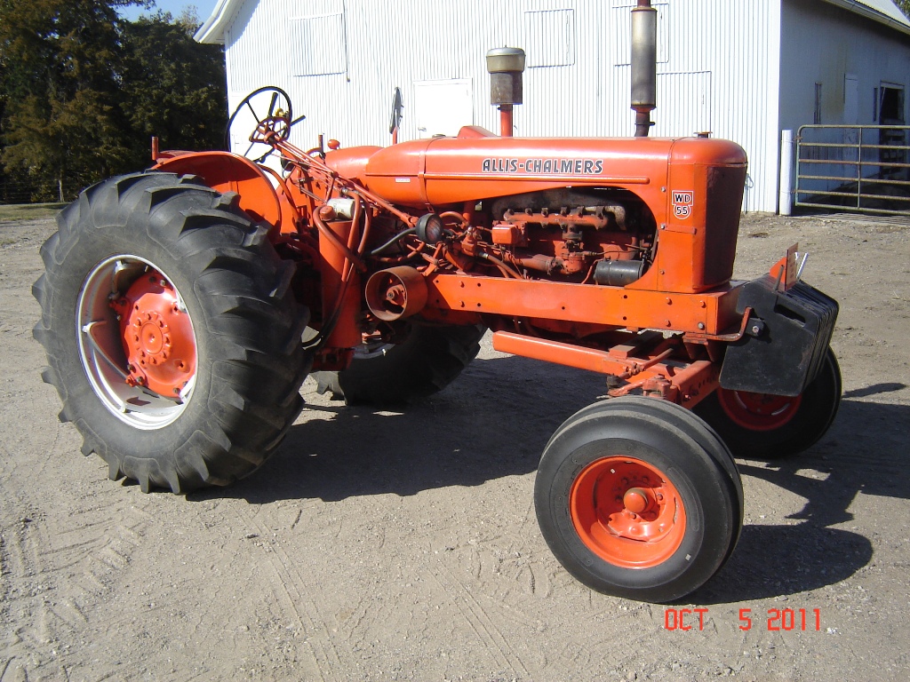

Here is one I saw at Hutchinson last summer.
Ray W.

HEY RAYw,,,,hMMMMM,,, that sure looks like a small block chevy in that WD45,,,,???

I've got a Chevy 6 cyl in my WD45, Ray them plugs is easy to get at in that one ain't they?

I think the one at Hutch was a Chevy motor. (Not positive).
Shameless, yeah those plugs would be easy to get to. But I think they used at least a couple shoe horns to get that motor in there. LOL

yeah...I see the frame is cut on both sides. mine with the Chevy in it has the frame cut for just the starter, not a very big cut.

There was the same one at the GOTO here this past fall.  It is the same as RLTool posted.  Had a Chevy 327 in it.
