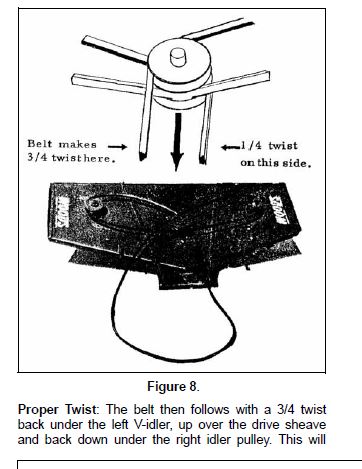

Anyone have a GOOD belt diagram?
CA tractor drive. Of coarse belt decal is worn off on the deck. 🙄

From behind tractor push one end of the belt under rear end towards the deck go over the middle pulley top groove to the pulley on the right from the right pulley go past the center pulley in the center groove to the pulley on the left of the mower from there back around the center pulley bottom groove from there you will have a quarter twist to the idler at the back of the tractor on the right hand side, over large drive fully from PTO then a half a twist back down to front idler at the back of the tractor, back to center pulley with 3/4 twist. Be sure to run the belt fiddle string tight and check it after it's been run for a while if it is a new belt. Sorry I don't have a diagram I can text you a couple of pictures if you'd like to give me your number.

Simon, i have a PDF file that is 2.2 MB in size and covers the  59 and 306 size mowers on the B-C Tractors... If you want a copy, send me  PM with your e-mail address.
