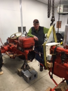

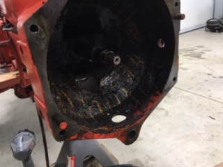

My project is to work on my 1961 D-10 S-II this winter to replace some seals that will hopefully stop some of the leaks.  Going after the rear and front crank seals, clutch was a bit jumpy.  Upon splitting the tractor, I didn't know you could put that much grease in the bell housing.  Purchased the tractor this past summer and started tackling all the different items that need attention after 56 years.
Nothing was rusty.  Must have been 3 pounds of grease.

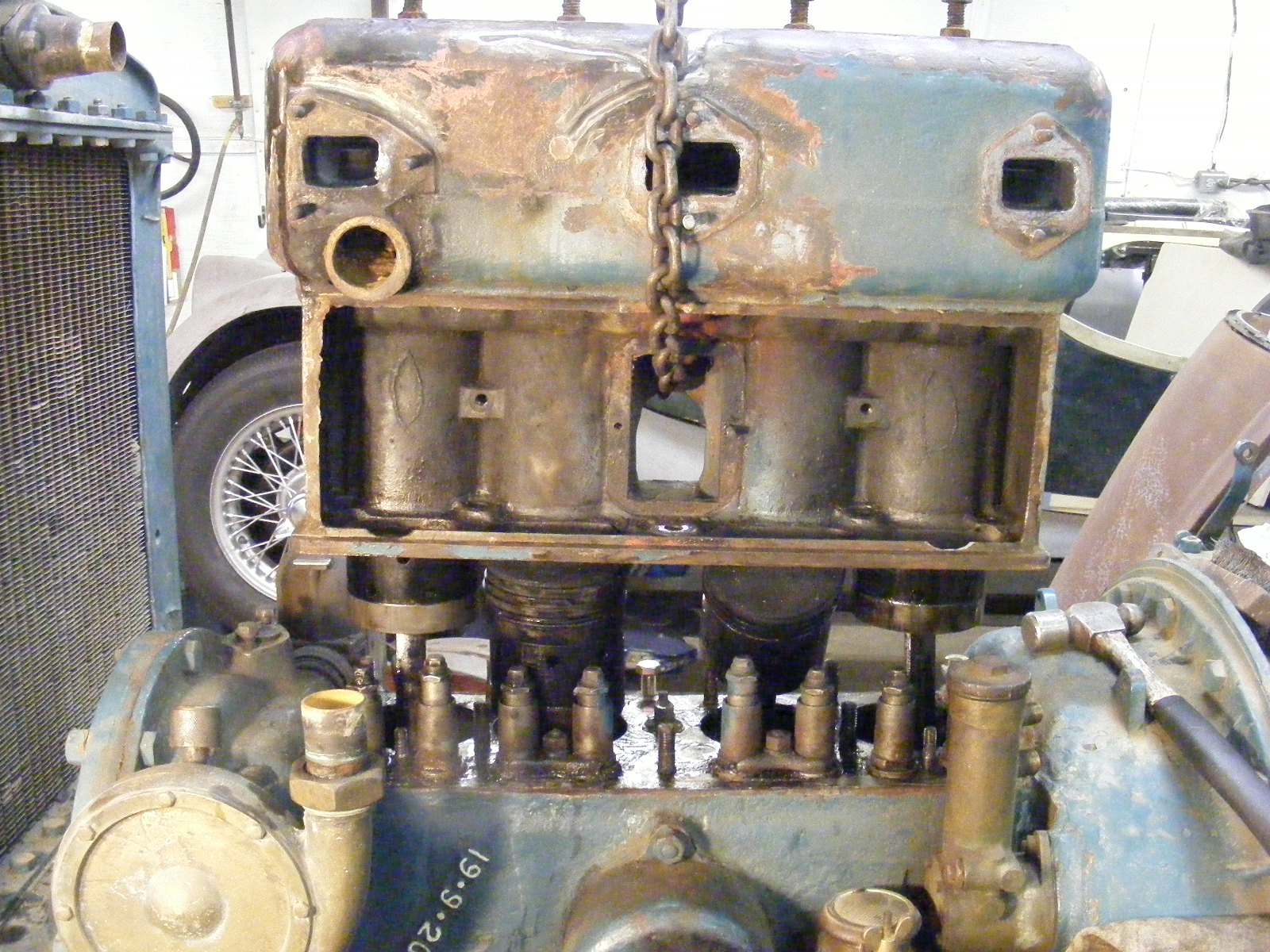

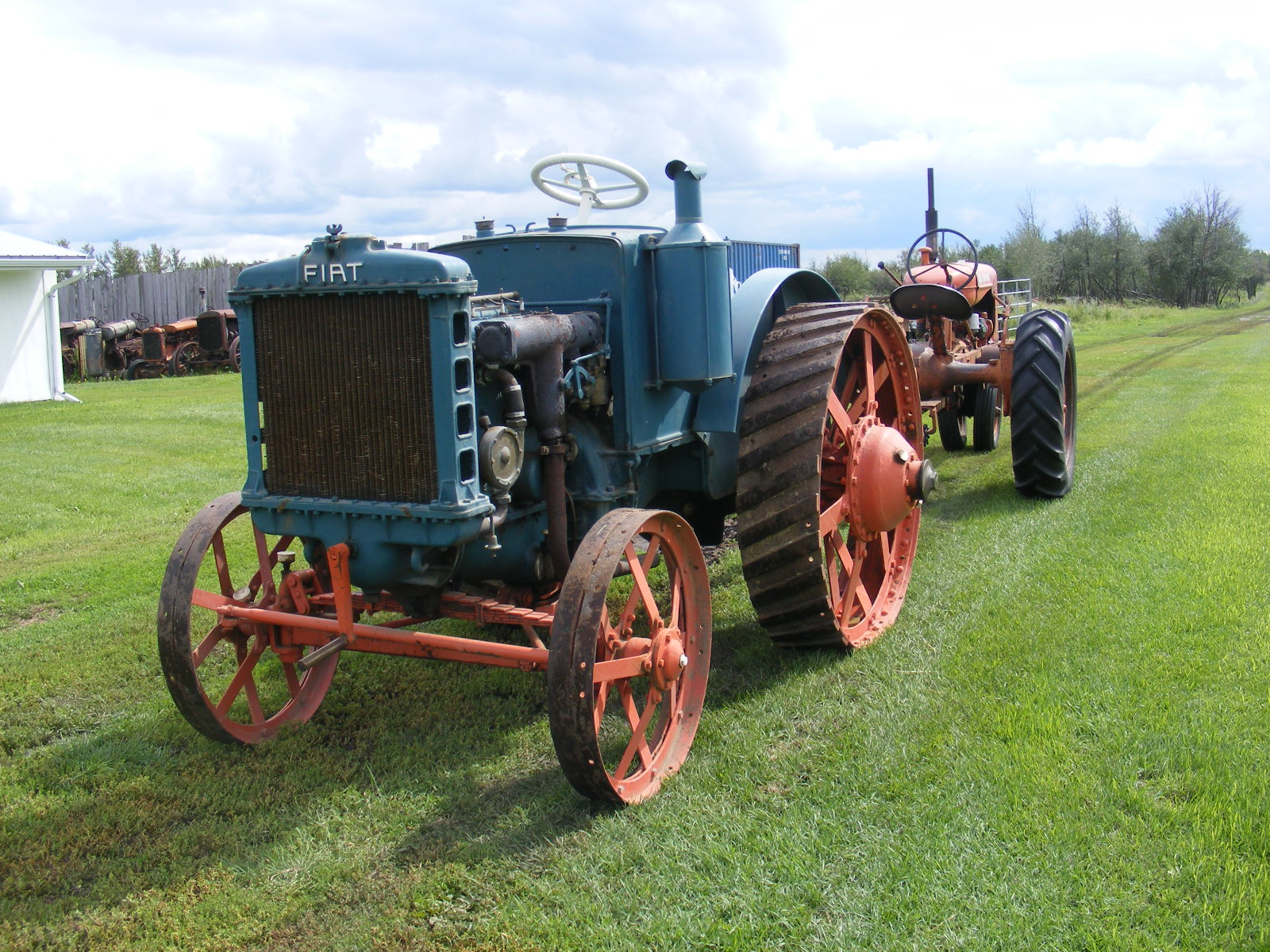

Currently doing customer's '23 Fiat 703.  The headless engine has been froze at some time in the past and the outer water jacket has many cracks.  Ive taken the  cylinder block off and it's at the repair shop for extensive welding.  I've re-fitted the crank bearings to proper clearance and straightened #3 rod.  Just have to make some gaskets and wait for the block to be done.  More customer jobs waiting.
