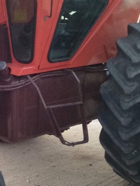

Micheal V,if you look at my first picture you can see the difference in the step compared to the second picture i posted of when mine was new. The mod turns the step forward and out,i posted a photo last year on here, i will try to find it again.

This is the best i can do for now, cut top of rear mounting bracket and lenghten 2 inches,then lenghten bottom stay same amount or more,this with a smaller 14 inch steering wheel makes life abreeze getting in and out.
